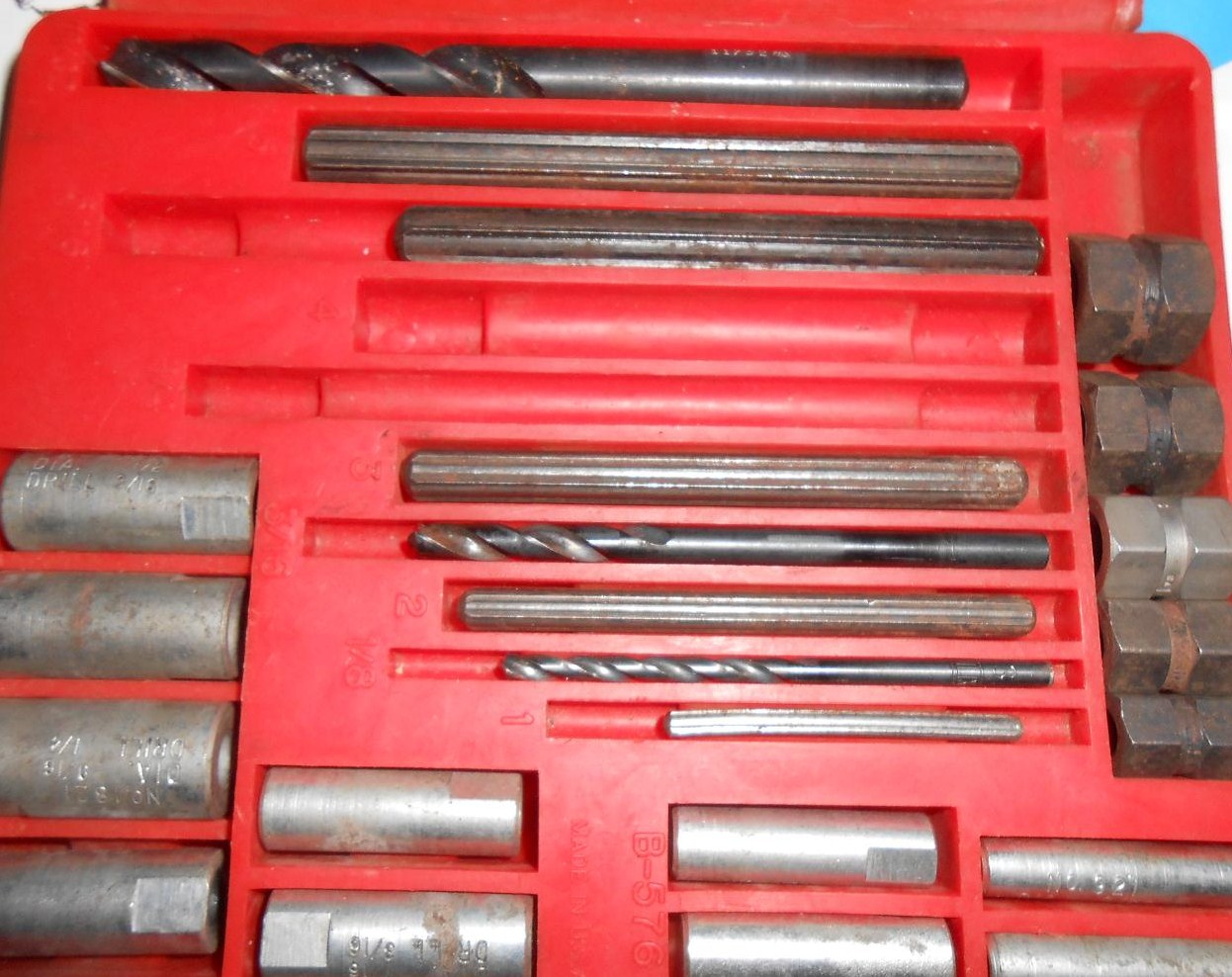

I take it you have someone to do that machining for you ?
(~100 bucks on your end, a set for engine short-block bolts does a whole lot more )
Hi Jacco,
I do my own machining, sorry not a broken screw but broken tap inside... It is a 4-40 hole so it is extremely hard to remove but I still had some grip for a screw, just a little short and cannot put too much force to it. I tried a punch to break the tap pieces by pieces but it was getting too deep for the punch to be effective. Other option is to drill the tap with carbide bit but the tap has to be flush for this to work properly.
Anyways, should be all fine the way it is now?
