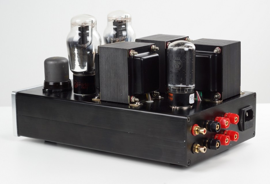

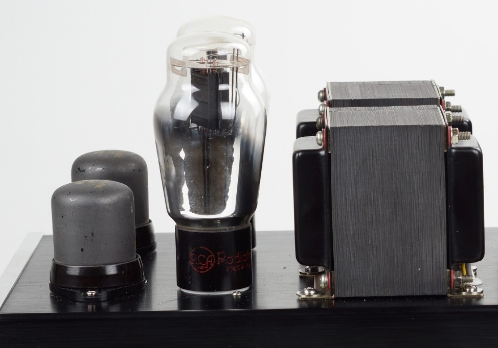

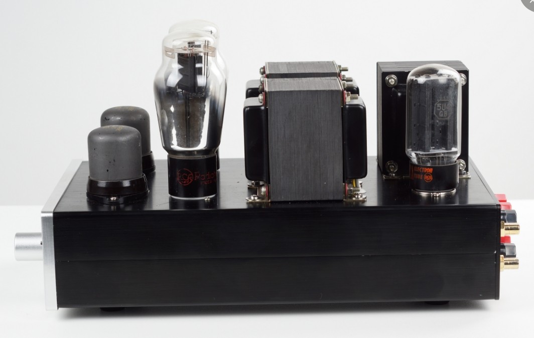

ef12 is a very well-known audio control, beyond the reach of today already. Unlike modern engraved antique pipe tube, you can always produce, its price is also expensive, 58H of the output transformer, so it is also far higher than the 2A3 output 20H cattle around a lot of difficulty. But I still think it is worth it.
Over 65 years-old age fans called "Ma Jingquan" as I made the output transformer. Here I would like to express my deep gratitude to him.

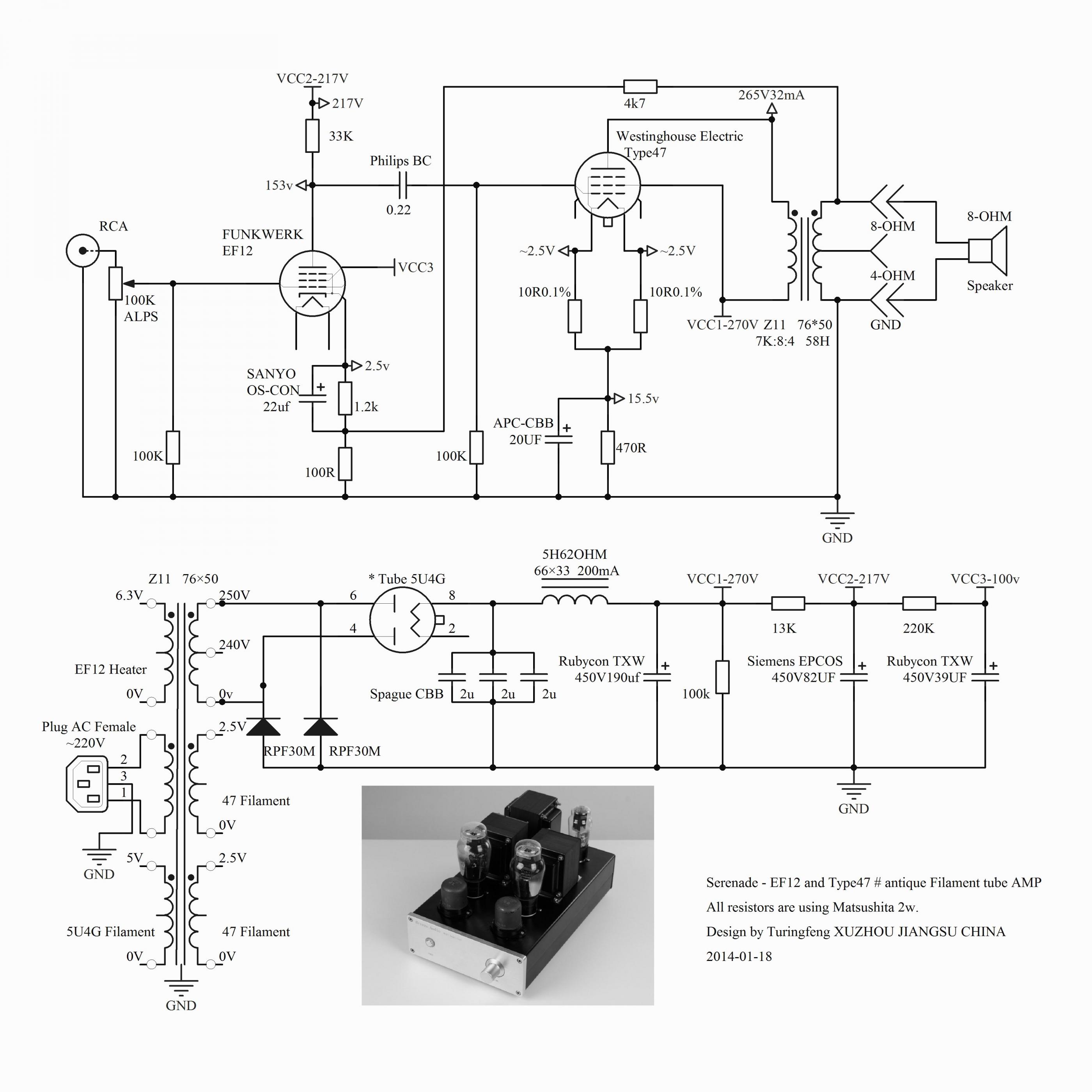

The 47, according to the schematics is a pentode, not a multi diode 🙂
And why use the 2X 10R resistors at the cathode, when there is a centertap on the filament winding on the power transformer?
I see nothing revolutionary about the design of this integrated amplifier. That does not mean it isn't good sounding, but that it is identical to pretty much every other one I have seen in the past few years coming out of China. As to even ordered harmonics, solid state can also be predominantly second ordered. It's entirely about design goals.

EF12 = overpriced EF86 in a metal jacket 🙂

EF12 is a glass enclosure.
google translate misunderstanding caused.
If you do not have that two 10 ohm resistor, you have any good suggestions?
