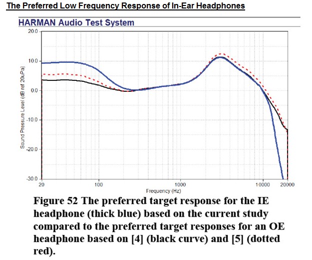

..so close to being "a straight wire with gain" that it makes no audible contribution to the sound.
Our hearing may be a little more complex.
Don't bring headphones into this.
They are very different animals and a flat FR is not at all desirable for them since they bypass the eq function provided by our pinnae.
The ideal curve in your link is the headphone FR that sounds flat to us. You need to look up Head Related Transfer Function.
But again this is 50 year old news.
Yeah, I've noticed.
And yet he brings it up again despite it's age and that it's only application are headphones.
