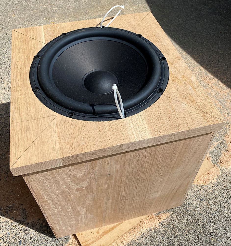

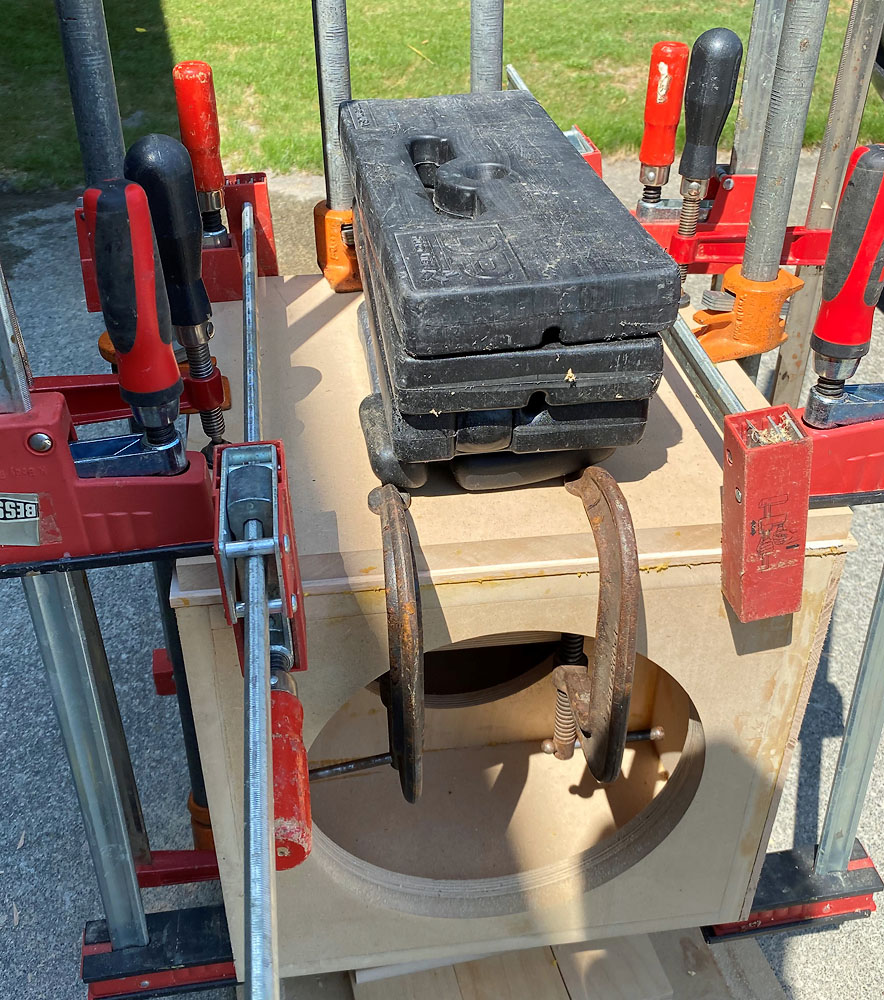

Second enclosure cuts completed and ready for glue.

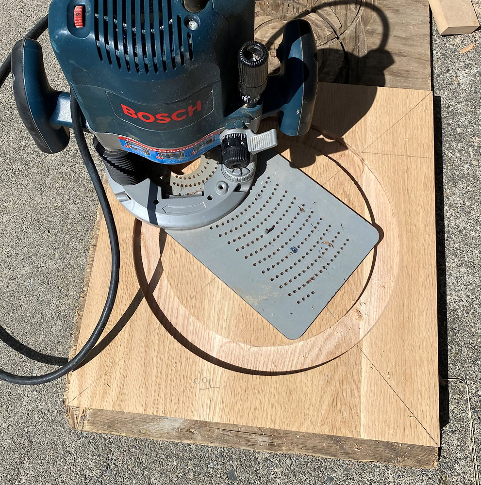

The last side of 1/4 in. x 6 in. red oak is glued and clamped and I finally made it to a hardwood store to pick up some red oak milled boards to make the fascia. They didn't have 1 1/16 in. thick like I used with the other enclosure so I bought some 1 5/16 inch instead.
I would like them to match but no one but me will know unless I put them right next to each other, and I won't. Really nice boards though, it should turn out nice.

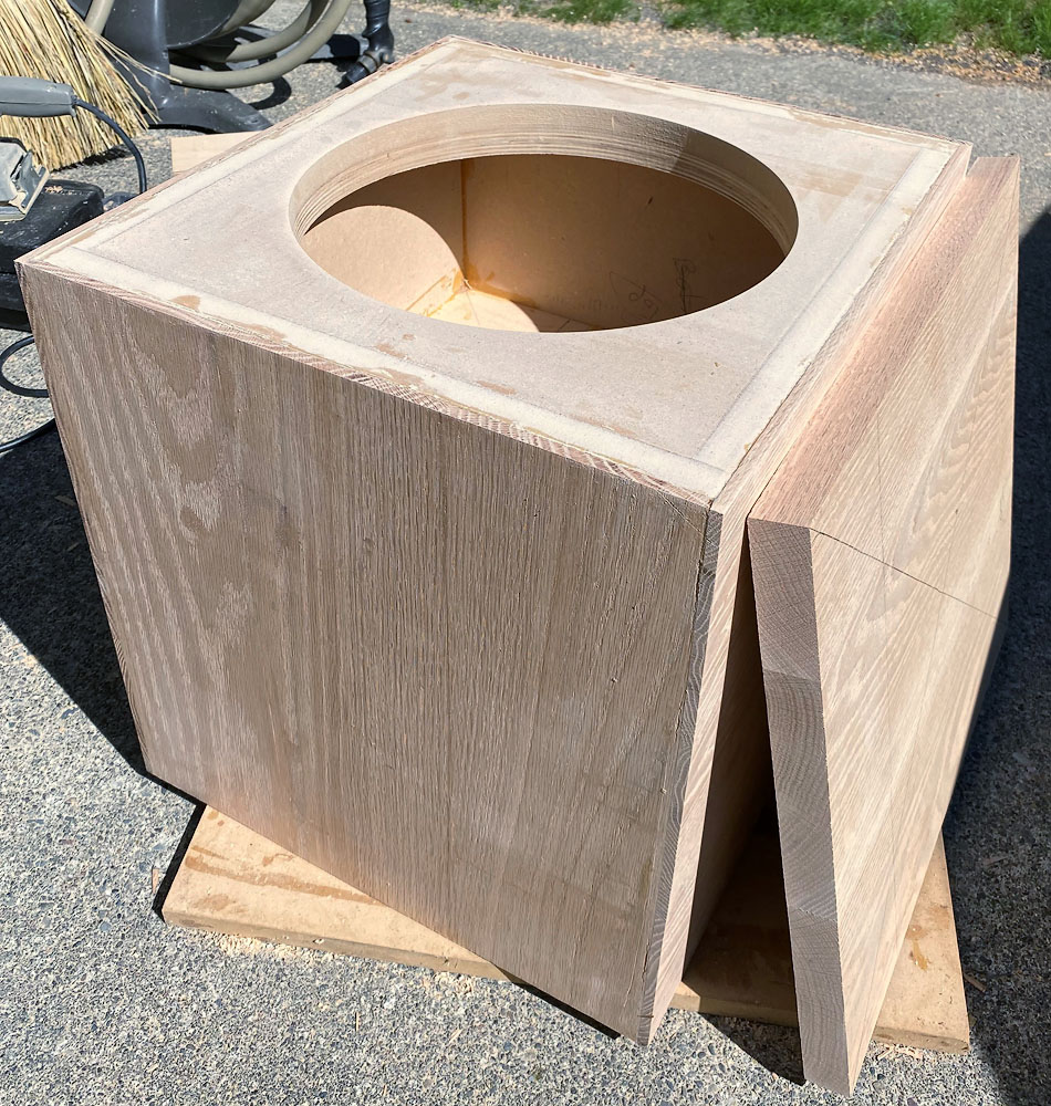

Clamps off, gluing is done. I'll edge trim tomorrow, 1/4 inch round over on the sides and 3/4 inch on the fascia. Next finish sanding, stain, coat, install the drivers and listen to some music.

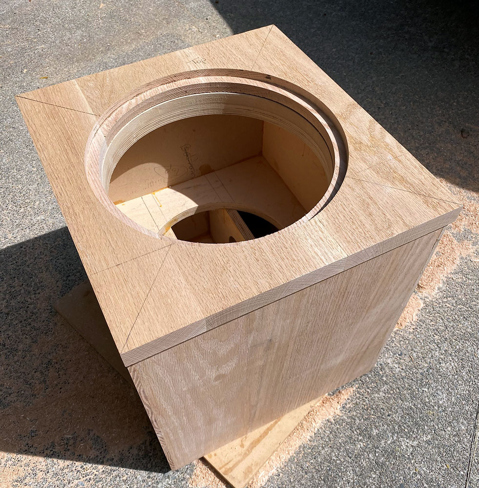

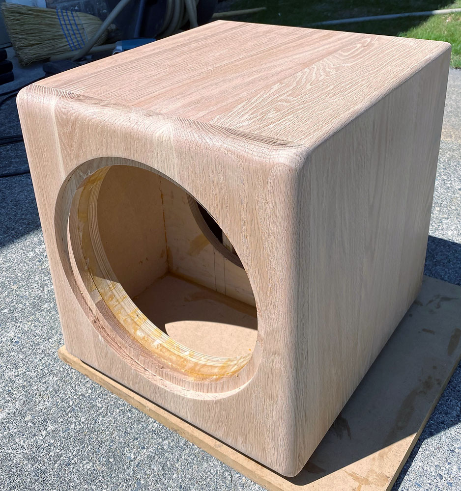

I had stained them but hadn't done a good enough sanding job and they turned out with a few blotches and noticeable scratches. I sanded them back down and re-applied the stain.
Much better result. The harsh direct sun accentuates a golden brown that doesn't show in the house, it looks darker and closer to an ebony stain.
I would have liked to try stopping at 120 grit in order to soak up more stain but I am happy with 180.
I have never worked with DuraSeal Quick Coat Penetrating Finish before. It is a stain but includes filler and doesn't even need a finish coat. I will use one though, just haven't decided what to use yet.
My wife prefers the grain pattern on what I had planned for the bottom so these may be flipped before I install the Neutrik speakON Chassis Mount.
