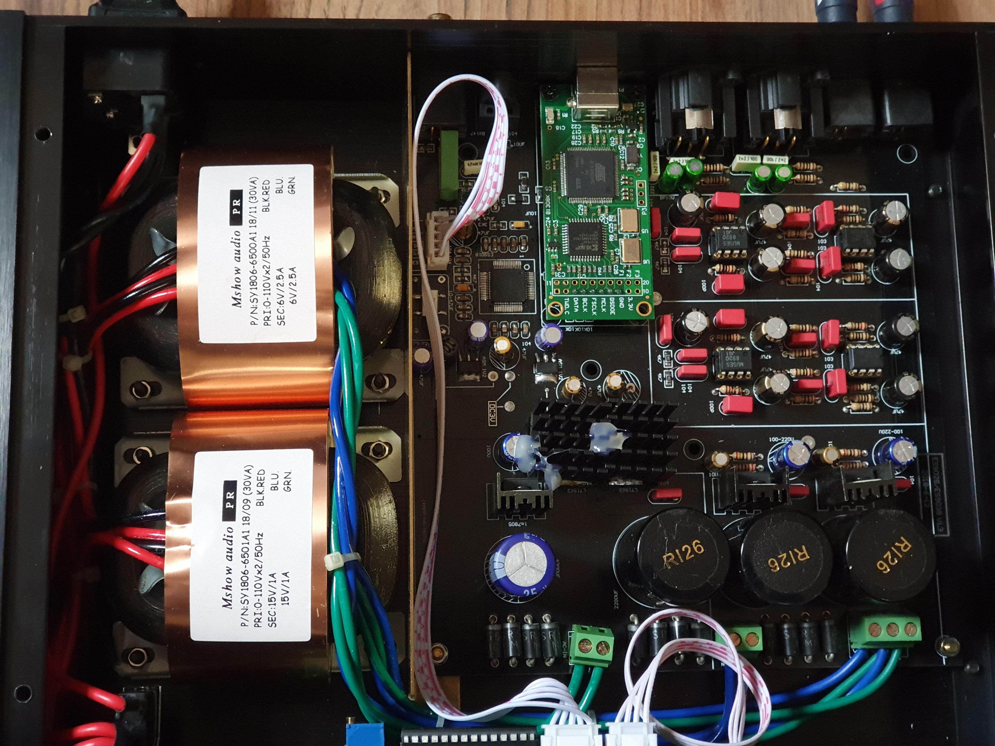

The dac board that you linked to looks like one other people in this part of the forum have already used, modified, and made to sound considerably better. It has a number of problems, most of which can be fixed, but not the mono-AVCC voltage regulator output routing to the dac chip.

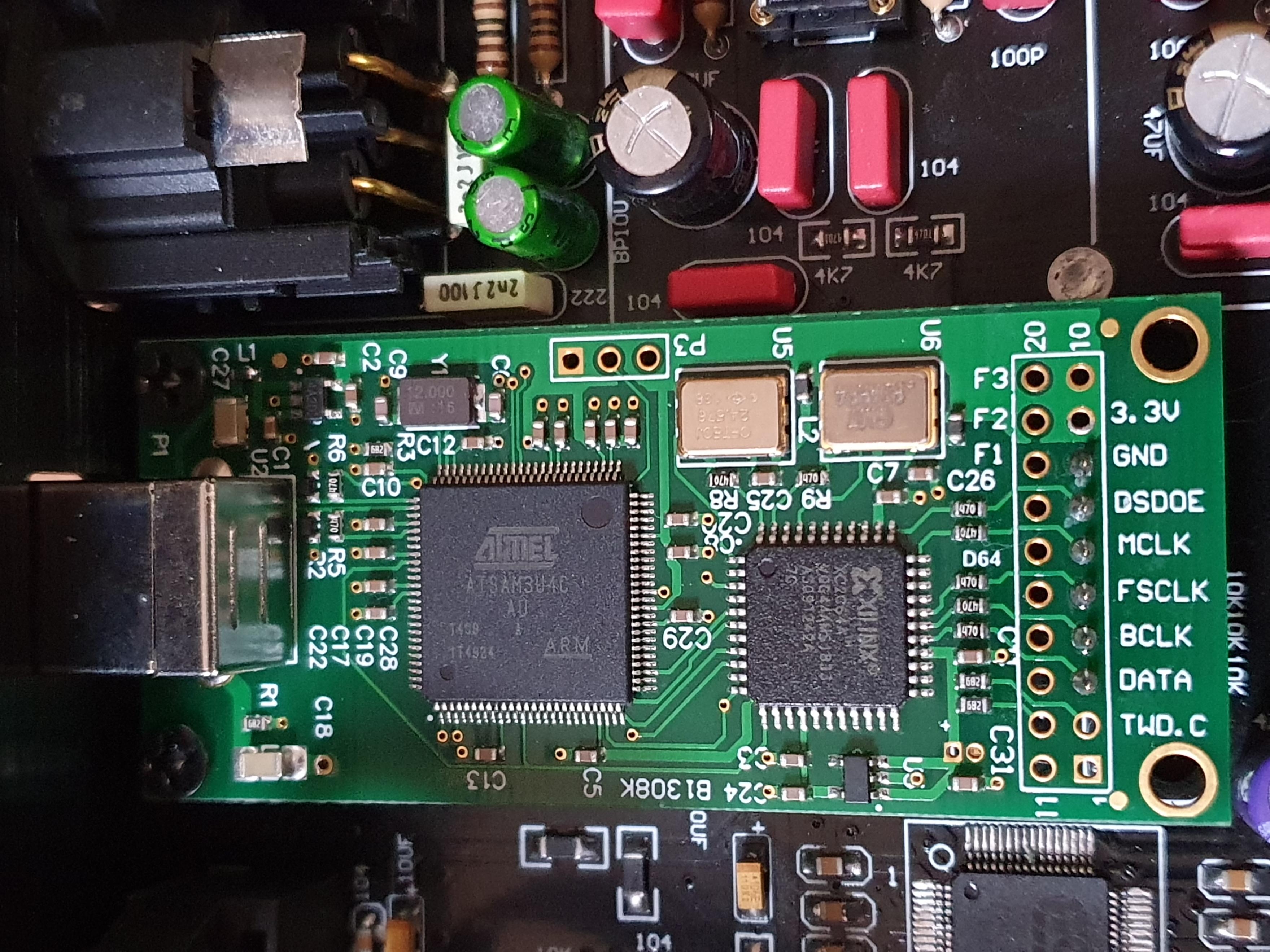

Thanks for this further information.As mentioned previously, I have got my DAC working with Windows 10, after installing the ASIO drivers and can happily get DSD256 and DSD512 playing nicely. However I find my Samsung Tablet (Android) to be much more convenient. This poses problems too in that I need to use a powered USB hub as obviously the tablet only has one USB port. But using the installed UAPP on the tablet, I can only get up to DSD128 to play. After reading the attached pdf file (downloaded from Amanero's website) I believe that my experience fits the specs.
For more information regarding my DAC, I'm attaching a pic of my Card and a pic of the DAC itself.
Can you advise from examining these attachments whether or not my Amanero Combo384 is fake or not please? And any further thoughts about this DAC? Thanks

Regarding DSD512 on Amanero, try flashing:
CPLD Firmware Selection "Slave_for_1080"
CPU Firmware Selection "DSD512x48x44"
Please see the Amanero firmware page: Amanero Technologies
EDIT: The Chinese clones look very similar to the real thing, although build quality is visibly better for the real ones. One difference I noticed is that the component marked L1 on the board should be a ferrite bead. On clones L1 usually appears to be a resistor.
Real Amanero boards are only sold directly from the Amanero website or from a small number of distributors: Amanero Technologies Normal price is around $100 USD. If bought from ebay seller for $35 then very likely a clone.
