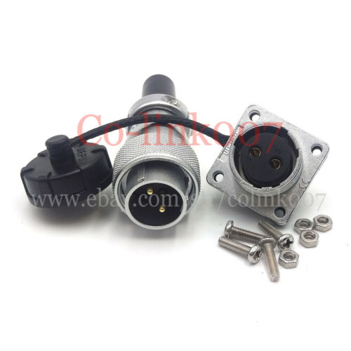

It is definitely not ideal, but occasionally I read some of you do this. What do you use for the connection between them. The easiest option I came across is the MC4 connectors meant for solar panel. They are rated from 1500V DC 30A. I wonder if anyone have experience using them?

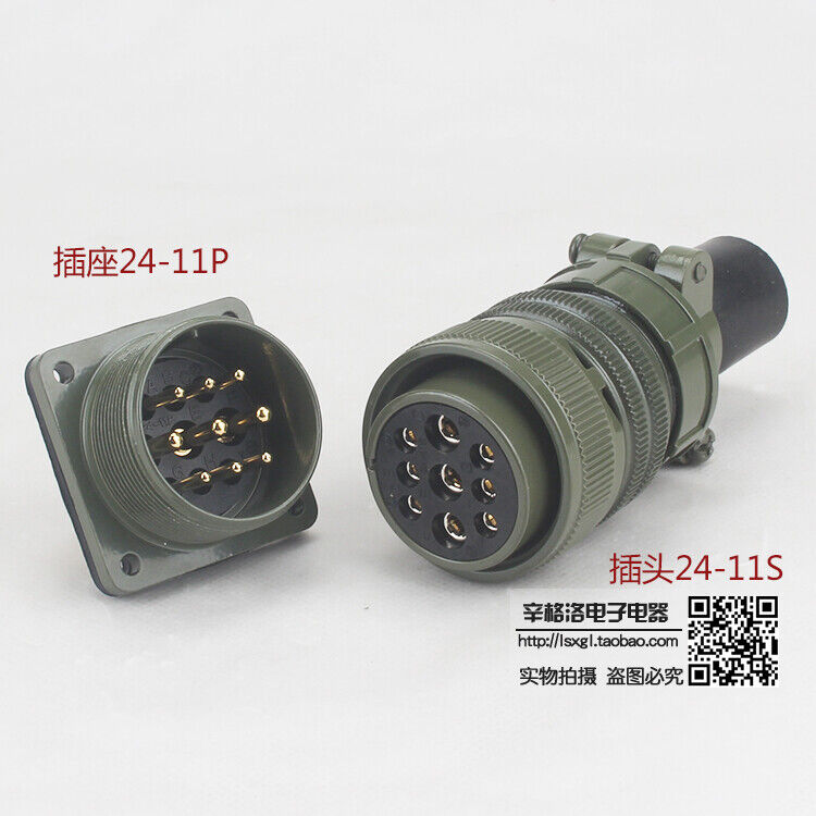

I have used, and prefer MS style connectors. They're rugged, reliable and have interchangeable inserts. I like at least a size 18 (middle number) which is about one inch in diameter. If more then four or five pins a larger size is better so you can double up on pins for filaments, assuming you have a large enough chassis. Yea, they're somewhat expensive but if you search around they do show up like the one shown.
Pictured is a size 24 that's around 1½ dia. (The last number represents the "pin configuration" and not the actual number of pins.)

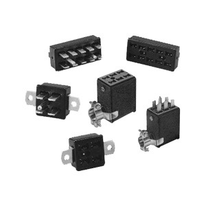

I've also used Cinch Jones connectors. They are cheaper and perhaps easier to find from supply houses and sellers on line. The only down side is that they can pull apart more readily. Although they can be bought with locking clamps that prevents that. You should always orient any connectors with the pins on receiving side and the socket on source side so voltages are shielded when not connected.

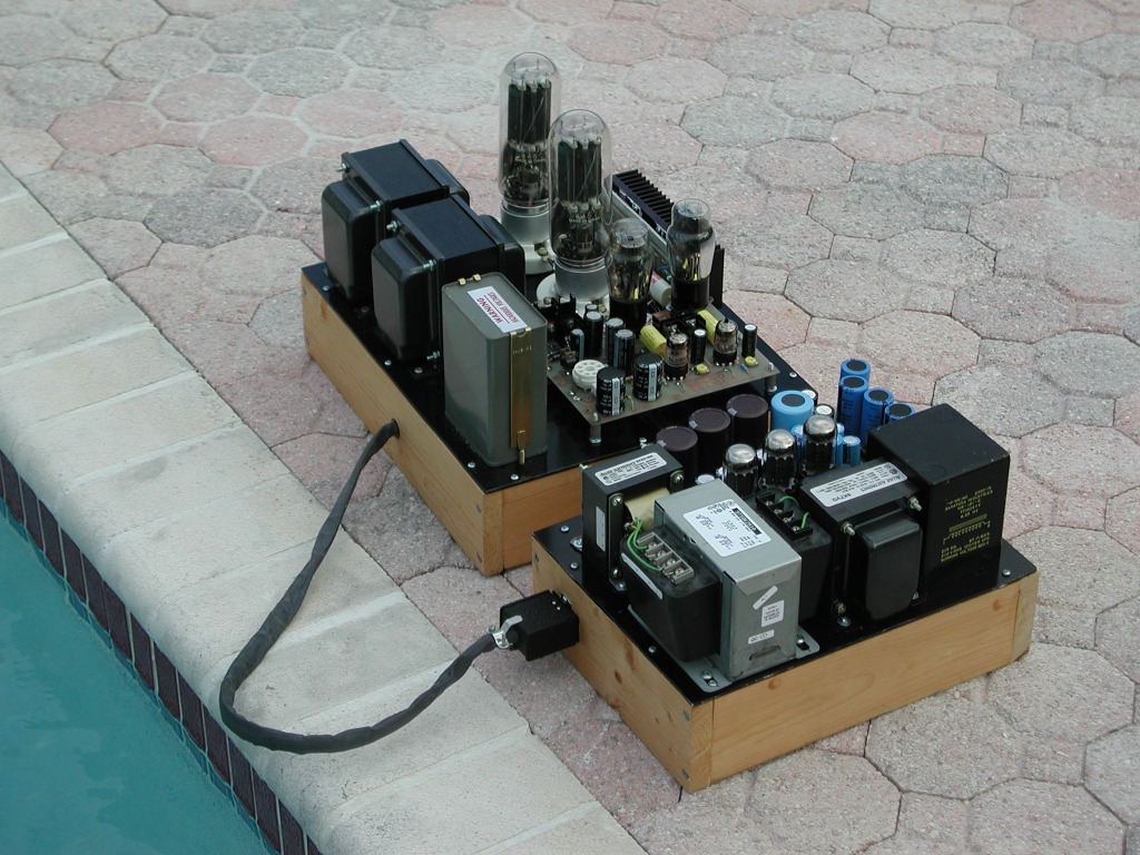

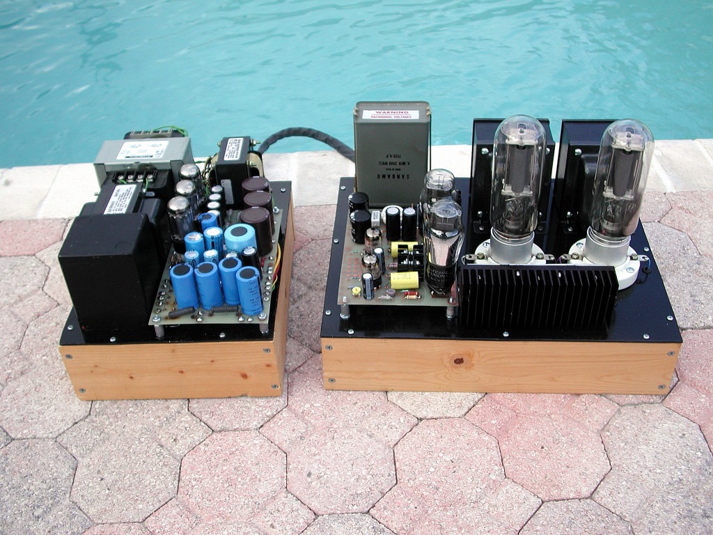

I have used the Cinch Jones connectors seen in the second picture from post #2 in my dual chassis designs. I put the positive HV connection in a corner pin and left the two adjacent pins unconnected. My amp runs at 1050 volts when operational and well over 1100 when unloaded. The amp has existed for almost 20 years but does not see use today due to curious grandkids and exposed tube sockets for the 845 tubes.
