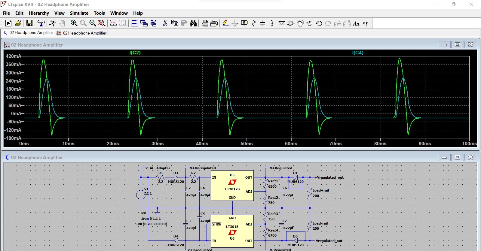

Indeed... that is a really good suggestion actually. I'm sure this is a prime reason for failure of a lot of small caps in equipment, typically in voltage doublers and such like that you often see in VFD's (vacuum fluorescent display).

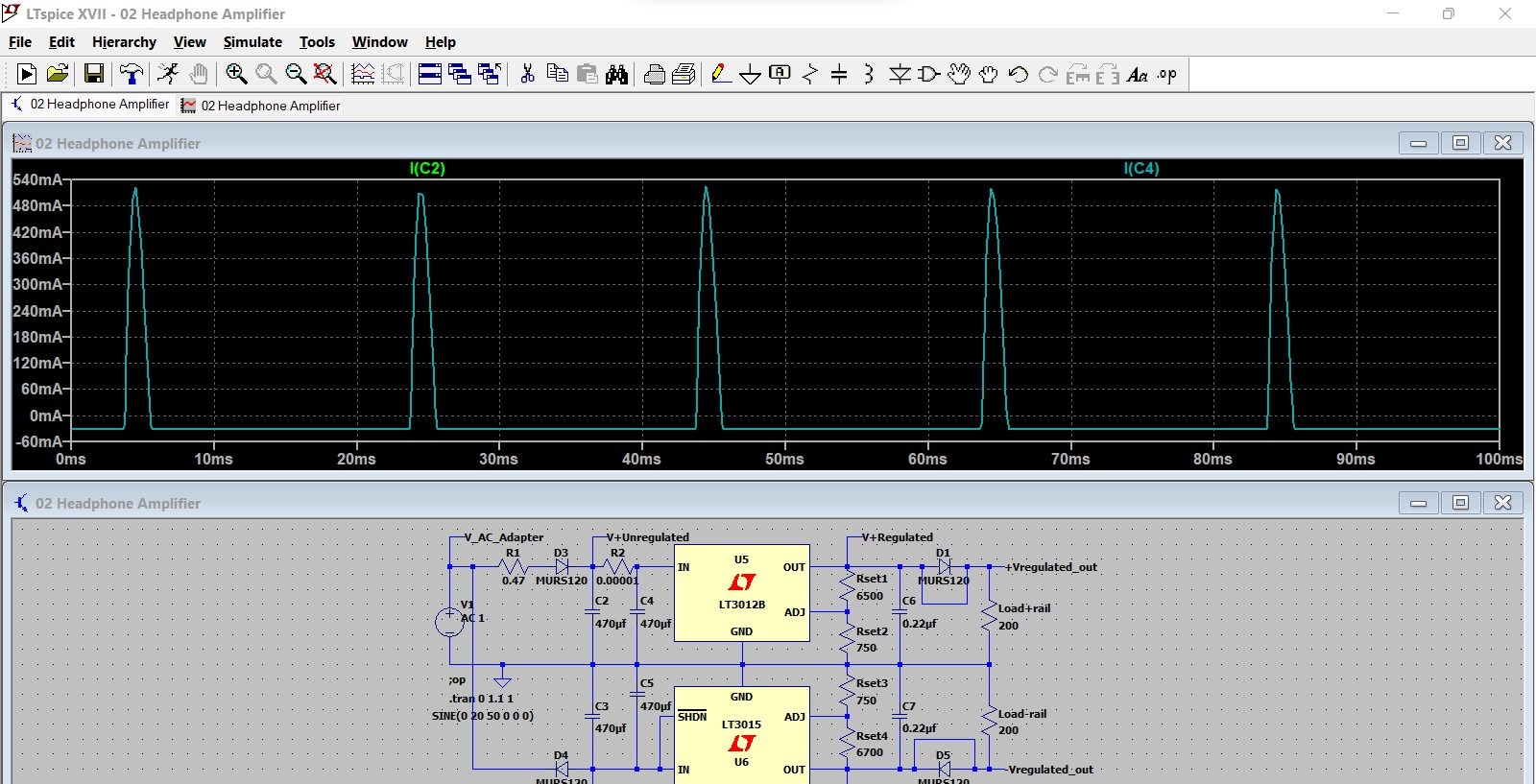

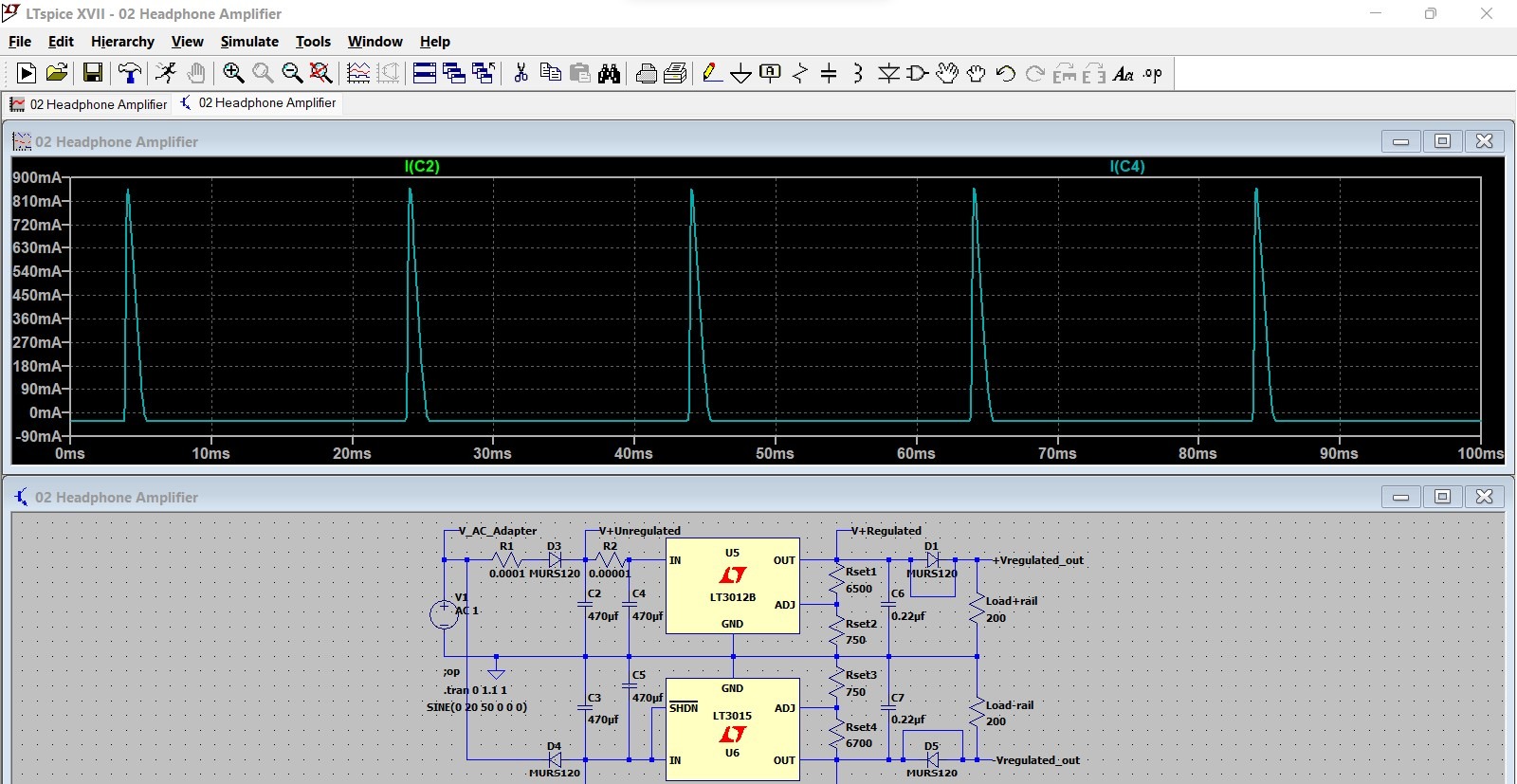

Here is no resistor, then your 0.47 ohm and then two 2.2 ohms with one separating the caps. At the load current here the regulator still sees over 16.5 volts on the trough of the ripple.
