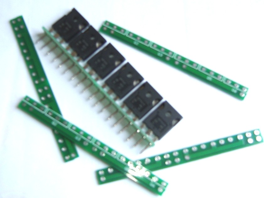

During the course of panellising my amplifier board artwork for production, I am often left with narrow slivers of waste space, I pay for. So I devised these long narrow extender boards for mounting 2 sets of 3 IRFP MOSFETS or anything in the same package. The drains and sources are paralleled to suit matched devices and they are all through hole plated and solder masked both sides. They have the correct 5.5mm pin spacing.
To neaten up your project - or add HD output stage.
They're free to anyone interested (MOSFETs not included) - max 4!
See Pic -

The gates are not connected to anything but there is a thin track to solder 1/2W resistors from the pad to common track. There just wasn't any room to provide for the AXIAL0.4 R's.. It's just to tidy up extensions of power stages. 3 pair.
Another thread a while back we discussed boosting the SKA for low Z loads with a conventional SF output stage by replacing the output fuses with 100R and driving 3 pair MOSFETS. It was about this time when I did the PCB but have never taken it further.
