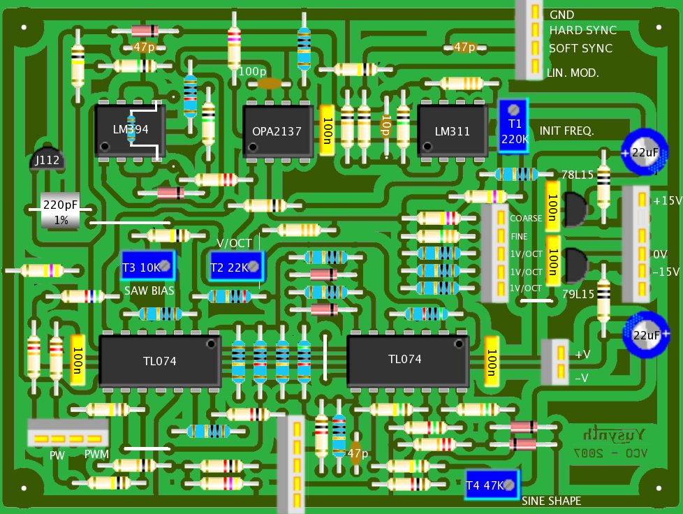

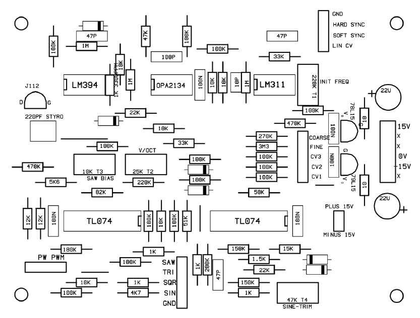

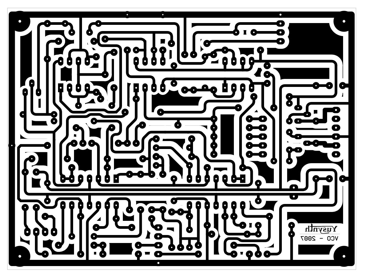

I would like this Schematic on Express PCB.
I tried the Laser printer method. I also attempted to
redo it with express PCB but gave up after 4 hours.
It was my first attemp with Express PCB. I would be will to pay.
Otherwise I would really appreciate some tips. Press and Peel?
More time with Express PCB?

I'm not sure what schematic you are referring too because you didn't attach anything. Attach a schematic.

For a one off, make a real good black same size photocopy on transparency paper or "vellum" (architect's semi transparent drafting paper, check at an architect's supply shop or a good art store) and use it to expose *positive* coated photo sensitive PCB material.
Very Pro looking results.
Or straight print onto same papers with a good , fresh toner Laser.
Practice first on small 1.5"square pieces until you get the exact exposure, timing, etc.
Probably 3 or 4 tries for perfect results.
By the way, you can leave the developed (blue or green) emulsion on the PCB, it will protect copper from corrosion and solder melts it away, so it does double work as soldering flux.
I silkscreen my own but it only pays for 20-up batches, so for small prototypes (say, an active Bass Preamp for a friend) I go straight to the photo etch material.
