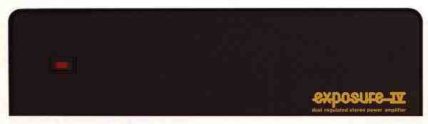

Yes but it is dual IV Exposure Amplifier

I receive this email reply today with repair hints from Exposure:
Hello, I am looking for a download portal, where are to find service manuals and schematics of all legacy and currently amplifier (both integrated and power amplifier). In the moment I want to make service on my model "XV" Thank you for sending of the appropriate navigation hints.. Best regards Andreas Kirschner
Dear Andreas
there are no service manuals or circuit diagrams available. below is the general repair advice for repairing X, XV etc
Many parts can blow up if the output stage goes so you need to check ALL the power transistors on the heat sink ( the middle 2 are for the regulator) You also need to check the drivers ( ZTX452, ZTX552) The emitter resistors, any burnt parts of course.
You also need to check the ZTX452 & ZTX552 near to the 2 presets as well as the 2x 33V zeners nearby. When powering back on use a variac and slowly wind it up and check the voltages at the same time. The output offset should be less than 50mV and the bias about 1.4mV across each emitter resistor. The regulated voltage as measured on the middle 2 power transistor cans should be around +/-33V with a full supply but do not apply this until sure or it will blow up again. You should also have a 1KHz signal on each channel and scope the speaker outputs to ensure all is well as you wind up the variac. there should not be any hum and the sine wave will be more of a square wave until the supply is near full
best regards Tony Brady
This means an analysis of the circuit design and thus the re-creating of the schematic diagram is essential for a perfect service.
Did you figure out the schematic for your xv?
there is another thread with a IV schematic, as per the old request that started this thread (in 2004!). It is very similar to the XV power amp stage as far as I can tell, although the shared schematic does have a couple of errors as far as I can tell. The later amps appear to have driver transistor emitter diodes added but that’s the only obvious difference (the later integrated amps have the zener regulator circuit add to the power supply too, as mentioned by Exposure email)
