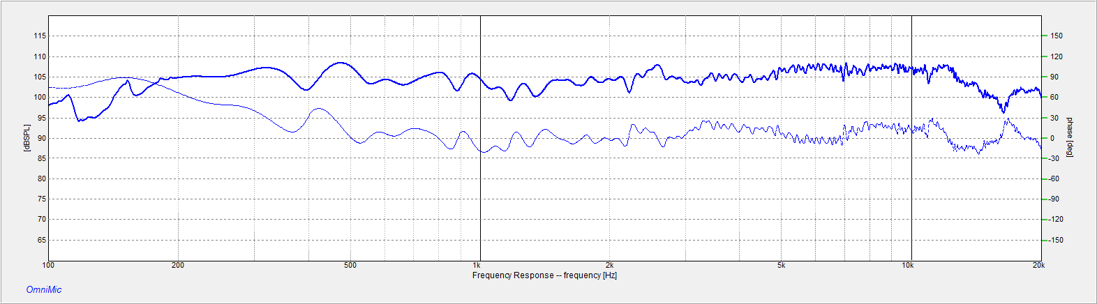

This response was done with a speaker (my old "CoSynes") that has the tweeter phase inverted.
All speaker drivers are highpass or bandpass, and physical delay and all-pass networks can make them behave in limited frequency ranges as if there were another inversion. If we used a response down to DC then absolute wireing polarity might be required. And of course an FIR equalizer can do pretty much anything.

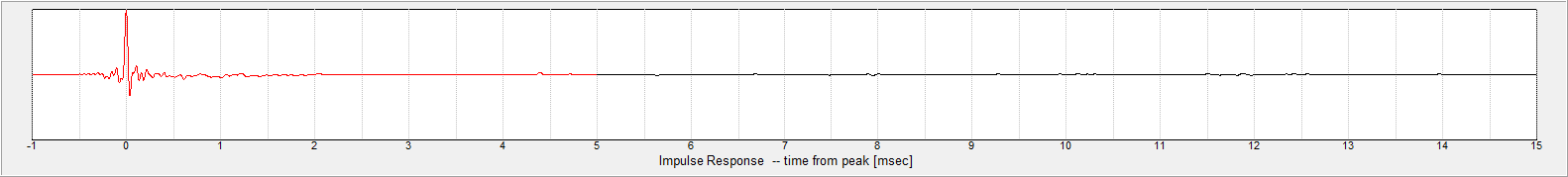

The first is what I know as "time co-incident." That is, the starting edge of all drivers is in the same place in time. As Bill Waslo points out often, it only works in 1 point in space unless you are using a co-axial speaker. Move vertically off axis and it's gone.
Look at the impulse of this Vandersteen model seven which is time-coincident. All three drivers start at the same time and create a single triangular impulse:
Vs. this one from a Monitor Audio Platinum II which is not (but still a very good speaker). You can see the three drivers start at different times and they do not create a single impulse.
The tweeter starts downwards and ahead of the midrange, which is also going downwards, followed finally by the positive large, broad and slow woofer:
Also please note that having a stepped baffle is no guarantee of time-coincident but it is often required.
Using a stepped baffle can solve issues around number of crossover poles used to achieve perfect phase alignment (not the same thing, any commercial speaker should have good phase alignment) but is no guarantee of a coincident leading edge.

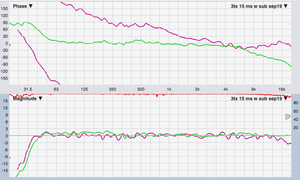

How are time/impulse aligned and linear phase accomplished in the same loudspeaker?
Hi Art, here's my FWIW take.....
Time aligned means drivers' phase traces lay on top of each other, though the frequencies of acoustic summation (xover region), which makes for a smooth flowing combined trace.
The traces don't have to be flat to have time alignment, in fact traces are seldom ever flat unless they are also ....
......Linear phase ...which means just that, the phase traces are lines, most often thought of as horizontal.
When phase traces overlap (whether linear or not), the initial rise of any frequency's wave within the xover region, occurs at the same time for both drivers, ........but only on an individual frequency by freq basis.
IMO, this equals time alignment as is commonly thought of.
This is not to say all frequencies within the xover region have the same initial rise time. If that were the case then you have the added the condition of linear phase.
This is what what makes linear phase so desirable....... not only are drivers time aligned frequency by freq through their handshake region, but also ALL frequencies in the handshake share the same initial rise time.
And if linear phase extends past handshakes and though all the drivers responses, then all frequencies low to high are timed together with the same initial rise time, and a rare time coherency has occurred.
Below are 2 examples of the same 4-way system, with a sloped phase and a linear phase, trying to picture the above statements:
The purple trace is time aligned fairly well, because there is pretty decent continuity in the overall phase trace.
Whereas the green trace is both time-aligned and linear phase.
(Pls ignore phase slope beyond 6kHz.. a little wind makes mic move enough to float phase tail up and down)
Again, all FWIW.

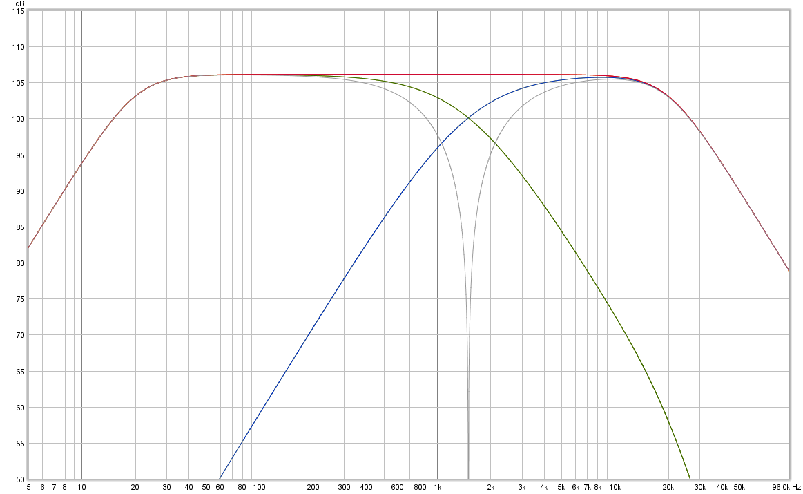

Linear phase EQ is not something that occurs in nature.
However, with FIR digital filters is possible to do. How? By passing the signal forward and backwards in time, so phase shifts cancel out.
For example, there is a way to pretty much the same thing with a tape recorder and some time. Take a signal and record it to tape while applying half of the desired EQ magnitude. Then flip the tape over so that it plays backwards in through the tape machine, then play it back and apply the other half of the EQ. Phase shifts cancel out since if phase shift was lagging on the first pass, on the second backwards pass it will be leading, and thus on the second EQ pass, the net total EQ has been applied with no resulting phase shift due to the cancellation.
In a digital FIR filter the same type of thing can be done, but just as with using a physical tape machine some latency is added due to the processing backwards and forward through time.
For loudspeaker crossovers, depending on the cross over filter types and processing latency, the signals for different drivers may now be out of time with each other. That can be fixed by delaying the signal that is most ahead in time so that it matches the timing of the other signal. Now the signals are time aligned.
