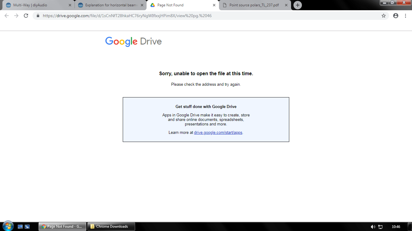

Your attachment is incorrect, a curvilinear profile means just that, curved. ;)
Small problem here with the curvilinear page. I shall, of course, try a little later, but are you sure it's working ?
JBL went solo ... mimic'd the performance of W.E./Altec's curvilinear cone, so created a ribbed conical diaphragm that flexed ...see attached, scroll down to 15".
So you say that the ribs still permit flexing of the cone and JBL's curvilinear (shallow according to Altec) doesn't do much to the beamwidth beyond what it originally is.
Has JBL fundamentally changed their woofer design? No clue, but history has shown that manufacturers don't 'fix what ain't broke' unless it's a true improvement in performance/cost ratio, hence my 'biflex' assumption, another of the pioneer's proven designs still used nowadays, i.e. this appears to me to be a driver that flexes the flexed. ;)
Yes and BTW, even I'm alright with the bi-flex thing.
