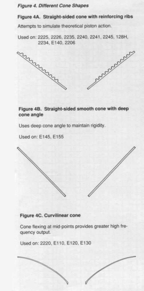

Seems like the 15" cone does not move in it's whole at higher frequncy, but only in the middle. So at 1000Hz you may only have a virtual 8" speaker.

Even Turbowatch (post #2) may have had a valid point regarding the possibility of cone flexing.

Having only seen the pictures, the woofers appear to be bi-flex in nature, so could explain a lot.
A typical 15" has breakup modes below 2kHz. This wouldn't only create some degree of inconsistency, but less ideal conformance with that chart. Lobing from the single driver could typically be a part of this.
Ok, so a little more is squeezed out of the woofers, but just enough to approximately match the horn's beamwidth, resulting in a low-cost budget speaker. However, (like AllenB said) the given overall beamwidth, still 'looks' very promising.This speaker like all the other 2-way speakers is a compromise.
And that 'little more' is possibly due to a curvilinear cone that flexes for the higher frequencies, also mentioned by Turbo in the beginning. I have heard of it before but hadn't considered it, mainly due to the 'ribs' seen on the cones, that are meant to improve rigidity and thereby a achieve 'more pistonic' motion (attachment from JBL Tech Note Vol1, No. 3A).Having only seen the pictures, the woofers appear to be bi-flex in nature, so could explain a lot.
