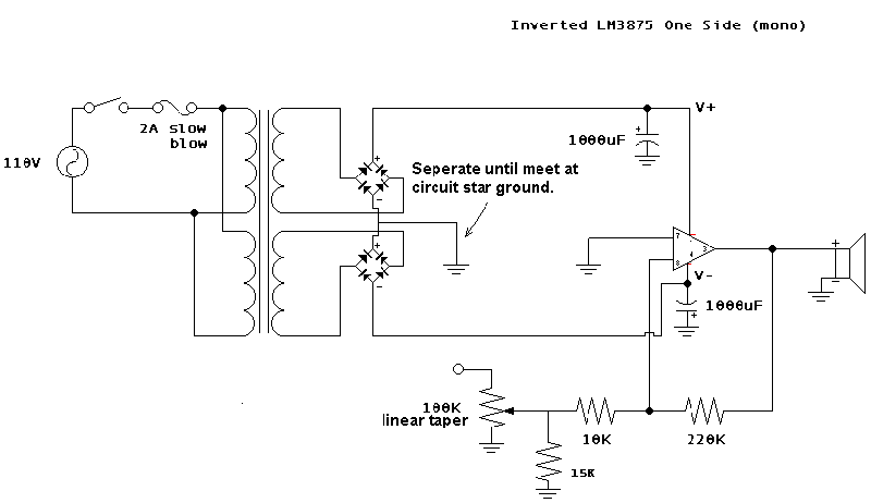

Here is the exact image of what I am using. one for each channel.

Ok. Scratch that anyway. I was thinking at the wrong end of the problem.
If you're truly getting significantly less bass with the speakers wired in opposite polarity, then I can't think of anything being the cause other than one of your amplifier channels being non-inverting, one of the channel outputs being wired opposite the other, or one of your speakers wired in opposite polarity either internally or externally.

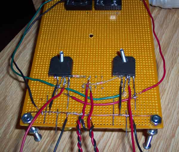

I know that my wiring is correct, here is a pic. I have corrected the problem with the potentiometer (the middle pins sticking through) and the feedback resistor is on the rear side of the PCB. The twisted wires are the RCA inputs, and the straing ones go to the speakers. The caps are on the reverse side of the PCB as well.

Sorry, took a break to whip up some snackage.
PaulHilgeman said:
Hey, I think we might be a bit unclear on the problem here. I'll try again, forgive my poor descriptions.
I'm pretty clear on what the symptoms are.
In Phase with eachother:
-No bass, imaging is decent, not good, just barely decent. I can tell that somthing is wrong for sure though with the mid and trebble.
Out of phase with eachother:
-Bass has more presence, but still not where it is with other amps. Imaging is wacky, and spacy, there is that suckout feeling that you get when you wire them out of phase.
Except that this is a classic symptom of one speaker being wired with the opposite polarity of the other.
-Overall, bass is always better (deeper and louder) with one speaker hooked up.
This doesn't make much sense. Driving both speakers together could load down your power supply considerably more (seeing as you're just using 1,000uF reservoir caps) than driving one speaker, but that would tend to manifest itself by the amplifier's clipping sooner rather than playing louder or softer.
It seems as though I am getting a phase shift in one channel, and I have no idea why.
And I can't see any reason why such a drastic change in phase would take place in the chips themselves.
Color me stumped.
se
