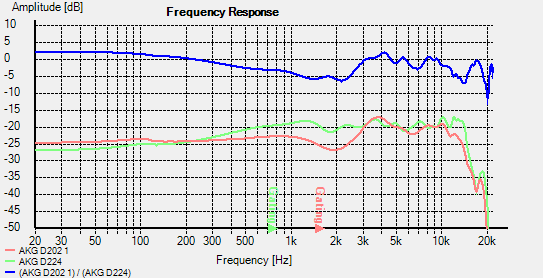

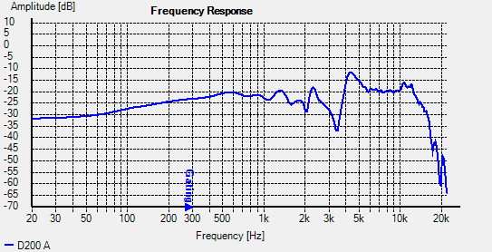

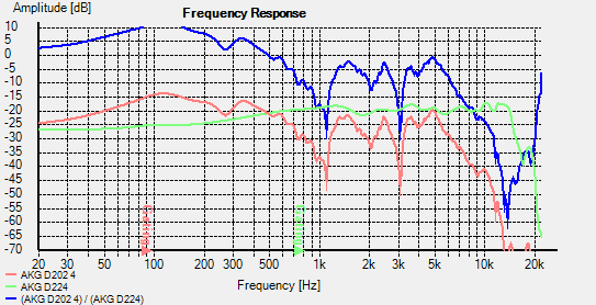

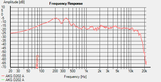

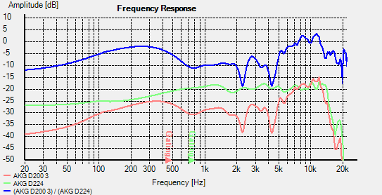

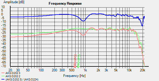

Repairing mics is interesting. Are D224s with broken treble units worth bothering with?
I've got a number of units with hideous frequency responses -
Is this sort of thing anything upon which you can work magic?

A working D224 is a valuable mic. They are notorious for the LF breaking.So you would probably get takers if you wanted to sell the broken one with the HF missing. The D224 repair can be difficult.The voice coil breaks due the stupid way AKG organized assembly. I don't repair mics other than the ones I own, or for close associates. Too much work.
