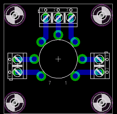

To revive this, are people still interested in this project? I got the OK from DIYAudio to do a group buy.
I received emailed interest from a few people (I'll email those people back to see if they are still interested.)
If we can reach a reasonable number, then I am happy to put together a group buy for both 7 and 9 pin experimenter PCBs. Email sockets@ecp.cc with interest. If a few people show interest, then I'll put together the details. I'd expect ordering for a week and a half or so and boards pretty quickly after that. Depending upon the number of boards, and the breakdown of types, I'd guess between $2.50 and $3.50 per board.

Hi Doug,
I stumbled upon this thread a couple of moments ago and I am definitely interested in getting some. Are you planning on doing octals as well? (I do have octal relay sockets and can use them instead.) I'm interested in both the 7 and 9 pin sockets and would probably take 4 x 7 pins and maybe 6 of the 9 pin sockets..

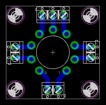

If boards is still not ordered, maybe for more easy work with this boards it is good idea to change connectors position little:
For 9 pin tube- 2 pole connector for pins 4,5 (heater), one 3 pole connector for pins 1,2,3 and second 3 pole connector for pins 6,7,8 and one more connector for pin 9.
So for dual triodes we have separate connector for heater, one for one triode and one for other triode.
For pentodes°use at least heater is on separate connector.
for 7 pin in similar logic.
Zigis.

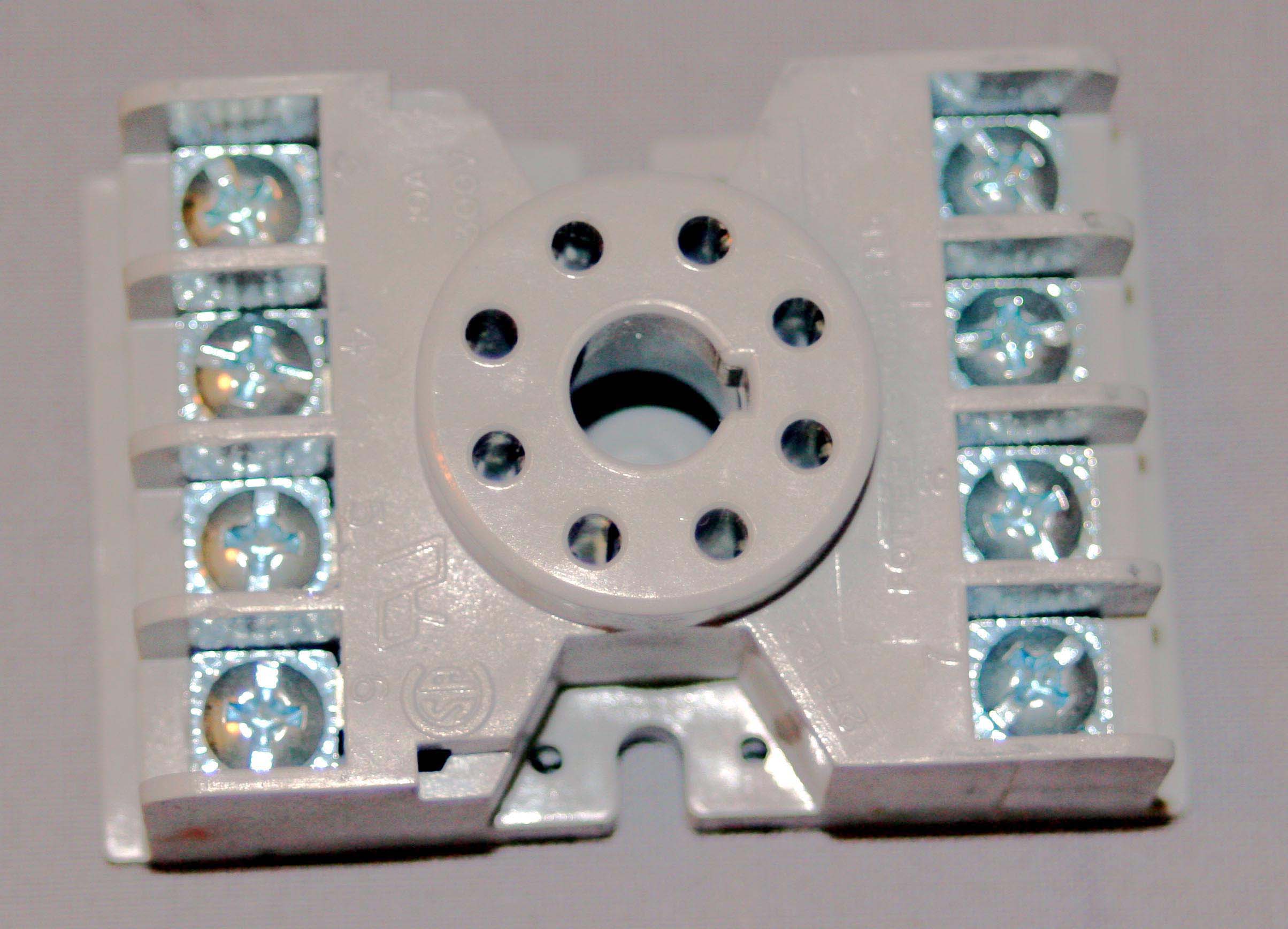

I've done some proto sockets almost exactly like Geek's pictures.
Either I didn't see his pictures when I suggested PVC end caps, or something filtered into my noggin in a subliminal fashion. Schedule 40 PVC end caps are about 50 cents apiece at the big-box hardware stores. I flattened the slight bulge at the end of some of the caps using a belt sander. Not really necessary in the long run, as the big hole for the socket takes out a lot of the bulge. I used a unibit and a drill press to make the socket holes - the PVC drills like butter. Putting in the socket mounting holes and the radial holes for the wires is a snap - you could really do everything with a small vise and a hand drill, though a drill press makes things easier. So far, I have a few 7 pin and 9 pin miniatures made up. I already userelay sockets for octal tubes, so that base is covered.
Next up are some compactron adapters for 9 pn Noval and Magnoval sockets, and the duodecars - a little larger end cap, more holes, blah, blah, blah. One twist to the concept would be to cut up some euro-style connector strips into two and three position bits, and hang them on the ends of the radial wires for solderless conections. Pictures of this will follow when I'm done. One thing to remember doing things this way is to use top mount sockets - the PVC is too thick and irregular to easily do under-chassis style sockets.
