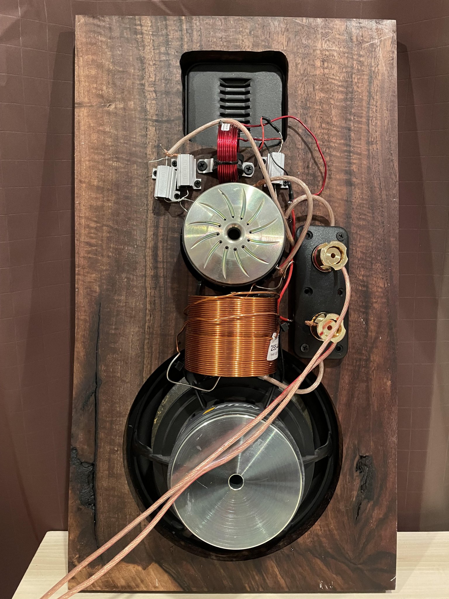

It’s just a personal preference. Here are some (probably controversial) reasons:Why hatred for caps? And love for inductors?
1) For longevity; I hear about people “replacing caps” a lot more often than I hear about people “replacing inductors”
2) Sound quality… I’ve built serial first-order crossovers both with-and-without capacitors and found I like the capacitor-free “Acoustic Reality” crossover the most. The difference is subtle but it sounds a touch more transparent and vivid to my ears.
3) There’s something strangely cool about Inductors to me. I have this weird fantasy of building an entire crossover just from a continuous long stretch of wire with inductance and resistance coming just from the wire. (I guess it would need to branch at points).
4) I’m weird so don’t listen to me ;-)
That said I’m not entirely against caps and plan to use them in an upcoming build.

Greg, those Zisters really should be mounted on a heatsink for full 25W capabilities, and your Rp resistors are likely going to need one. 4 ohms across the load before xover will shunt full bandwidth and get hotter.
I have no problem with the ARSXO, but the capless version sucked a LOT of sensitivity from the system. In your case, the large loss is welcomed by using an OB arrangement.
