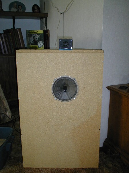

Update
I have gotten things set up with a subwoofer and an aux. tweeter. I am still running full range into the 8" but since I have the sub on line I don't have to boost the bass so the effect is to reduce the strain on the full range quite a bit. The tweeters are soft domes that I had from an earlier project. I have just a simple blocking cap to protect the tweeter. The cap I have crosses at 5K. I will probably get one for 10K but even as it is the sound is much smoother and less honky.
Here is a pic of the setup (sub not shown) as it sits now. Eventually I will mount the tweeters on the baffles right above the FR.

Re: Update
it is a good idea to x-over at 5k or even 10k. But in the long run you should consider a cone tweeter because it will better integrate with the philco. The dome tweeter will still radiate 180° at the x-over frequency while the philco is already beaming.
Rudolf

hmm... good point. I will check the philco tweeters. I was getting no output from them the other day but that could have been the old caps. If push comes to shove a couple of cone tweets would be super cheap.

Rudolf, it turns out that the voice coils on the Philco tweeters are open. Oh well.
