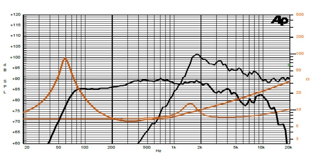

Coaxial speaker Sica 10C2CP, 8 ohm, 10 inch
Compression driver Lavoce DF10.10L, 8 ohm, 1.0 inch
Combo shipped - 125€

Sica makes an amazing coax for the money. The 5 C 1.5 CP is one of the best coax of its size available and it costs less than most other drivers like it.
