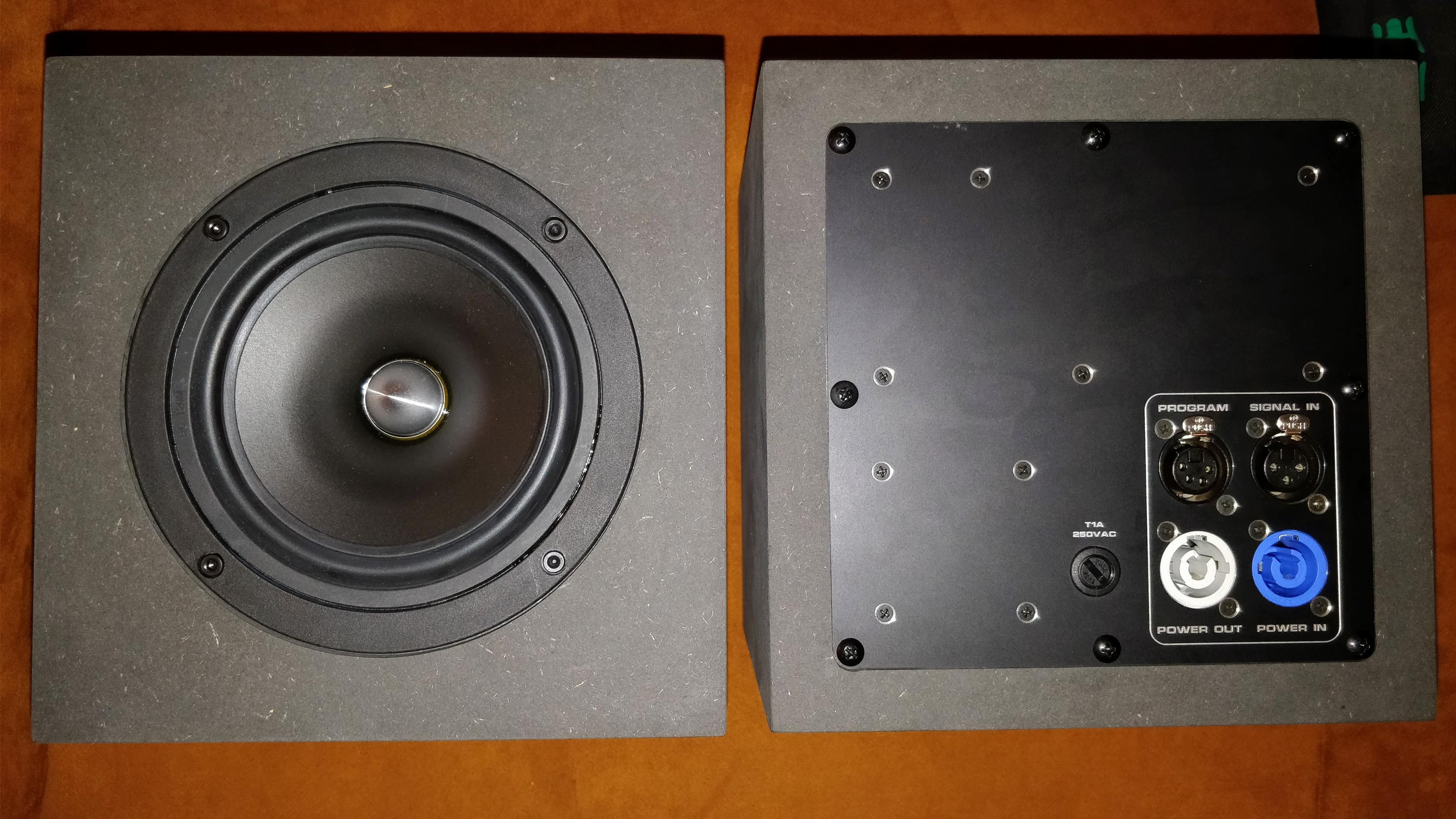

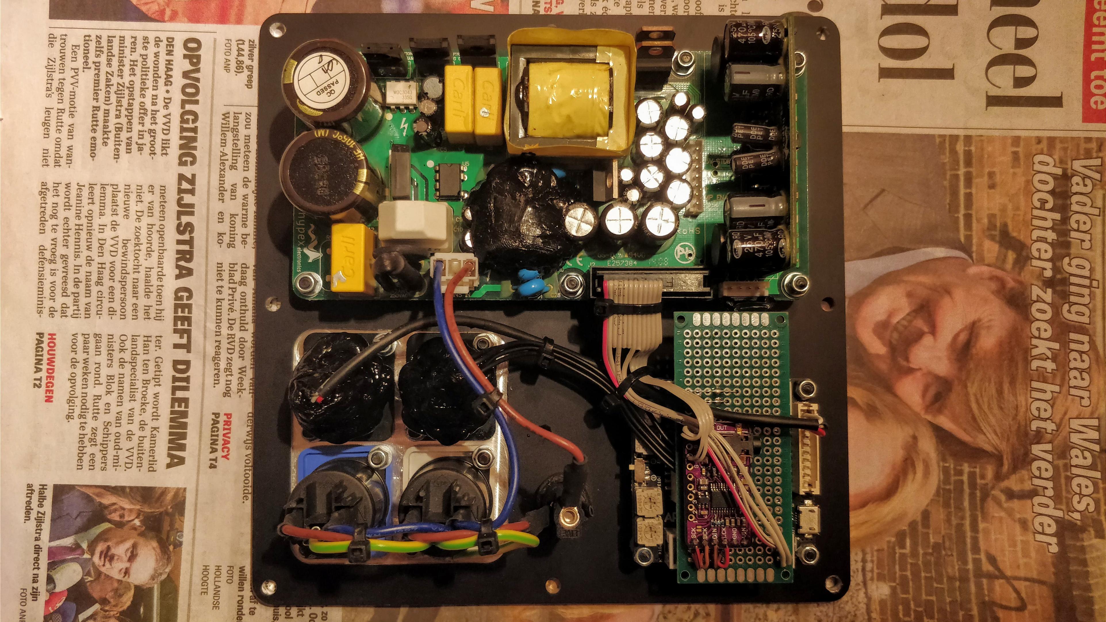

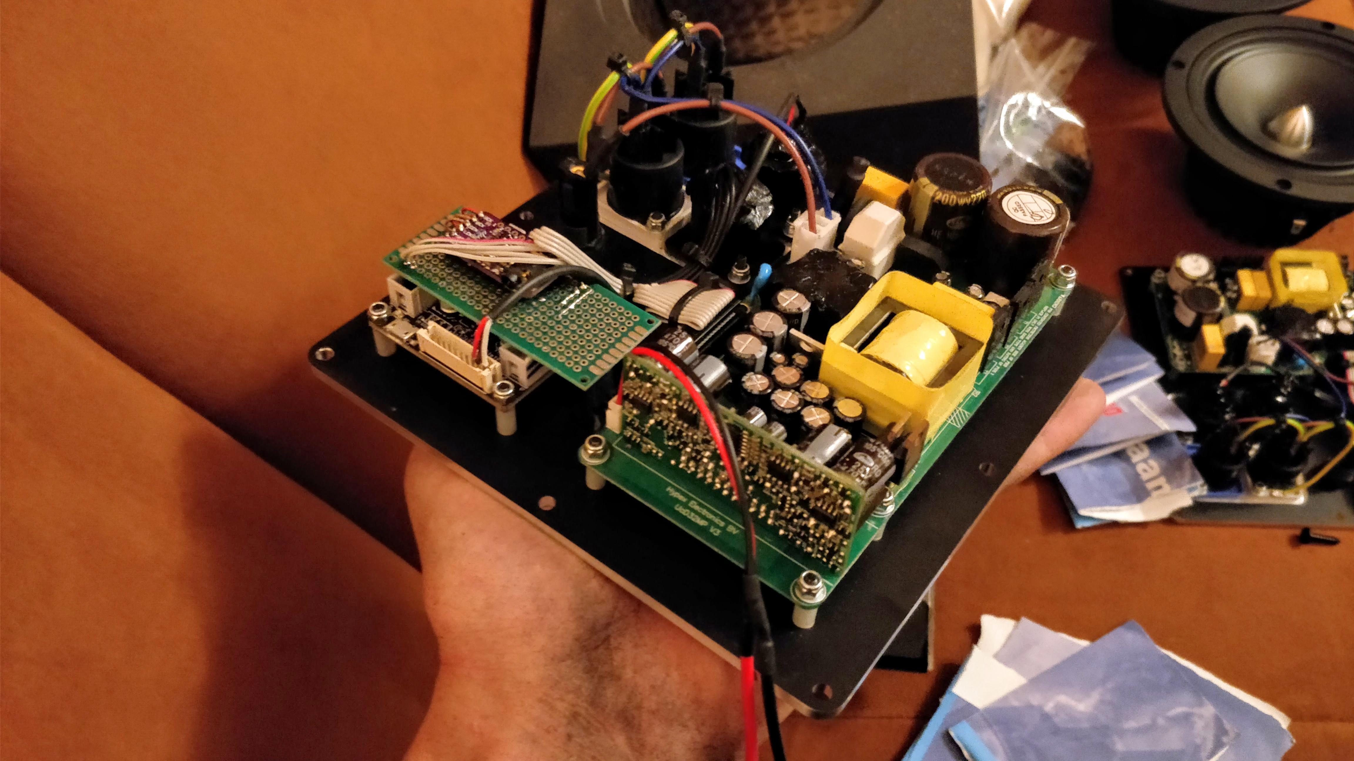

Looks like an interesting project, especially the daughter board on top of the Sure ADAU1701 board. Any link to the project?
I don't have a thread about the project on here, I did post it on a dutch DIY audio forum though.
The board ontop of the DSP board is a cheap PCM5102 DAC. The Hypex UcD32MP I used needs an input buffer with gain. The PCM5102 DAC had a bit more output gain than the onboard DAC so I cheated by using that and not implementing an input buffer with gain.

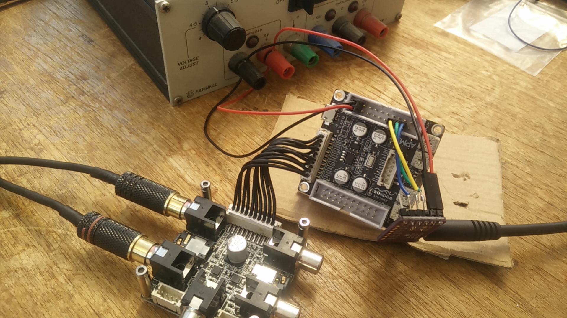

I just ordered the dsp board and programmer. I have same intentions as OP, a boombox project. It has TPA3118 amp with 6S li-ion battery, BT-receiver and Dayton Audio ND91-4 in a ~2,5 liter box with two 4" passive radiators.
