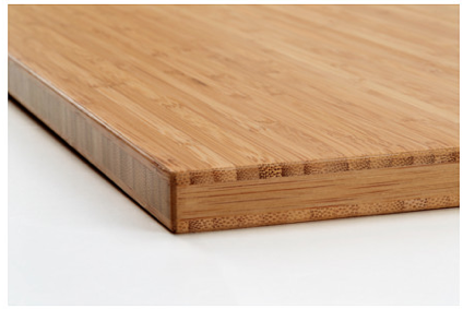

There are 3 kinds of bamboo ply available (at least here in NA). Horizontal, vertical, and stranded. They all have the same block core, but with a different construction for the outer plies. The stranded variety (a matrix of bamboo strands) is the best (due to its much higher stiffness).

Fine & coutse might be different names for vertical & horizontal. Chris was the one did the actual joinery, but he did say that he had to do things a bit different to take advantage of the edge grain.
Our 1st bamboo build (vertical grain). What looks like marquetry is simply the edge grain of the ply.
This would be natural finish… carbonized is "dyed" darker.

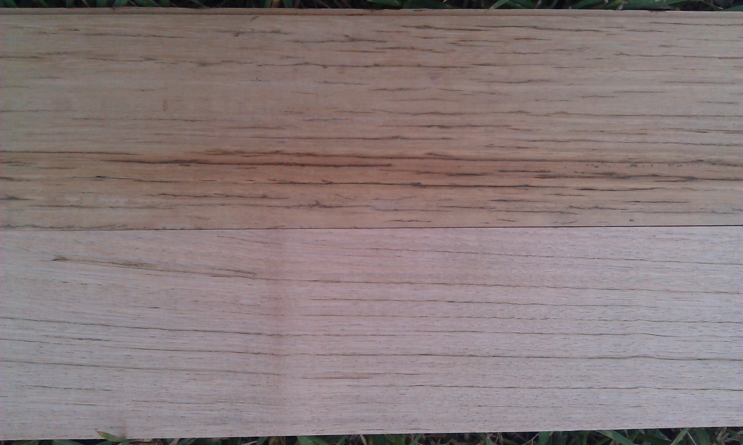

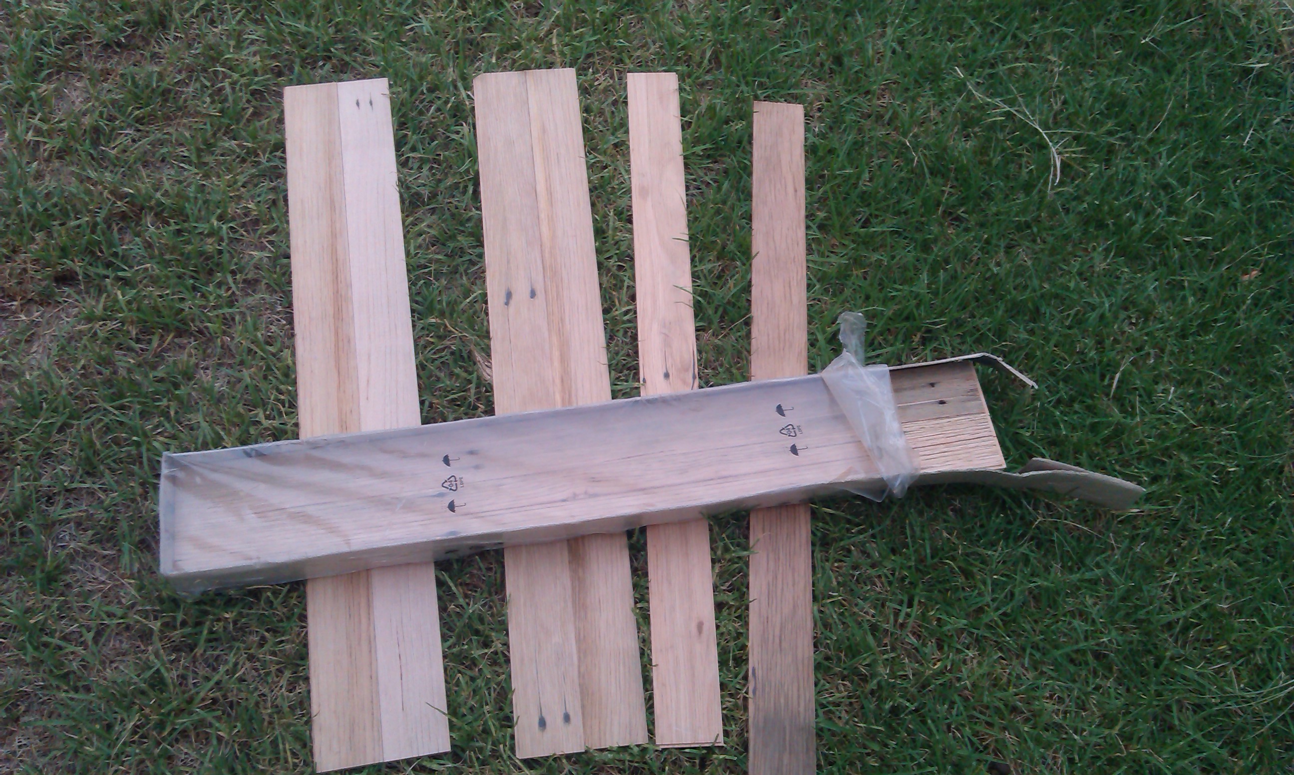

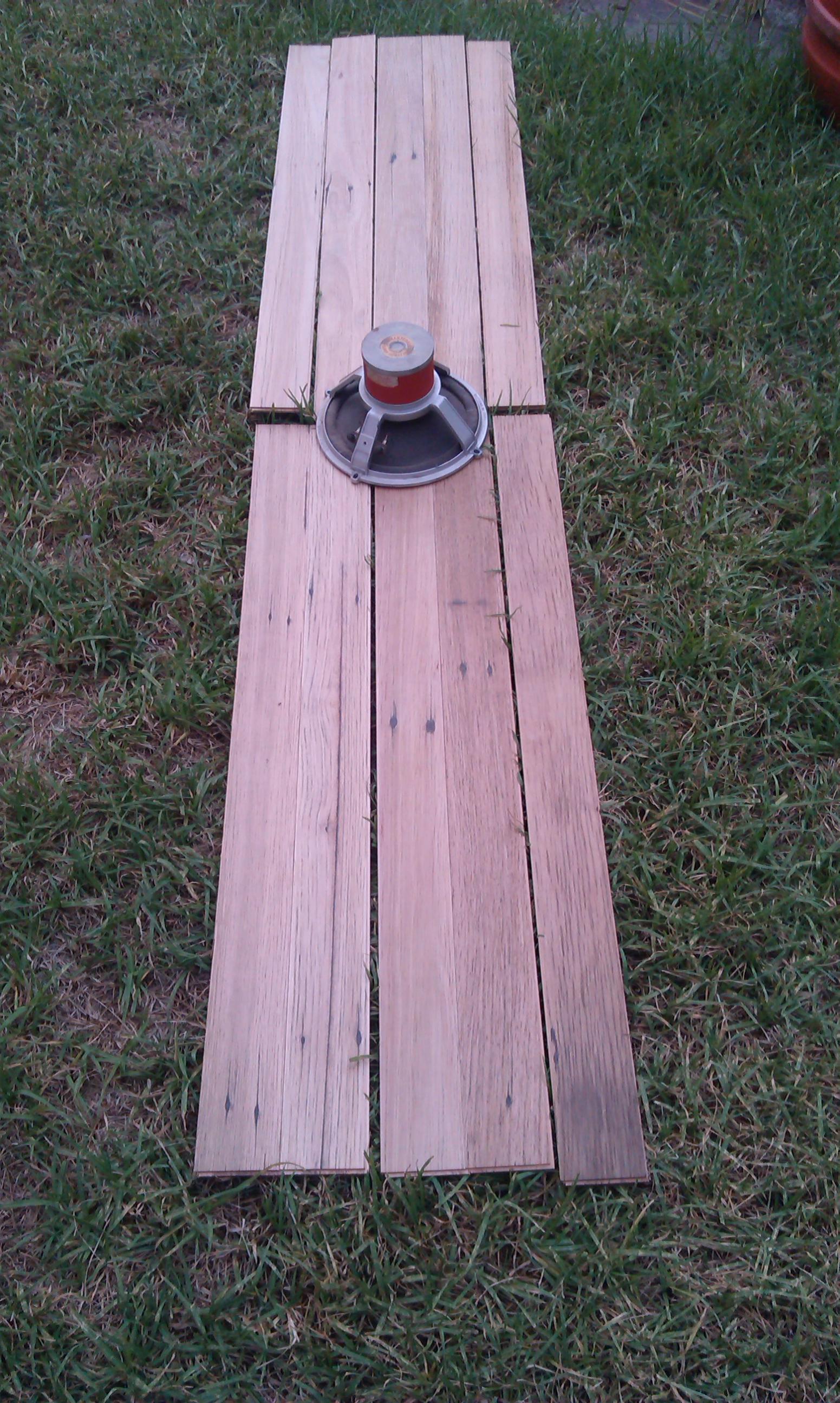

This is the 9mm 'rustic' overlay flooring, with a 10" driver for scale. It is light and quite nice to work with.
Most pieces have some nail marks, and a few have other defects, so it is only viable if you're happy with these features (or you could run the grain horizontally, thus using short enough pieces to avoid the flaws).
This pic with the driver shows the colour matching possible with slightly less than a complete pack (expect to pay $50-$70 per pack).
The boards are ~15cm longer than you need, giving a little bit of leeway for trimming pieces you don't like, and aesthetic tweaks like staggering the remaining flaws in a way that looks nice.

What wood is that? My other thought was to have the baffle in Tassie oak.. Thanks for the pics.
The 19mm stuff looks like Tasmanian Oak, but I think a lot of pale native timber gets lumped together as "Tassie Oak" or "Victorian Ash". Many timber yards don't specify species at all, they just call it 'kiln dried hardwood', so I find it a difficult topic to educate myself on.
The 9mm stiff is a mix. Most of the pale, fine-grained stuff looks like it came from tall, mature trees, so I would guess Victorian Ash. The rest: not sure.
