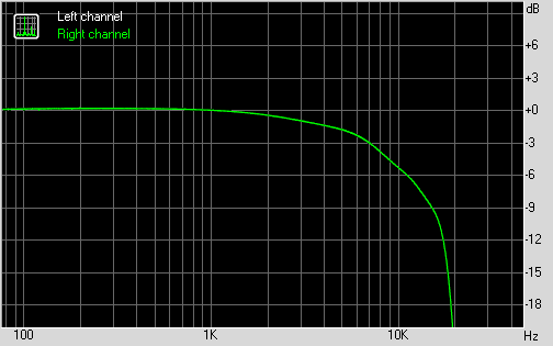

Ok. Well there it is. Rolloff. I'm not nuts after all.
I made a 20db attenuator for the probe and used an audio power meter that provided an 8 ohm resistor load. That way I could do all the tests for a 1w target.
I did two tests. One with global feedback one without.
Que Terrible!

Looks like 6 dB per octave drop off above 6 KHz. If you do a standard freq. test like I mentioned above (source Z = primary Z), you will likely really be horrified.
This is clearly just a random wound power transformer design, not progressive wound as required for audio.
Que Terrible!
That is wretched! 😀 Bummer, but thanks for publishing the information.
Thanks to everyone for this information. This sort of confirms what I feared in the first place. AnTek seems OK for power transformers, but if they don't have any history with audio transformers, they might just try winding them the same way...
Thats staggering.
I using plain vanilla Telema power toroids on my main amps. Very simply designed with secondaries straight on top of the primary. I get response up to 50Khz and descent output down to 10hz. I can't understand how Ampilo have got it so wrong. Maybe their trying to interleave and are increasing the interwinding capacitance(which is the main issue I have encountered). I did find that it was important to get things wired up correctly otherwise it would ring out at about 60khz, but other than that no issues. All my designs use Schade feedback to get low enough output impedance to bite on the lower inductance.
