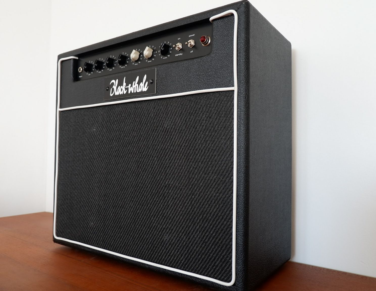

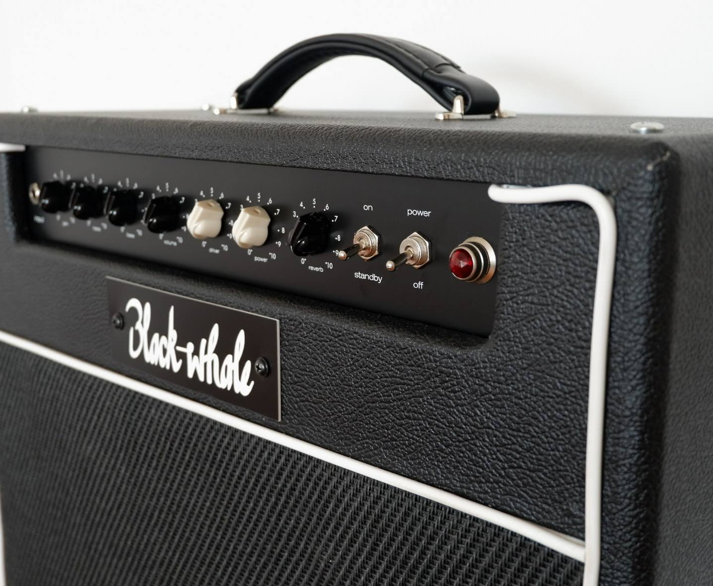

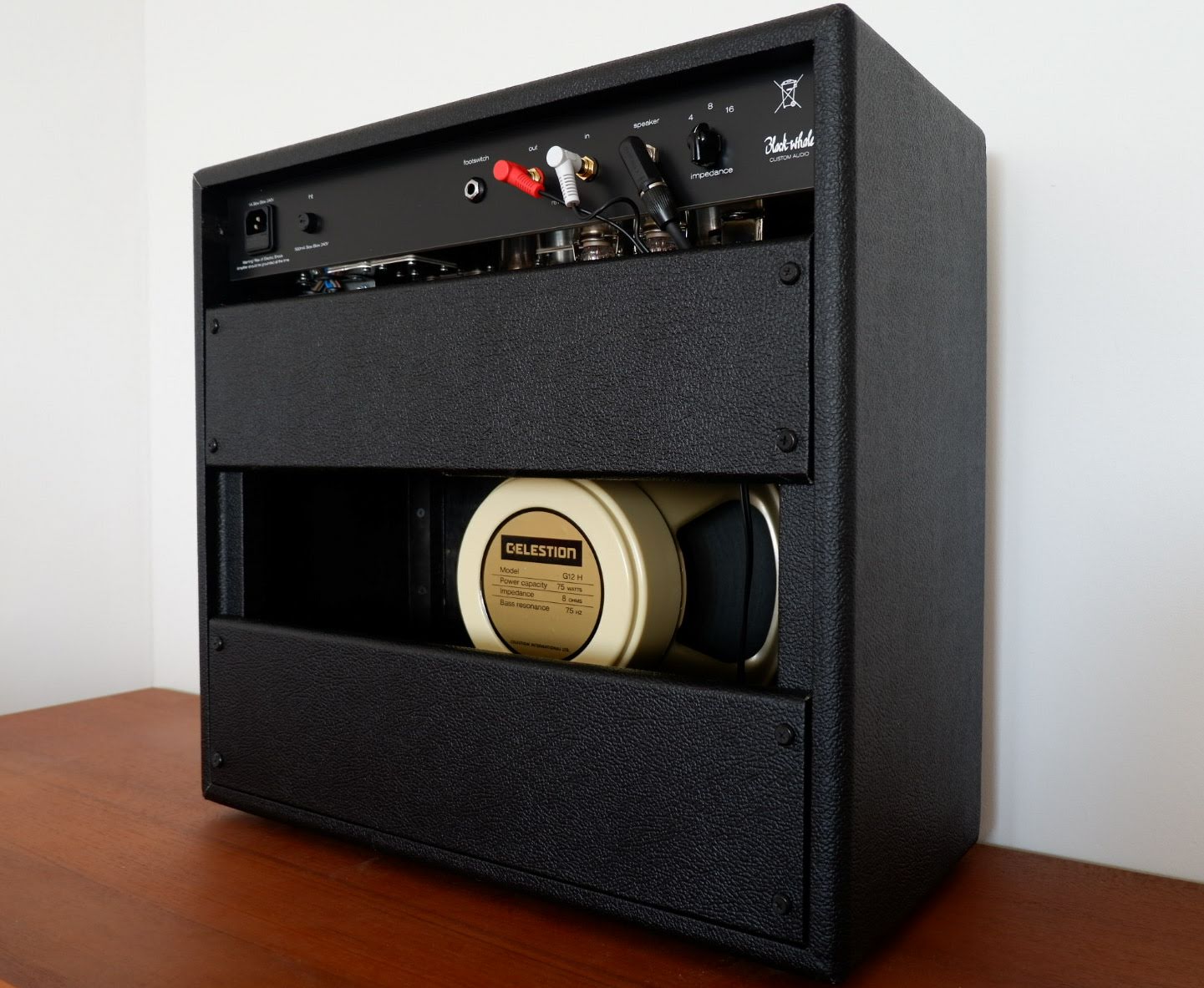

I agree with you. At the end, I left the two controls for the Power Scaling. I had to remove the MID because I didn't have too much space in the front. I could had removed the STANDBY but the holes don't match.
I plan to do a MKII for this amp. I'll put back the MID, and move the POWER to the back. STANDBY is not really needed. I won't put back the FX LOOP as there is no added value on it
I added some pictures
