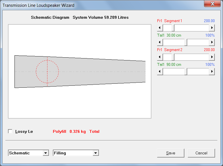

Rats my computer is a Mac and hornresp seems to be a windows application. Might borrow the wife's. But I think it will supply numbers/graphs rather than reasons.
End correction is a thought, but the difference between the 10:1 and 1:10 tapers makes the length more than double for the same fundamental, which is a very big difference. My reason for thinking about mass loading was wondering if an expanding line is a sort of "negative" mass loading, and a diminishing line is a positive.

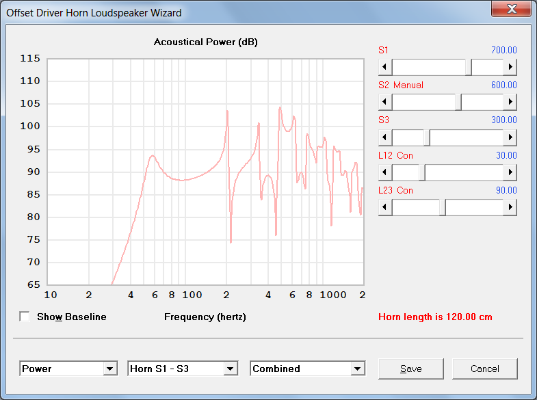

Well, my simpleminded way of understanding it is that the 10:1 is exerting 'x' amount of acoustic pressure under compression at the terminus and a 1:10 has to have a longer expansion to build it up to the same acoustic pressure plus the end correction of the horn is much greater than the TQWT, making for more harmonic structure offset.

They aren’t emulators, they are virtual machines. Sun’s is free but you still need a copy of Windows to install in it. WINE is free and runs without Windows, and i think HornResp is well enuff behaved to run it it. HornResp does’t take damping into consideration which makes it hard to interpret. Leonard’s TL sim is better in that respect.
dave
Ok, thanks, thought I saw them called emulators a long time ago when options first became available. Anyway, just know that some folks run HR on Macs. Best to browse, search, ask details here: http://www.diyaudio.com/forums/subwoofers/119854-hornresp.html
HR now has mostly good enough filling options, just don't know how to interpret his specs to fiberglass, etc., except by measured results plus has XOs and more new features than I can keep up with.
