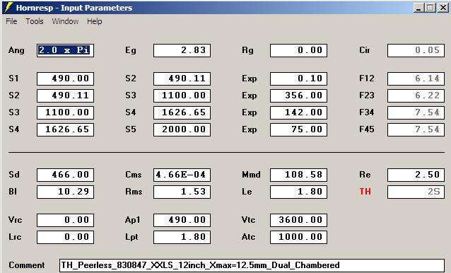

My suggestion is to give four Peerless 12" XXLs sealed boxes a try. Very difficult to beat for cost, size and-particulary-ease of build. For example, there was a realy nice write-up on a sealed 12" sub called the Thrifty Thumper, by Robert Trim in 1997. Four "end tables" maybe with corner loading would be something, and the sealed box has an excellent impulse response. But, if you are looking for maximum low end impact, tapped horns should be better.
Luckily the Peerless XXls line of 12" woofers models very well in a 300 liter tapped horn, and a dual driver (maybe push-pull?) 600 liter tapped horn maximizes the use of the 830847's Xmech v. distortion, and power. So, with a bit of OSB you could easily build sealed and TH boxes, and see which one is the better compromise for you.
For an all out attack on the low end Tom Danley's recent gift to the DIY community-the DTS-10 -would be very, very hard to beat for the price; with any sub. They are still available at the introductory kit price (quite possibly? a loss-leader), and there is a monster thread already in the AVS Forum.

So you already know that the hornresp sims don't support your post. Why don't you just say that rather than quoting it adhoc. 😕 What I read of the sims is that this driver may well not be suited to a tapped horn; not all drivers are. I would think running these drivers LLT or sealed as preferred by the OP might be a bit more apt. Not saying they are the best drivers for the job but worth investigating.
Regardless, it looks like he plugged a fair amount of data in - and if hornresp is worth anything - it should give a rough approximation as to what to expect.
I used these specs. I let Hornresp calculate BL, Cms, Rms, & Mmd with the T/S parameters.
