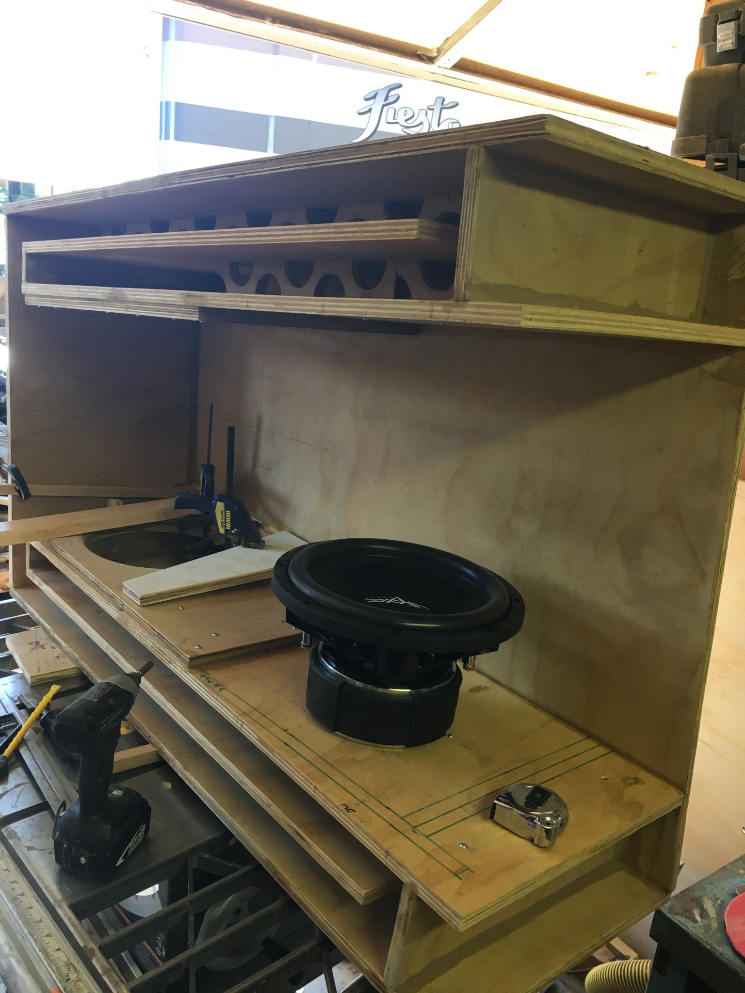

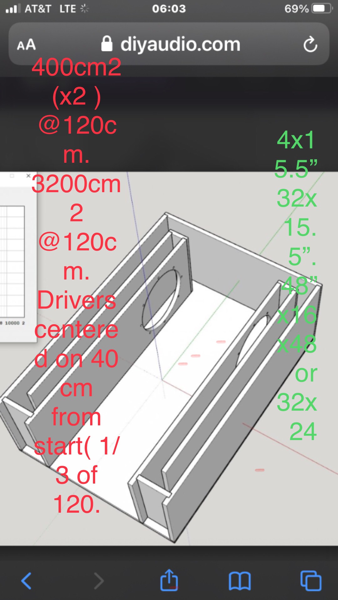

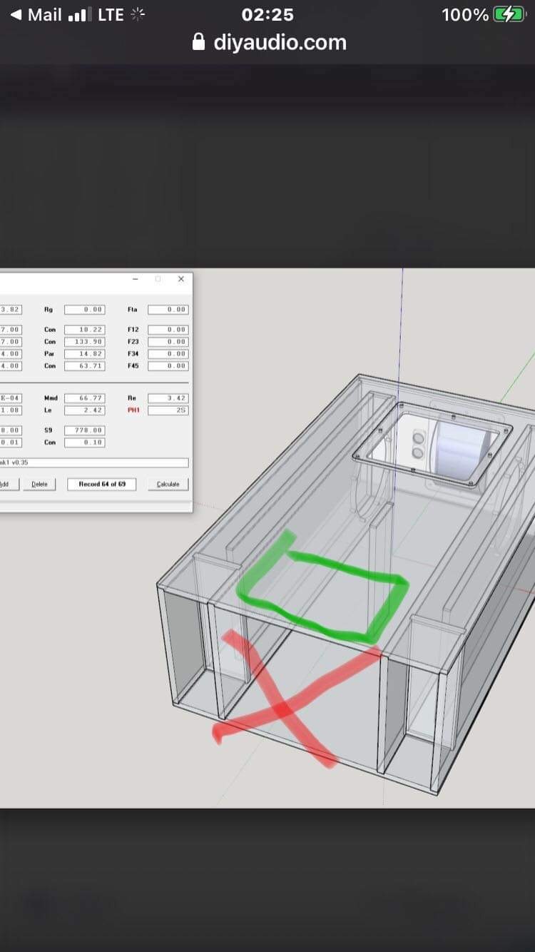

How do you like to exit? Straight out the end or one last wall to encounter prior?
Sometimes it seems each of these folds is an LP filter at the ‘end point’.
Might be more evidence if they’re all precisely on point (this one is off just a little bit in the transition from second to the third segment as it sneaks by the width of the first(Nickel and dime stuff but it all adds up (or doesn’t essentially)?
3d rendering🙁I snatched Carlos’ drawing from his thread).
