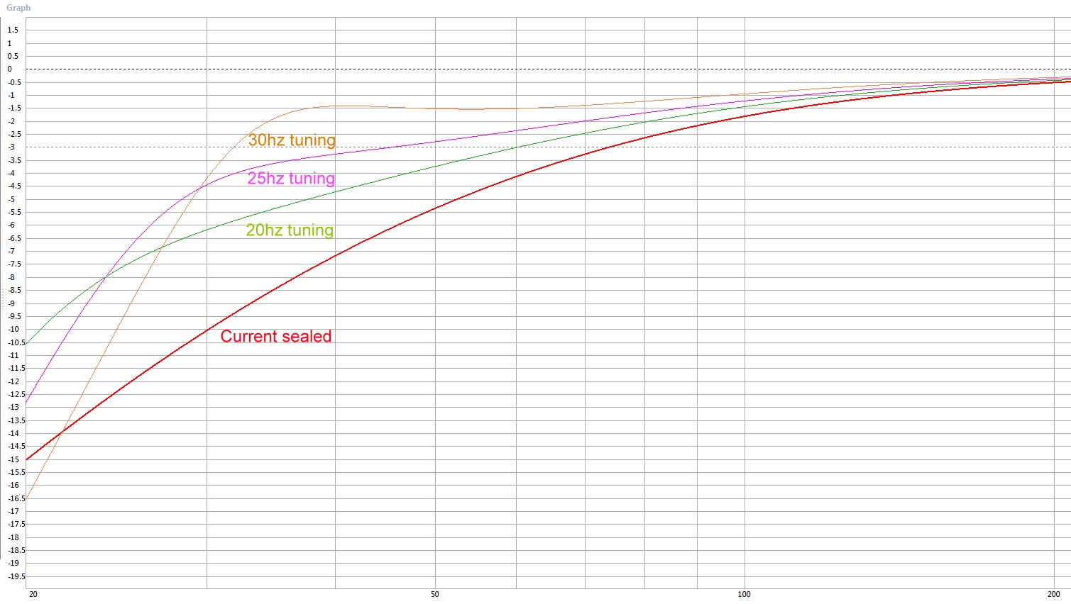

A friend has handed me a pair of home built (by the previous owner) subs to "fix".
I would like your thoughts and suggestions please.
Each cabinet is ~43 ltr sealed.
Each cabinet contains;
1x Bass driver - Peerless 830844 - XXLS 12"
1x Plate amp - oAudio 500w bash (Version with externally adjustable subsonic filter).
My winisd simulations shows the current sealed setup as extremely far from optimal.
After a little playing around, to me it looks like they would be better of as ported. (Passive radiators are beyond his budget)
So I'm looking at a 100mm port of ~600mm long (longer if I can fit it in) to give a tuning of around 27hz.
The other issue to keep in mind is his main speakers already have 13" focal bass drivers.
Thus making it hard to try and make these peerless subs contribute.
So, does anyone have thoughts or suggestions for improvements on this ?
Thanks 🙂
EDIT.
winisd shows the 100mm port as being acceptable for air speed, and 175wrms should take the driver to its xmax limits.
Port would be placed on the bottom of the enclosure which should help with port noise too.

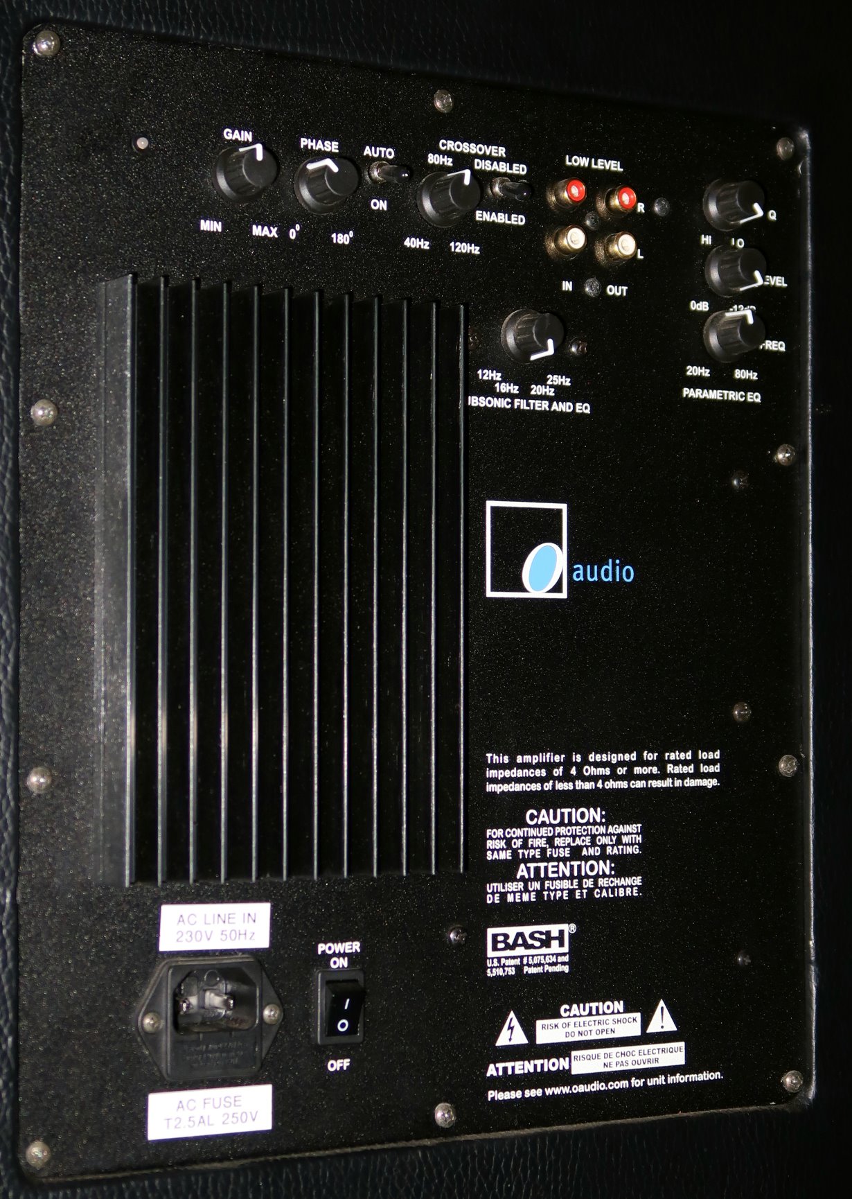

I thought the whole rationale for the O-Audio amp was the parametric EQ, is it not being utilised correctly?
Yes it has the single parametric.

So I guess that DSP is "Voodoo" in this instance? Not that I have any experience there my first foray into DSP will start when my first processor gets here next week. Depending on the model a Focal 13" woofer would have enough bass to please my ears even
I model in Jeff Bagby and it looks to be OK with a broad Q and 12dB at 30hz X-Max plus 10% at 350watts
I'm not sure if I'd classify that bash plate amp as having dsp.
It certainly has a few useful adjustments though.

With these subs, my other concern is that in their current guise, if you use the oAudios controls to get to where he wants, then I'm thinking he'll be pushing a lot of power into the xxls.
Um, He likes volume. Way more than my ears can tolerate.
Hence why I'm thinking if I can improve what the box/driver can do without processing, it might have a chance of a longer, happier life.

The amplifier only has a single notch filter so its not sufficient to equalise the subs. Why not just buy a whole system equaliser of some kind?

Earlier the OP says he has severe budgetary restraints. From memory tho the big 500 watt O-Audio plate amp has both frequency and "Q" adjustments of the inboard parametric EQ

That being said, Porting, stuffing, and then correctly adjusting the two separate subs should be (I'm theorising) a massive improvement over what they are now.
