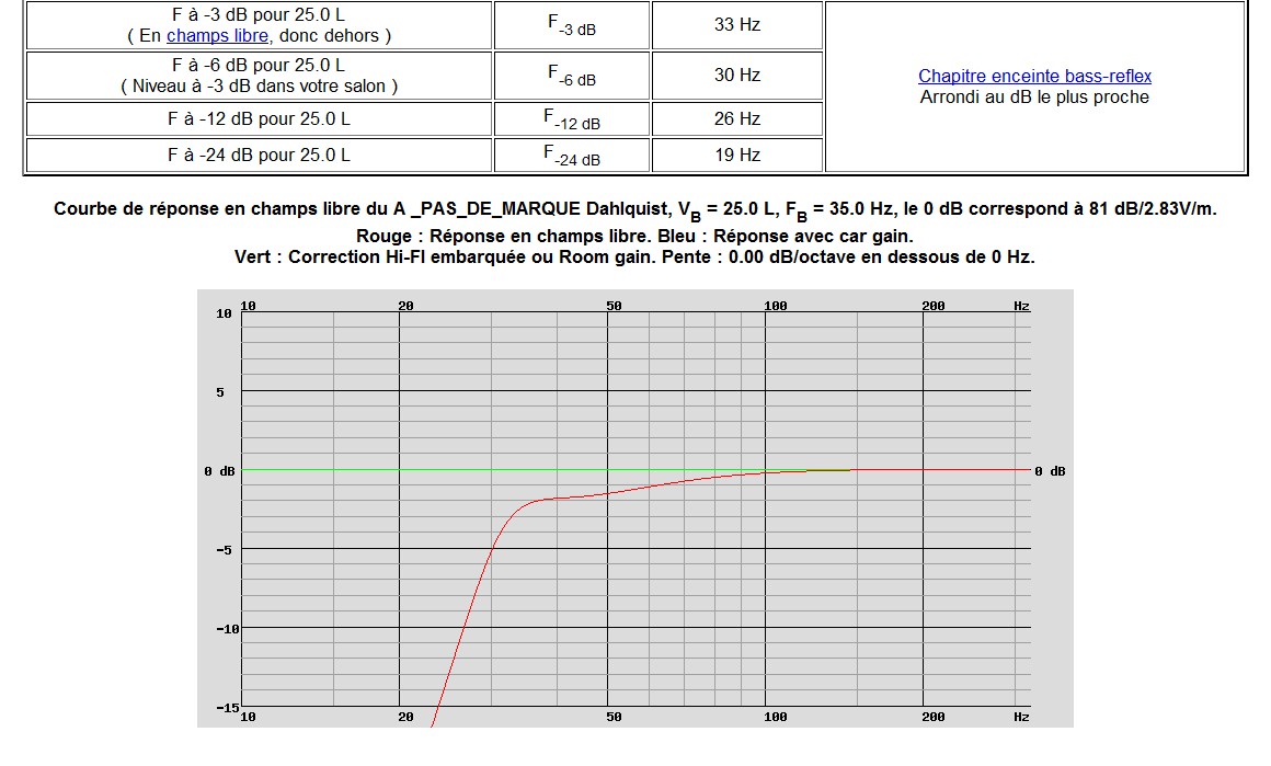

Dahlquist 7''
Michael (@post #5),
Dahlquist 17 cm/7'', ideal with VB = 15 L, FB = 34 Hz tunned. Best BR's internal volume between 11 and 25L. I guess this helps...
With a max. Vol. box tunned Dahlquist, VB = 25.0 L, FB = 35 Hz you have some control of the 30 Hz low frequency (F-5 dB free field). This can be the low effect that originally the OP is talking about. This and room gain. 😎

Michael (@post #5),
