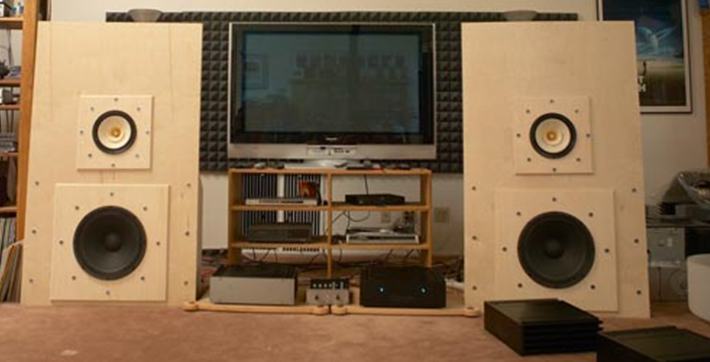

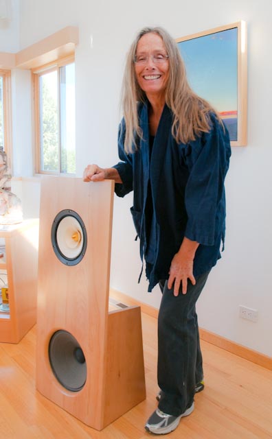

Those are some beautiful speakers, Phil. Great worksmanship!
Are the wings on both sides of the baffles? What did you use for the xover? And at what frequency are you cutting over?
Do you think they should be placed a little farther from the wall?
I'm glad to hear that she's happy with them. Congratulations!
