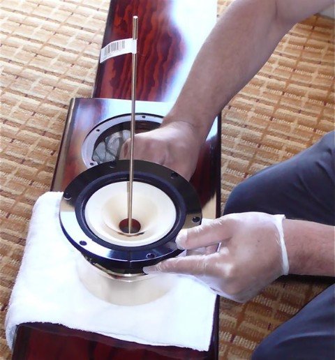

The 8mm rod
To make your life much easier use the 8 MM BRASS rod to help install or remove the driver.
Do not be tempted to use steel. Make sure the rod is clean and free of all debris.
Boy, was I happy to see Hal do this. This simple thing made the whole trip worthwhile. Not to detract from the tunes that played from that driver.

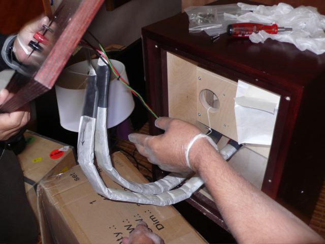

Oh, how I'd love a set of the Fostex wires. Solid tungsten, lead-shieled. Power cord weighed 70lbs.

Re: What is this man doing?
He's wearing gloves, so I assume Dr. Hal is about to check the driver's prostate. (Hey, if drivers have balls, it follows that they have a prostate gland too, right?)
The Feastrex flag flies over Iwo Jima
The twin cobras have got their fangs in the driver and are now injecting it full of their special brand of poison . . .
-- Chris
Phil Townsend said:He is applying torture to a Feastrex driver.
Phil Townsend said:8mm of pure brass right in the center!
Phil Townsend said:Big Cables
-- Chris

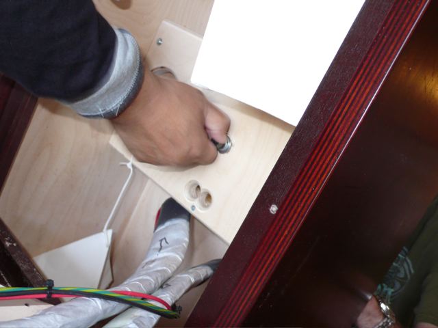

Re: A closer look at the procedure
Whatever temperature and humidity you're comfortable at, anubisgrau, will do just fine for the Feastrex drivers. That is a separate issue from the need to settle down after traveling.
-- Chris
anubisgrau said:so what are the recommendations for optimal air temperature and humidity for feastrex?
-- Chris
