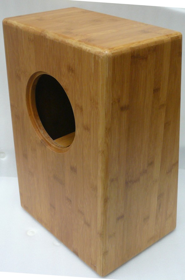

OK these just arrived. Some time back we had some discussion about bamboo wood. These are them. Solid bamboo. Now to try out the sound of bamboo. They sure have a nice tactile quality.
Brian
DaveCan said:Looks very solid, that bamboo makes a nice looking cab.. Dave🙂
bamboo wood in a cabinet is like nothing I've ever encountered before. A rap on the side gives a "ping" as if it's marble or ceramic. Very quick decay. I think these cabinets will either sound very good or very bad. They will not be mediocre.
Regards
Brian's
I would love to use bamboo for cabs and even have a large enough forest at the end of my street to provide me with all I could ever use, but the various tools maintenance/replacement cost required is just too high. 🙁 I could get a welder to make it out of the better overall performing brushed stainless steel for less on average.
