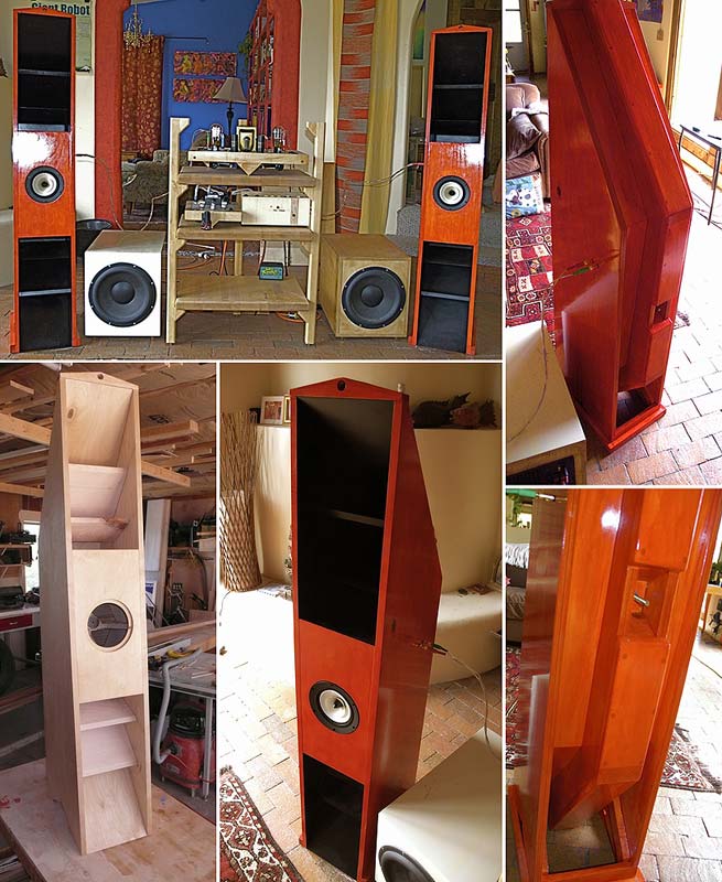

subs are just for decoration....

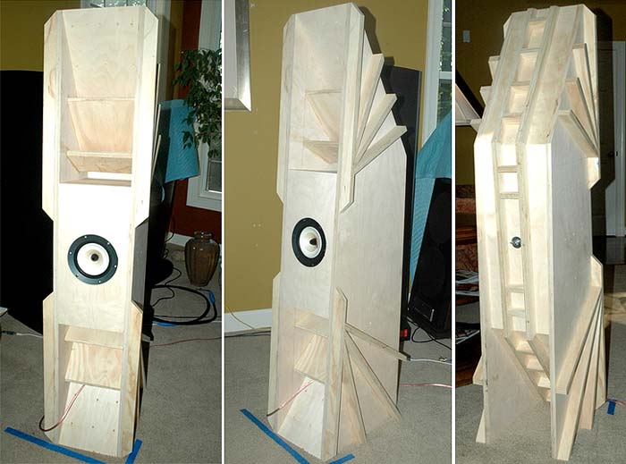

Nelson Pass said:
Ooooooh. Who did that one?
Those are Rich's... both are experiments in bracing. The 18mm side panels unbraced were not sufficient. Phil used oversize solid hardwood braces which loaded the sides (pushed the sides out)... from the reactions of both this was more effective than the internal + external braces made from ply -- i will probably specifiy double side walls + Phil's bracing once we get all the detail sorted out.
Also note the dragon spine down the back. Phil has closed his off and filled with sound. Rich has equal spacing. The original concept ones used fibonacci spacing.
There is no denying the cosmetic flair of Rich's Tiger Fish version, but it should be noted that these builds are based on a cosmetically simplified version of the box.

Bass, Lets talk bass. I like bass. I like lots of bass. I Hate subs. I hate what they do to a good piece of well recorded music. You do understand that I am a single driver nut. And I single ended nut as well. (I have the para feed 45 to prove it) And being that type, requires you to pretty much do it yourself or just go home. I can more or less afford to build what ever my current taste dictates. So that being said...bass.
I have never heard good, clean, tight bass from a single driver. So as you can see from the photos I have these subs. (That does not mean I like them, I don't) But I turn them on just enough to add that little something extra to the sound, bass. So yea, I got subs.
I love cowboy music...Kinda required where I live out here West of the Pecos and East of the Rio Grande. Standup bass is one of my all time faves and cowboys, play standup bass.
The very first thing I listened to today was cowboy music with that stand up bass, and the subs were OFF.
Guys, there was bass! Cool clean crisp tight deep bass! I was shocked, Here is bass without those damn subs.

I built the shark fin speakers pictured above. Thanks for posting Dave, and glad you like it Nelson. I only cut the wood and glued it on, Dave proposed the external fins as stiffening, drew the plans and deserves the credit for the "stimulating appearance." I just fabricated it. My wife saw them and said "Wow!" she liked it. A little paint might help too.
As for the sound, I was not originally pleased with it, but that was prior to adding any bracing, except that specified inside the coupling chamber. The sound of flopping baltic birch is terrible compared to pine. But once properly supported according to Dave's suggestions, it has improved a lot. I used **** plywood for the horn braces, instead of hardwood as Dave specified, and now those are the only thing left ringing. So I will sawzall those out and replace. Still need to paint the thing, that should damp things a little more.
I use Quad 2905, Usher Be20, Legacy Focus2020 as reference to compare. None have the harmonic beauty or even speed of the feastrex but they are far more neutral and balanced top to bottom. So we have some way to go in tuning/bracing or whatever. But it makes good bass, probably 50Hz with 12dB rolloff as predicted. Congrats to Scottmoose on the great design. Bass is very fast and clear, almost as good as the Quads. To get it even lower, I will be trying various sub scenarios, U Baffle, servo controlled, etc. I like Prokofiev and Shostakovich SYmphonies, both masters of low frequency power. Prokofiev is why I do hifi, simply gotta have perfect bass drum, <30Hz.
I have been experimenting with stuffing inside the cabinets. I tried 4 things so far. No stuffing gives the glorious Feastrex mind bending detail and penetrating musical drug, but too forward, and resonant with the sound of unmitigated baltic birch YUK! I filled the rear of the chamber full with poly wool all the way up to the rear of the driver like a big reflex design - horniness and birch sound curtailed, but way too dead (I am learning this from scratch by experimenting...) Then I took out 80% of that, just covering the whole rear wall (and throat openings) about 2" deep, much better. Detail is reduced by 30% from no stuffing, but much improved over previous experiment. Lastly, I moved this same wool from rear to front, touching the baffle. YUK! There is a very serious ring in there, it is a like a metal bell that is struck most noticably with trumpet whacking a note in the 650Hz range - unlistenable. This last was the most interesting to me, demonstrating just how important placement of tuning materials is.
Phil suspended a curtain of silk wool on the center brace in the middle of the box, seems to like that...
I plan to build variation of the design again in other materials. The effort required to tame BB doesn't appeal to me. The pine Freddie sounded utterly delicious with no stuffing and no bracing. Just a little woof at 200Hz, and plenty of pine color, but good Feastrex ecstacy and no bass. One Maiko experiment will definitely be pine, but not plain boards.
Thanks Dave, Phil, Chris, Mike, tallawalla, Hal and others for help and moral support on this project.
Rich
