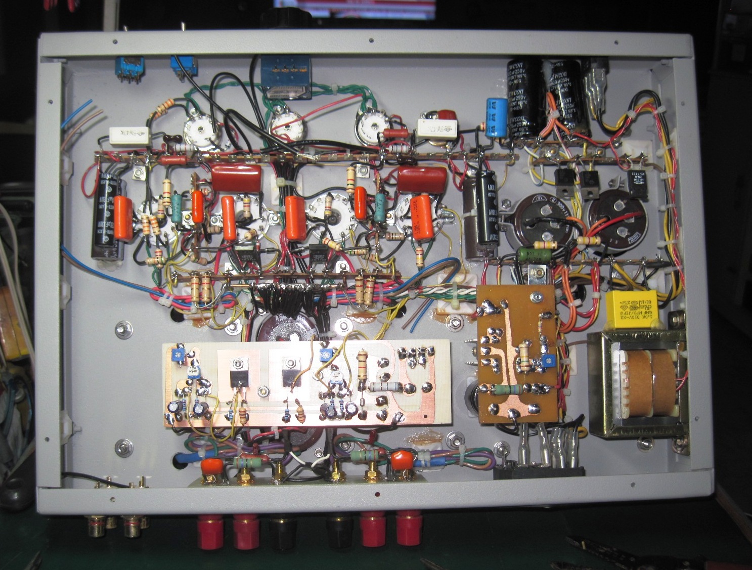

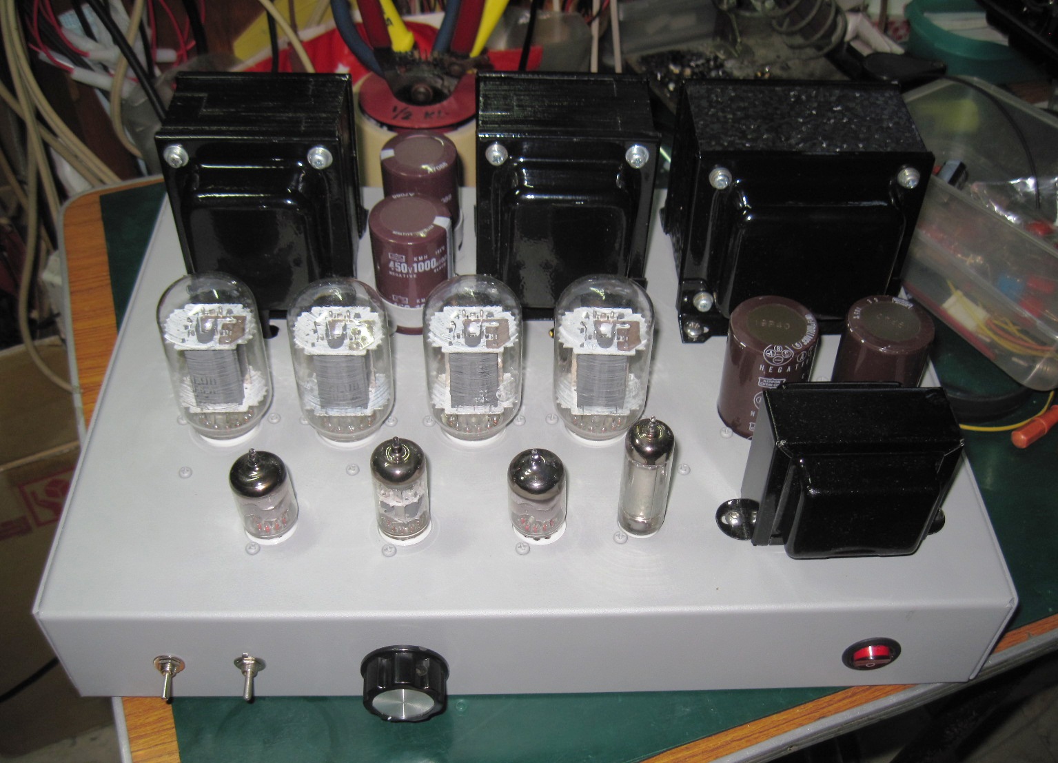

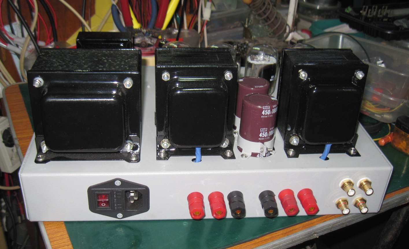

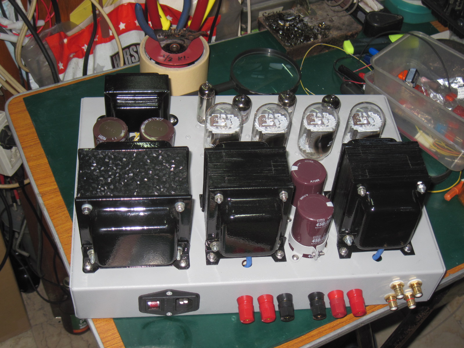

i used 1000ufd/450vdc ecaps one for each channel in a 6lu8 pp amp i made, i used full wave voltage doubler with 1000ufd/300vdc caps stacked up....i used two chokes, one for the plate supply and another for the screen grid supply...

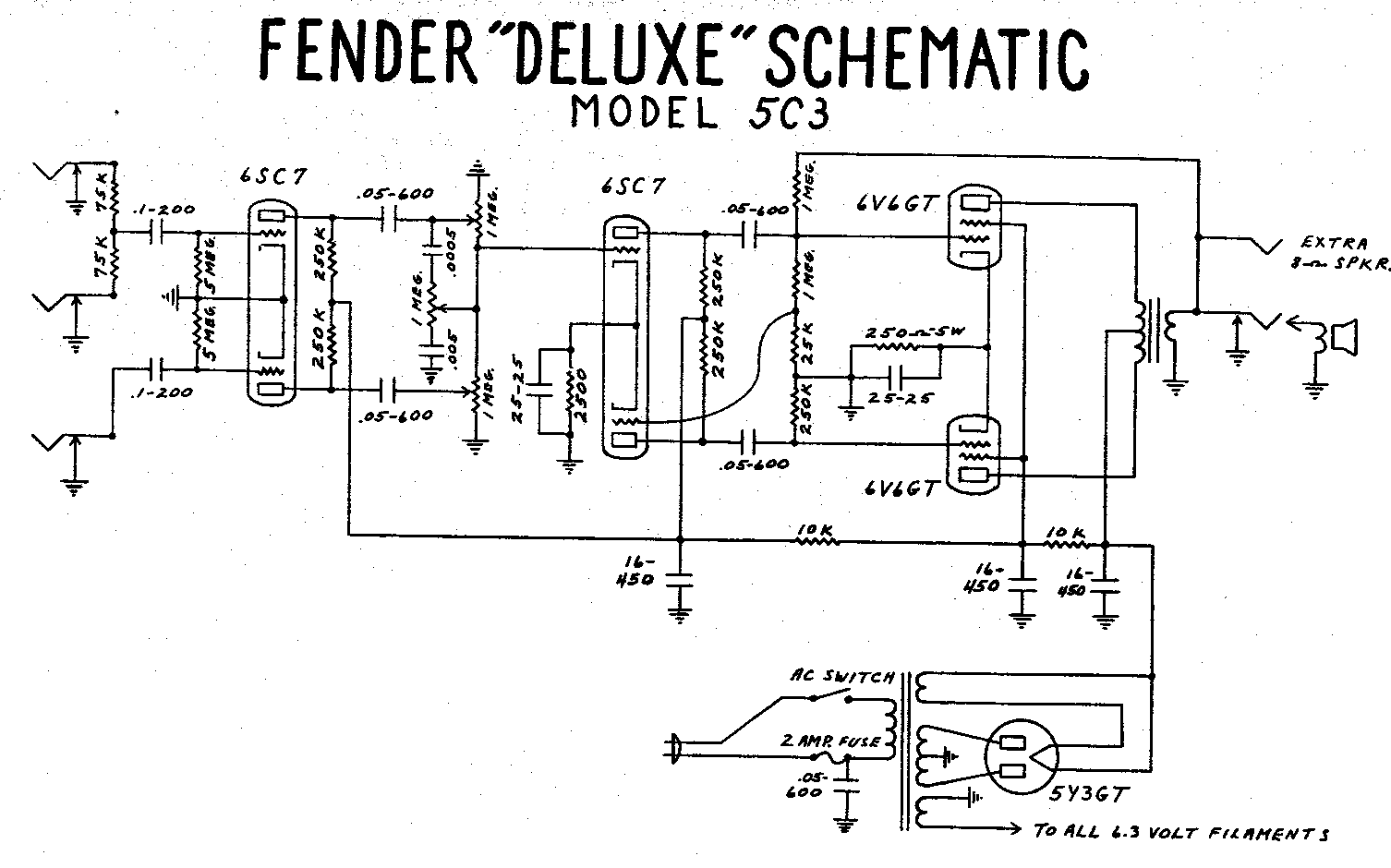

If you followed a typical Fender schematic, you already did this.
Look at the 5C3 schematic. There is a 10K resistor from main B+ to the 6V6 screens, and another 10K resistor feeding both 6SC7's. The rectifier is a 5Y3 which has quite a bit of internal drop.

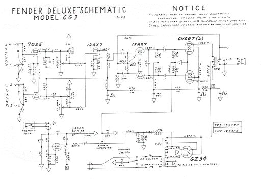

Look at the 6G3 schematic. The rectifier is now a 5AR4 which has less drop, and the 10K screen resistor has been reduced to 1 K. There are now two 10K resistors between the screen supply and the input tube, as well as an additional gain stage. This amp will make more power, and have a larger clean headroom, but have a harder "edge" between the onset of compression / distortion and full on clipping.
Some amps known for being clean will use a solid state rectifier (or a tube and SS with a switch) and move the RC chain feeding the preamp to the main B+ supply, since it does not drop as much as the screen supply when the output tubes approach clipping.
