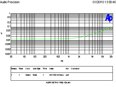

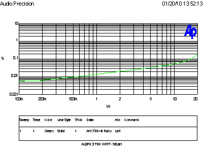

Mr. Pass helped me measure my Class AB SRPP Power Buffer at 01/20/10.
He copied the results in floppies for me.
But my floppy drive of my desktop is broken.
My dad's floppy drive of his desktop is broken, too.
So I dug out my antique laptop to read the floppies.
Here are the THD measured results.
The bias current of it is only 0.75 A.
It has 100% negative feedback.
I am very satisfied about these result.

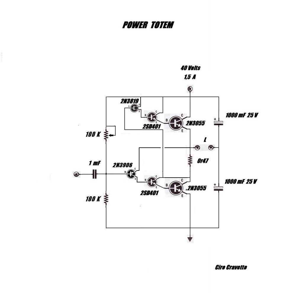

Listen Wensan: If you want to insert the Power Totem in a negative feedback loop for to improve it's characteristics, there is a very simple way.
The transistors are always six, but is necessary to increase the number of the other components. It's not necessary to invent nothing, but simply to joint the input stage of the JLH '69 with the Power Totem as shown in the schematics here attached.
Try it...

Wensan, The THD of your amplifier looks good. It's nice to be able to measure those things. Did you have a chance to see if it is mostly 2nd & 3rd harmonic ?

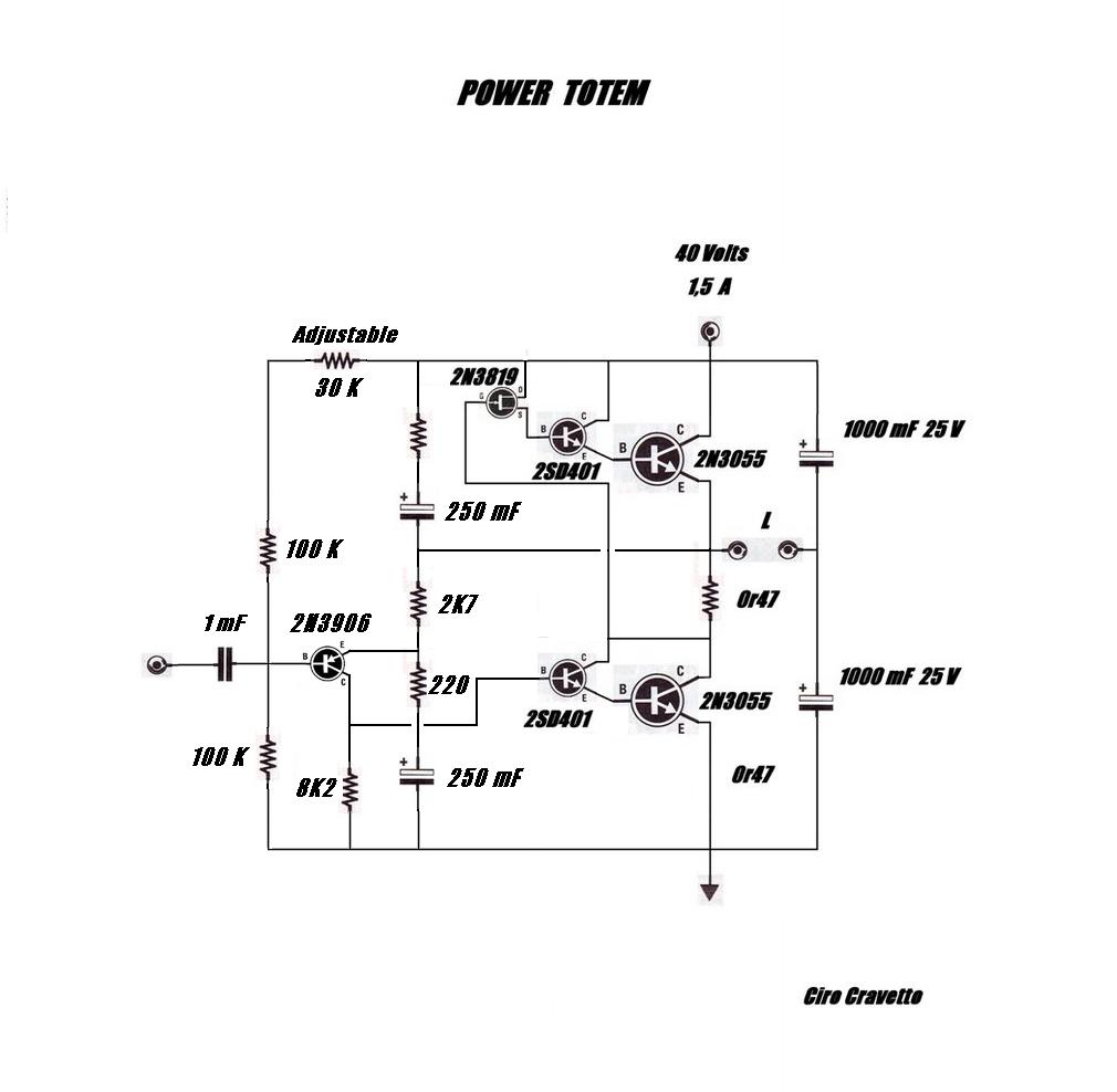

In the last days I developed a version of Vetruvio's Power Totem in the tentative to improve its performance.
This stage is a SRPP 100% negative feedback with very low distorsion.
Now the Power Totem is a " symetrical" push-pull because the signal driving the lower Darlington has the same amplitude of the signal on the gate of the upper one and becomes an output buffer because doesn't gain nothing any more. So, it needs an input gain stage. It could be a common emitter stage in the place of the two 100 K resistors.
I think it's interesting.

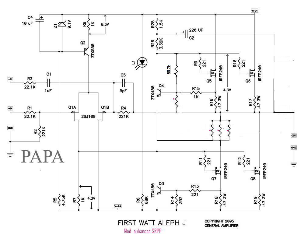

For now , i am gathering all the parts for building an Aleph J including your enhanced SRPP output.
I will be able to start soon, i hope.
I hope also the following schematic to be correct.
Though i hesitate on the red pointed resistors values. (8 ohms load wanted)
Your advice would be great

Did you get any further with this circuit?
Sound? Stability?
