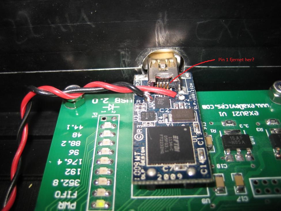

I've asked before but not sure I got an answer... I'd like to mod my ExaU2I and use external regulators and not use USB power. Which regulators to change and what voltage/current do they supply?

Here is my solution. Placid hd feeding usb on Exa. Great improvement in sound.

http://www.hifisentralen.no/forumet.../187437d1362849236-buffalo-iii-gwimg_1708.jpg
Could I ask you for a simple measurement? I assume your exaU2I is installed in your system, all power supplies are connected, the DAC is connected and the system can play music. Plug an USB cable in the exaU2I and unplug the other end of the USB cable from the computer.
Can you measure (approximately) the resistance between the ground on the far end of the USB cable and the ground of the line RCA (or XLR) cable that goes to your power amplifier?
Hi, sound like a good solution. Did you cut the +5Vdc pin on the header? If yes, I would like to find a way not to do this. Maybe just make a USB cable without +5Vdc and supply my own regulated +5Vdc?
exa065,
Any thoughts?
Hi George
I can measure later today
your solution?
that photo is from my dac and I was the one that first gave the tip to the Norwegian DIY community documented with this exact picture
(even my handwriting with pencil on the rear panel !)
the most significant upgrade to any usb dac imo
best
Leif
your solution?
best
Leif
Wrong choice of words from me. You are correct Leif, and it was thank to you who gave me the tip, that I have a very good sounding dac with Exa today.
Instead of opening my dac and take a pic, I borrowed your exellent pic which show how it can be done (and exactly how I did it too).
Hope this clear things up. Not my intension to take credit for what you have done, and I must say that you impress me in your never ending search for better sound.
Hi George
Hi again George
When measuring the way you describe, I find no resistance when using my FLUKE meter. Is this a good or bad thing ?
Regards
Tommy
Hi Tommy,
It is not a good thing. You should measure infinitely high resistance between the PC ground and the DAC ground. By changing the power source for the USB chip you have introduced a connection between the computer ground and the analogue ground. This connection acts as antennae for the high-frequency computer noise. This common noise travels freely to your DAC and amplifiers. Your exaU2I is like not having the ground isolation.
Try to use dedicated transformer, power supply etc. for the 5V supply that goes to the USB. Keep the grounds separate.
Hi Tommy,
Try to use dedicated transformer, power supply etc. for the 5V supply that goes to the USB. Keep the grounds separate.[/QUOTE
Edit: I think everything is ok George ( based on what you write above ) or ? ( see my answer to Leif in the next post )
I am using an dedicated transformer and psu ( placid hd )and the sound is great. Here is a bad picAn externally hosted image should be here but it was not working when we last tested it.
Tommy:
no resistance as in ZERO or what exactly do you mean?
best
Leif
Hi Leif
Fluke shows: OL = open loop. No continuity or over limit or "infinity" on a resistance scale.
