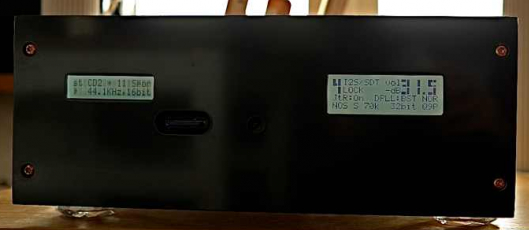

I have so far 22 albums that are recorded in DXD 352.8k/24bit Stereo.
The albums are in fact recorded in full DXD surround and I hope to be able to play surround in full DXD format soon.
Check out 2L co/ Lindberg Lyd 2L - the Nordic Sound as there are 11 tracks in DXD that you can download and many more in various Hi-Rez formats.
There are also other studios like Puget Sound Studio that records in DXD.
As all albums except the Nordic Sound album are sold by iTunes in lower resolutions - the DXD albums are recognized in iTunes and you get cover art etc.
Both iTunes and Pure Music plays the DXD files.
The only missing link are the exaU2I to get 352.8k out to the DAC😀
Currently I am using either a M2Tech USB unit and downsamples to 176.4k/32bit,
or a SDTrans192 SD card player and plays 352.8k with I2S directly to the DAC.
The ES9018 based DAC uses a 98.304MHz clock and the DAC outputs runs at 1.536MHz.
The DAC have an integrated SDTrans192 SD card player and have full IR remote control of the ES9018 chip and user control of the SD card palyer.

are you sure they are actually recorded at that speed, or simply upsampled to that speed? no offense to the Nordic race, but i dont care if its recorded at 10mhz you wont catch me listening to it. i listen to music for enjoyment and do not tend to listen to all that much 'audiophile music' whatever that is; except for soe select classical and jazz; just because its high quality recording isnt enough for me. i'll take well produced 16/44 that i love over 32/384 just because i can.
ive seen the files at hdtracks etc and have a few, but there isnt enough information to gather whether or not its recorded or just supplied at 352khz? anything supplied at a multiple of 44.1 rather than 48 as any regular recording gear uses i'm automatically suspicious of and many of these artists simply were not around to be recorded like this and while analogue masters contain arguably more musical information in some areas of sound, the noise floor is high enough that the bandwidth will be effected. so remasters will likely be a bit hit and miss also.
all i'm saying is, even going by your numbers and i'm gathering you have searched high and low for music you like, 22 albums is bugger all, repeats pretty quickly, all the same i'm waiting with baited breath for the release of some more usic i enjoy at this level. i'm not arguing against the use of such hirez, just saying its not really such an advantage for me at this stage over 24-32/192, except for playback of my musical meanderings from logic audio. annoying that modern gear is capable of it, but because it represents the master the chances of release are slim. the multichannel is much bigger news to me
thanks for the catch on 1.536 vs 1.4mhz, i was still out of habit being deliberately vague with ess datasheet details, but i suppose it really doesnt matter anymore.
your dac is looking really good Raymond, but I couldnt be bothered listing out the spec of the dac i' using and its still under the knife, although kinda similar. id really like to hear your lovoltech jfet power amp one day
Yes I am sure!
As I wrote - the master recording are not only done in DXD, but DXD surround..
I have listened to the DXD surround masters in the 2L studio and compared to DXD stereo - due to that I would like to implement the ability to play DXD surround my self - then I can play all surround formats up to full DXD..
1.6875MHz are the highest I have been running the Sabre32, but at the time I tested I got some spurious noise issues and went back to the safe and working 1.536MHz.
cool, i' just never able to find that much info at hdtracks and like i said multiples of 44 make e suspicious. dxd surround is of great interest to me also eventually. but multichannel will only be used for 2 channel digital xo for me for now, thats exciting enough.
i'll have to go check out XL some more now that we upgraded the link here downloading that much is not an issue. i imagine the playback system there is pretty special
