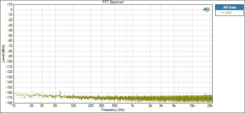

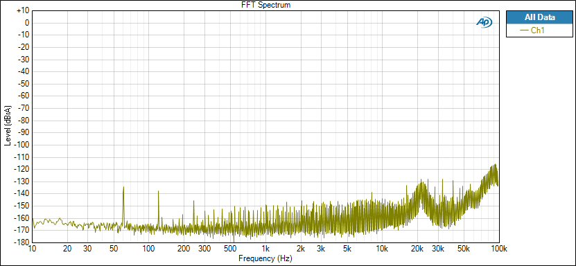

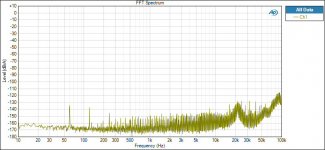

Ground isolation - with and without
Here are exaU2I /ES9018 DAC noise floor measurements with and without ground isolation. Both measurements are taken with the exaU2I USB cable connected to a standard PC: no special power supplies or filters, regular hard drive, I7 CPU, standard USB 2.0 controller. The exaU2I is powered by the USB cable. For the second measurement the USB ground is connected to the DVCC DAC ground with 1MOhm resistor.
You can clearly see the benefit of using Galvanic isolation. It is impossible to achieve this level of common noise suppression with USB and SATA filters, audiophile grade USB controllers, or by "cleaning" computer power lines.
