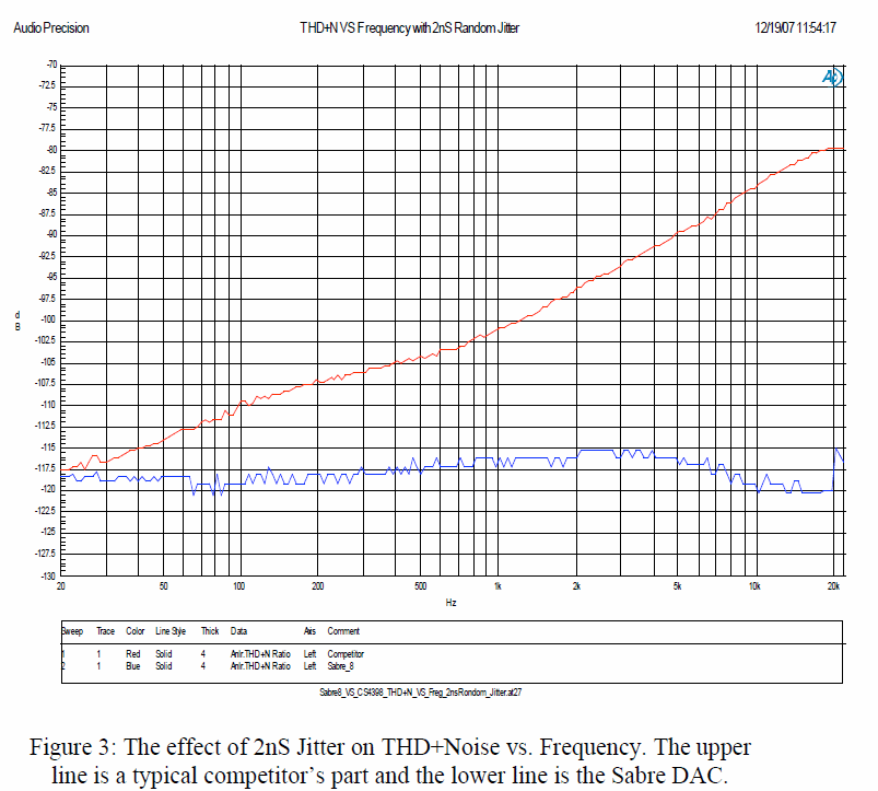

Øyvin, this question was answered long ago. Here is my post 211 from 28th March 2011:
"Here is my perspective on the impact of jitter on the exaU2I output. The clocks are responsible for about 2ps of jitter. The FPGA causes about 40ps and the GMRs another 100ps. This would add up to about 108ps on the exaU2I I2S output. Let's assume that it is 20 times more - 2000ps. Here is the jitter sensitivity for Sabre DAC to 2ns of jitter. I don't see any reason to be concerned even if two stages of GMR are as used as presented by RayCtech on the previous page of this thread. "
This is a worst case scenario. Third parties have attempted to measure the jitter and have come up with readings between 40 and 100 ps. We base our modeling on the worst-case scenario.

Thanks for the graph, but it does not appear to be a measurement of the exaU2I. The red line, with higher jitter, is labeled as "a competitor's part" while the dark line, with consistently low jitter, is labeled as "SABRE DAC" ... where is the graph for the exaU2I I2S output?
I think the key point here is that people can look up the part specifications themselves, but they do not want to base their decision on general data sheets, and they do not want worst case models. It seems that people are asking for actual measurements with test equipment designed to indicate jitter.
Forgive me if such test results have been published earlier in this thread. If they have, then might I suggest putting them on your web site since people seem to be remiss to scan this long thread for such information. If the results are there, I'd appreciate a reminder (I may have missed them the first time through).
The graph indicates the ES9018 tolerance to jitter. Please see the original discussion starting on page 22. The worst case scenario for exaU2I is much lower than the 2ns jitter impact indicated in the graph. Further the measurement of jitter is not straight-forward and easy.
What matters is not the jitter on the exaU2I output, but the jitter level at the receiving end - the DAC. For example some USB to SP/DIF devices claim 3ps jitter. This is possible under lab conditions on the near side of the cable. By the time the signal is delivered and received the jitter reading will be off by nanoseconds.
Instead of relying on measurements that will be irrelevant because the impact of the receiving end of the I2S connection is not known, we use the worst case estimate and we make sure that it is within the jitter-cancelling capability of ES9018. Than we evaluate the jitter-related artefacts in the analogue output. It is more pragmatic to verify the end result rather than speculating on measurements that are partial reflection of the reality.
Our measurements on the analogue end correlate with subjective listening tests done by users. This gives us confidence that the balanced approach that we've taken between minimizing noise by using ground isolation and accepting jitter caused by the ground isolation is paying off.
I am not saying that a certain level of jitter/noise is acceptable. exaU2I implements a balance that we believe is optimal. My advice to users is to believe to their own ears. Consider also the opinions of users that have first-hand experience with the device.
