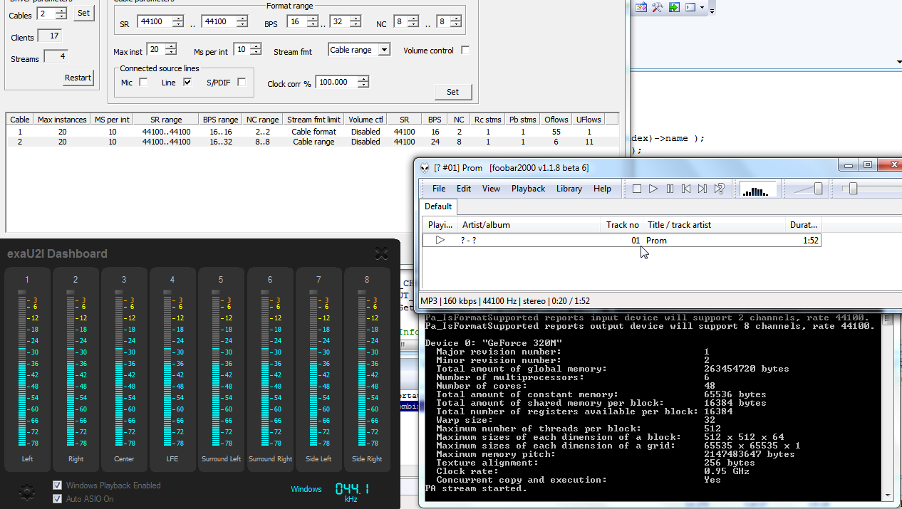

Windows Playback Enabled / 8 channels / VAC
Hi exa065,
I'm trying your great exaU2I and my CUDA software FIR channel divider now. and I have some problem. (on my side)
If you could please help🙂
My configuration:
(1) foobar 2000, to output Virtual Audio Cable "Line 1"
(2) My channel divider records from "Line 1" for L/R, 2ch.
(3) My channel divider playbacks to "Line 2" for L/R x 4 way = 8 channels.
(4) exaU2I Dashboard looks like reading 8 channels. but, please see attached, channel 3,4,5,6,7,8 shows same signal as channel 1,2.
This program was used for Emu ADAT (ASIO 8ch) before, it's OK. but now it outputs through VAC.
And you should tried 7.1 channel playback - VAC 8ch cable - exaU2I already.
So I think "How to use VAC" should be the problem.
I'm using PortAudio library, and it does not allow to use DS / ASIO at same time. So I have to use "Line 2" VAC from me to exaU2I.
thank you for great product! regards,
