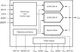

I wonder if I can get some opinions about a nutty idea I just had.
Is there any merit in feeding my stereo DAC that has eight DA chips with eight I2S streams via the exaU2I?
I have the Audio-gd REF7 ºÍ§Ó*µ响. I really like the sound signature of this eight piece PCM1704 R2R mono chip but it does seem to be very sensitive to jitter.
The REF7 is fed by SPDIF and has a jitter reducing DSP module ([FONT=&#26032]http://www.audio-gd.com/Pro/dac/DSP1/DSP1ENspecs.htm Two-channel Digital Interpolation Filter and data in-phase processor for digital audio),[/FONT]that takes I2S, upsamples if you like and splits I2S into left and right channels for the mono PCM1704's (four on each side).
I guess Foobar can use VST (Virtual Studio Technology) and DSP's to create four left only channels and four right only channels.
If these were taken out of the exaU2I by identical wires to feed each chip discreetly would it work?
If it makes music I wonder if you might care to speculate which will sound better.

Maybe exa065 should have answered this - but I take my chances and I hope exa065 corrects me if I am inaccurate or wrong...
Your question started me thinking and as I have experimented a bit with the exaU2I I believe both PCM1704 and other DAC´s could work as mono DAC´s with a correct configuration of the exaU2I ASIO driver 😀
The PCM1704 could be driven directly by the exaU2I as you can set up the ASIO driver to output Left channel for both channels of I2S channel 1, then Right channel for both channels of I2S channel 2.
In this case you could have full 384k sample speed support as it uses the 4 channel mode of the exaU2I.
If you map I2S channel 3 and 4 like channel 1 and 2 you would double the number of outputs and could drive additional DAC chips directly, but now the 8 channel mode of the exaU2I are used and the maximum sample rate are lowered to 192k.
In the case of the PCM1704 it should handle samplerates up to 768k, but I do not know if this 768k in as in mono or stereo.
When using the exaU2I in 4 channel mode with support for 384k the PCM1704 will be feed with up to either the full speed or the half speed of the supported sample rate speed.
This will also act as a "kind" of upsampling as the PCM1704 now will receive the double rate of the data as two Left or Right samples (identical) will be sent to the DAC, but without any damaging upsampler with dither or any digital filters with damaging pre and post ringings etc..

The PCM1704 have a pin to select inversion of the data so balanced outputs are easily implemented.

The optimal setup with the exaU2I and the PCM1704 may be as follows:
1. Galvanic isolation of the USB, and a local 5 volt power supply for the exaU2I.
2. Connect the PCM1704 chip inputs directly to the exaU2I by bypassing the GMR I2S galvanic isolation and with its own + and - 5 volt power supply.
3. Use the automatic LSB extension setting of the ASIO driver and the PCM1704 will get "correct" 24 bit data (with 16 bit sources) and the Bipolar offset servo of the PCM1704 will deal with the LSB offsets below 23 bit...
This is mostly important when using the PCM1704 in the inverting mode (balanced setup) as 16 bit data then will create a 1/2 LSB error (at 16 bit level) that the PCM1704 cannot correct due to the Bipolar offset servo works below 23 bit resolution.
With this setup the only clocks in use are the low jitter clocks of the exaU2I..
My math (calculator) indicates a possible theoretical improvement of the jitter in

Thanks for the intriguing design ideas.
Its even more complicated then I had imagined.
I wonder what your math indicated, in terms of a jitter figure, with your design?

It appeare that a whole section was removed by accident when I edited the post...
A calculated improvement in jitter of up to 60 dB...
It may not be measurable by more than a few dB´s..
But I expect it would affect the fidelity...
