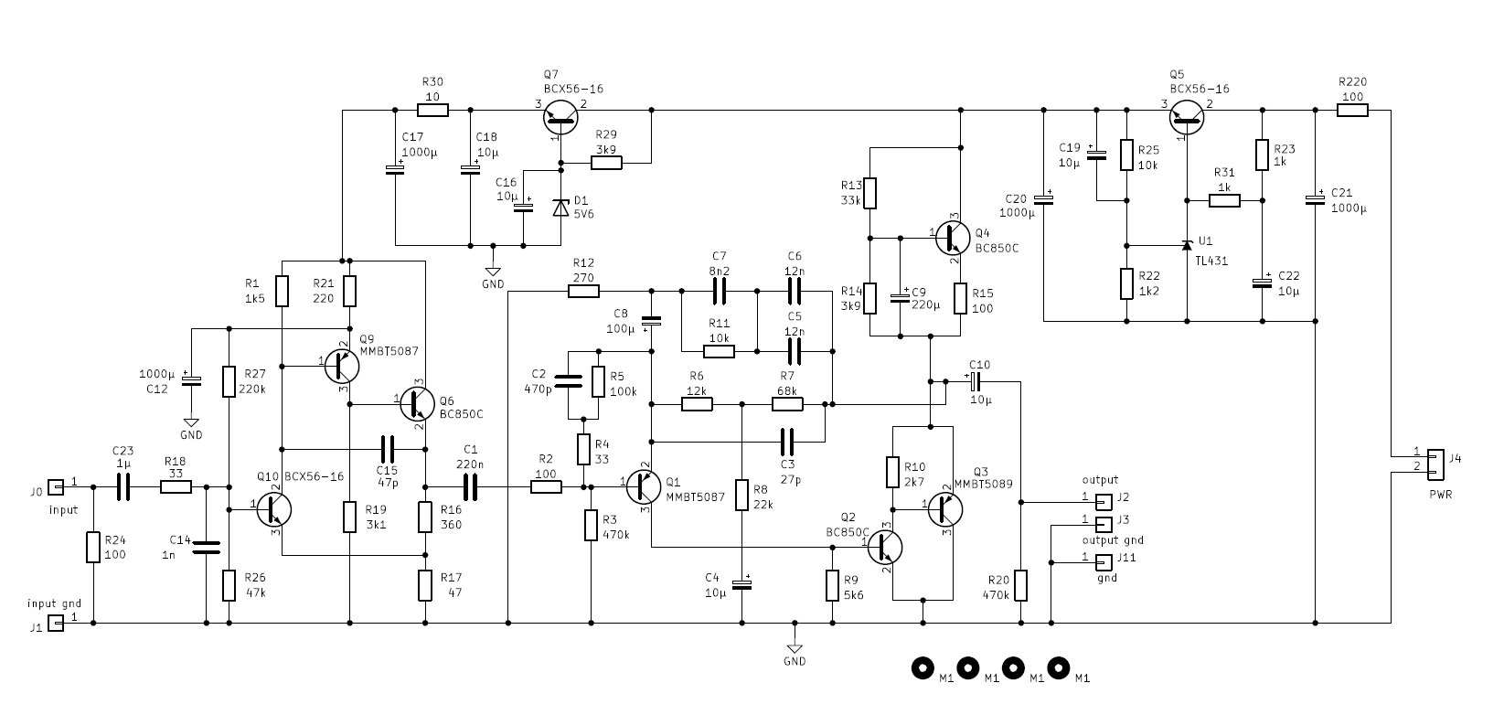

I suspect this is a case of optimistic models, looking at the datasheet for 2N2484 reveals nothing special in fact it should be very similar to BC550C or BC109C, it is also a very old component hardly available.A significant improvement in SNR can already be achieved, by using Q1=2N2484 & Q2=BC177B & Q3=BC109C. If we can believe MC12 and trust the used models?!
2SD2153 seems very good in SOT-89, if that is hard to get you could also use BCX56-16 as input transistor, it is a very common and cheap component available from most suppliers.
So I put the EXact MC pre in front if the Preconsonant like this:
We maybe choose 2SC 2240 GR and 2SA 970 GR; but with the historical bipolar transistors, MC12 certifies an SNR of 80dB (unweighted, bw2k by riaa, 5mV) - and this would now have to be verified in practice.
But your consonant looks nice, please report on the result and tell us which MC system you use. I only use AT-OC9, Denon DL103 and Ortofon Quintet red.
R30 -> 100Ohm
PSU for EXakt MC-Pre
The main thing is that it doesn't crackle, it doesn't pump -> i.e. you should really test the selected AF transistors, i.e. analyze the resulting noise and interference behavior. In the simplest case, this means listening through a fully turned up headphone amplifier.

@MartinX
I have prepared a small puzzle for us in the file attachment:
"a consonant with an exactly defined output resistance of 50 ohms, an SNR of greater than 100 dB and another special feature - can you determine the missing component sizes in such a way that the deviation of the equalization remains within the limits of +/-0.15 dB? Tell us the values."
