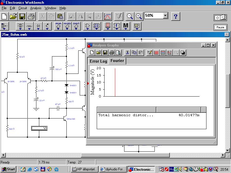

the fourier works.
let's analise with onsemi parts.
I can simulating THD between 10Hz-100kHz in my designs.
so it works for me.
