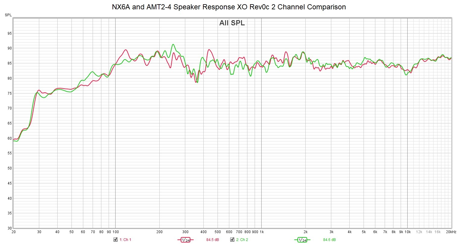

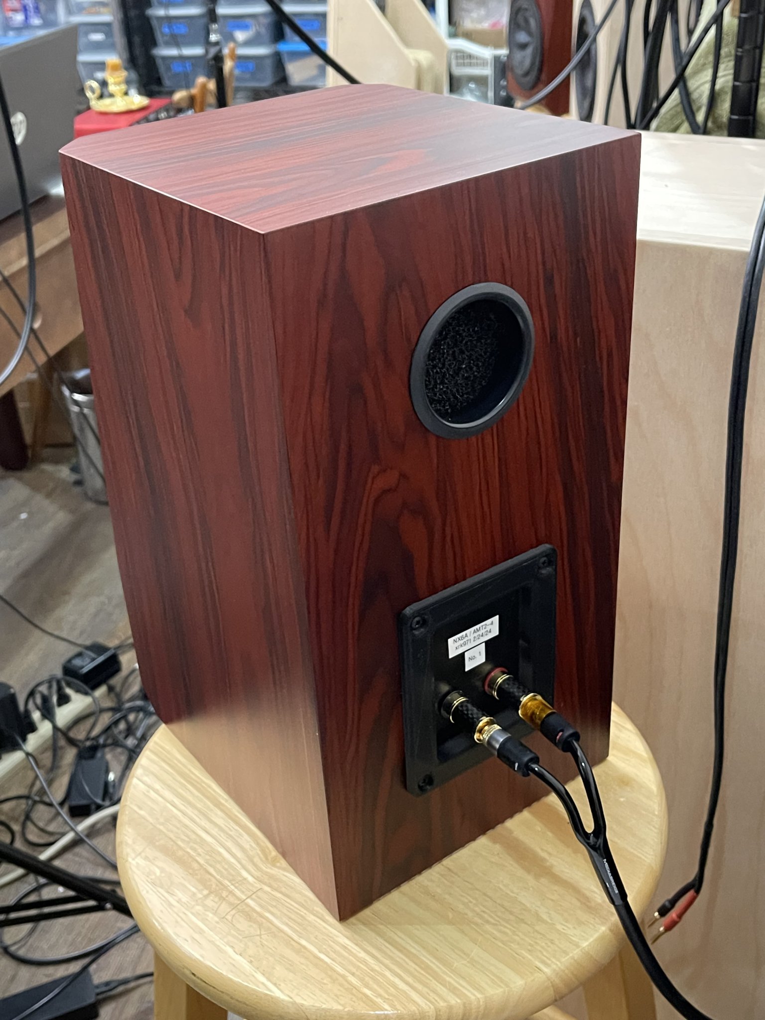

I have a strange thing to share with you guys about the behavior of this speaker using a crossover with a screw terminal block that has steel components vs no terminal block (all Wago spring clip connectors).
The red trace is the speaker with the steel terminal block. It has a bass peak at 125Hz and sudden falloff at 100Hz. Green is the second speaker with the same crossover but no terminal block.
So I put the second XO on the first speaker (thinking the behavior was something strange about the woofer). But it ended up measuring nice and smooth like the green trace. So I redid the XO1 to eliminate steel terminal block and both speakers measure basically identically now. What is the reason that the steel terminal block wreaks such havoc on the frequency response? I would never have imagined the effect to be so significant.
The both match now, plus the bass behavior is smooth and the falloff is shallow.

It is worth seeing if the measurements agree after windowing out room reflections in case there was something that went unnoticed between measurements. It's hard to explain the differences just from the impedance curve. That said, I actually recently posted this:

It’s not room effects as the measurements were made at same spot and same mic location by simple swap of XO or speaker. The absence of room effects to the changes can be seen that they have the same response below 600Hz where that effect is greatest. The only other thing was I had maybe 6in of hand twisted wire from the steel terminal block to the XO parts just to keep the wires together. Could this coiling be interacting with the magnetic fields from the inductors? It’s

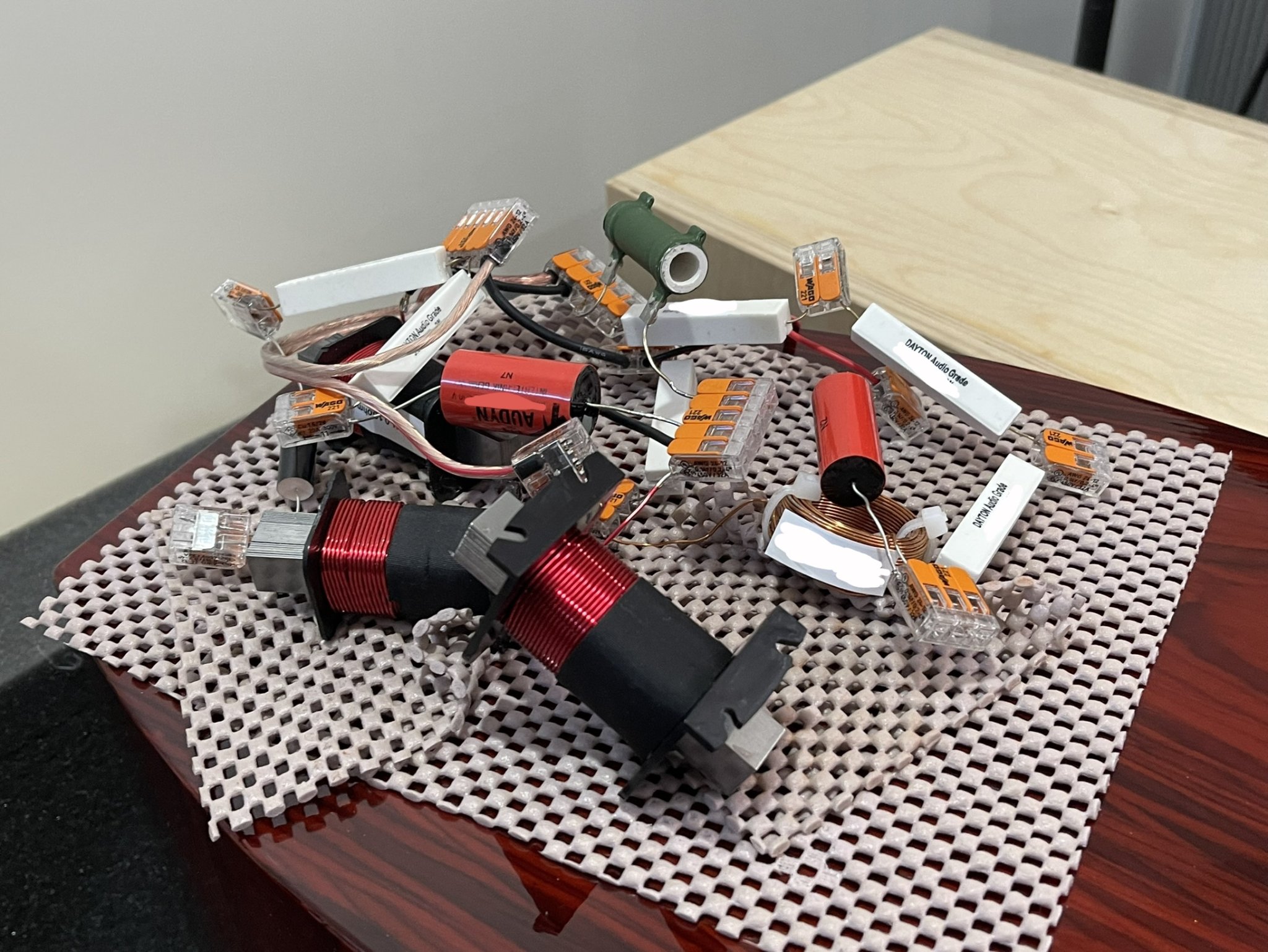

The Wago’s are UL rated for 600v and 20A. Conductor material is copper and accepts up to 12ga wires. I find them super secure and do not seem to add any strange signal to my crossover circuits.
https://www.wago.com/us/wire-splicing-connectors/compact-splicing-connector/p/221-413
With a bag of Wago’s and a kit of major LRC values, I can prototype any crossover in 15 minutes typically.
After a week or so listening to a Wago-plank crossover, I’ll convert to P2P soldered connections with zip ties and stick that inside the cabinet. If it goes forther than that, I’ll have a PCB and custom components (L and C) made.

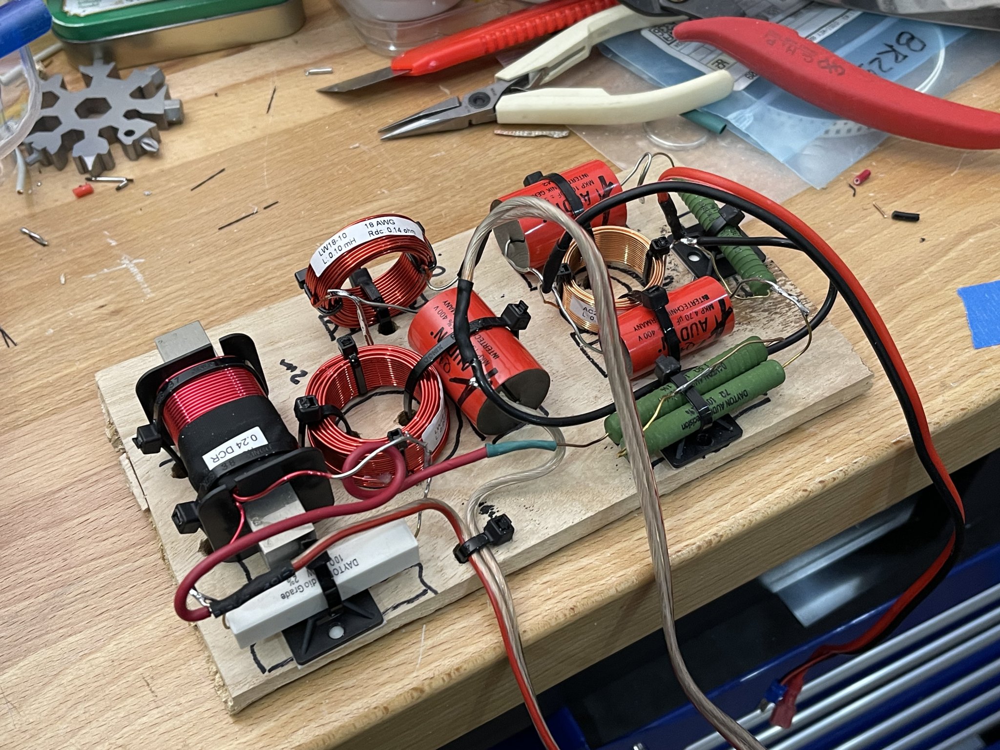

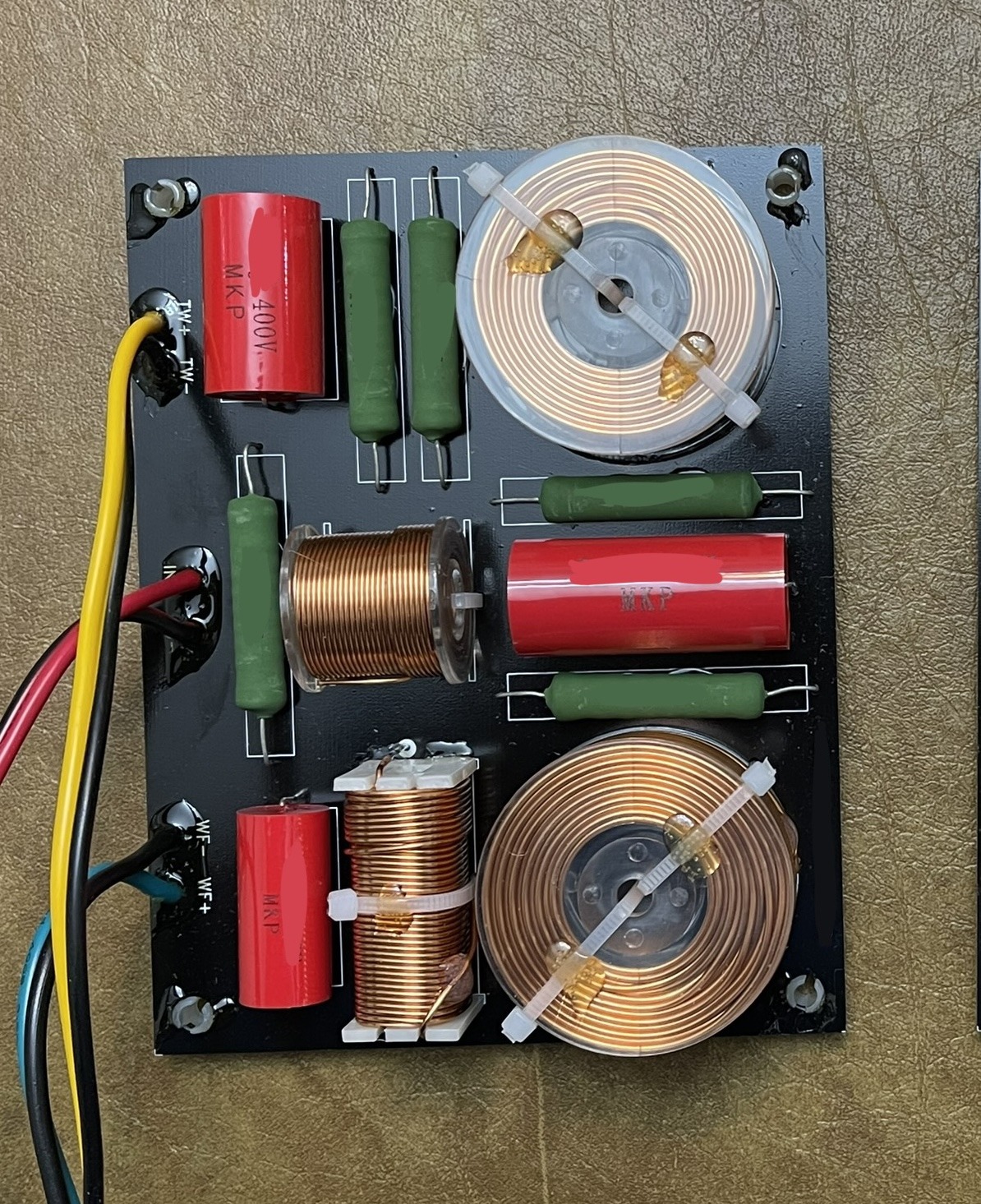

Here is what one of my typical development crossovers looks like in the Wago-plank version:

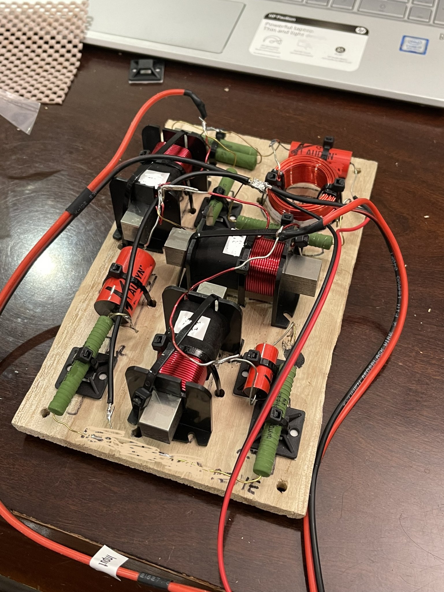

Then move to P2P soldered version:
Here is the production PCB version:

Are the clear plastic bobbin coils in the production version the custom made ones you order from somewhere or are they available off the shelf from someone? curious who.Here is the production PCB version:
I have one of those component-Wago rat's nests sitting on my dining room table atm, haha, careful that from iron core doesn't scratch the finish -eek!

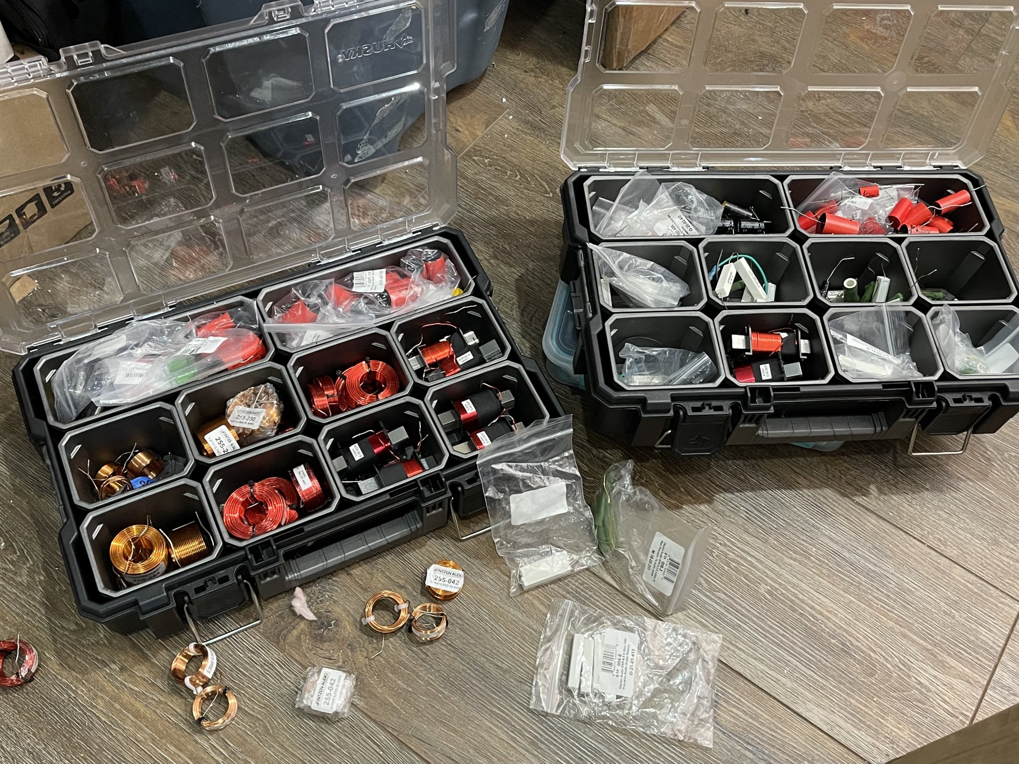

All the inductors on the production PCB are custom made. Even the capacitors are custom wound to the exact value (I am not limited by the usual values).

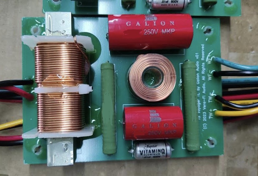

Here is the crossover that I designed for the Galion Audio transmission line speaker. Notice the custom labeling on the capacitors. The iron core inductor is also custom wound.
I finished the soldered P2P plank XO for the NX6A and AMT2-4 speaker. It’s all buttoned up and playing music now.

Even minuscule changes ro the positions or stuff in the room can make a difference. Just apply some gating to get rid of the echoes and then check the harmonics of the anechoic data.It’s not room effects as the measurements were made at same spot and same mic location
It was well controlled A/B test with only change being the XO assembly method. Nothing touched on the lab between the two measurements. So not a room boundary effect and note that it shows effects up at 450Hz, 750Hz and 1.5kHz. Well above regions of room boundary effects.
Btw, speakers all buttoned up and playing lovely music now. The soldered P2P measures identically to the Wago P2P.

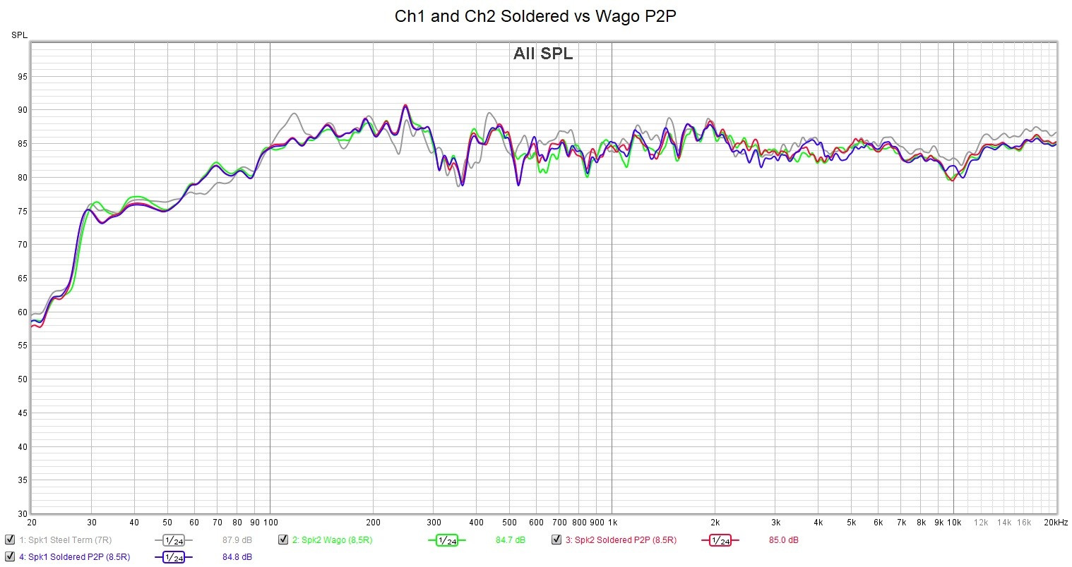

Here are the measurements of the final soldered (red, blue) XO vs Wago (green) vs Steel terminal block XO (Grey - which had 7ohms padding vs final at 8.5ohms):
We can see that the steel is the anomalous one.

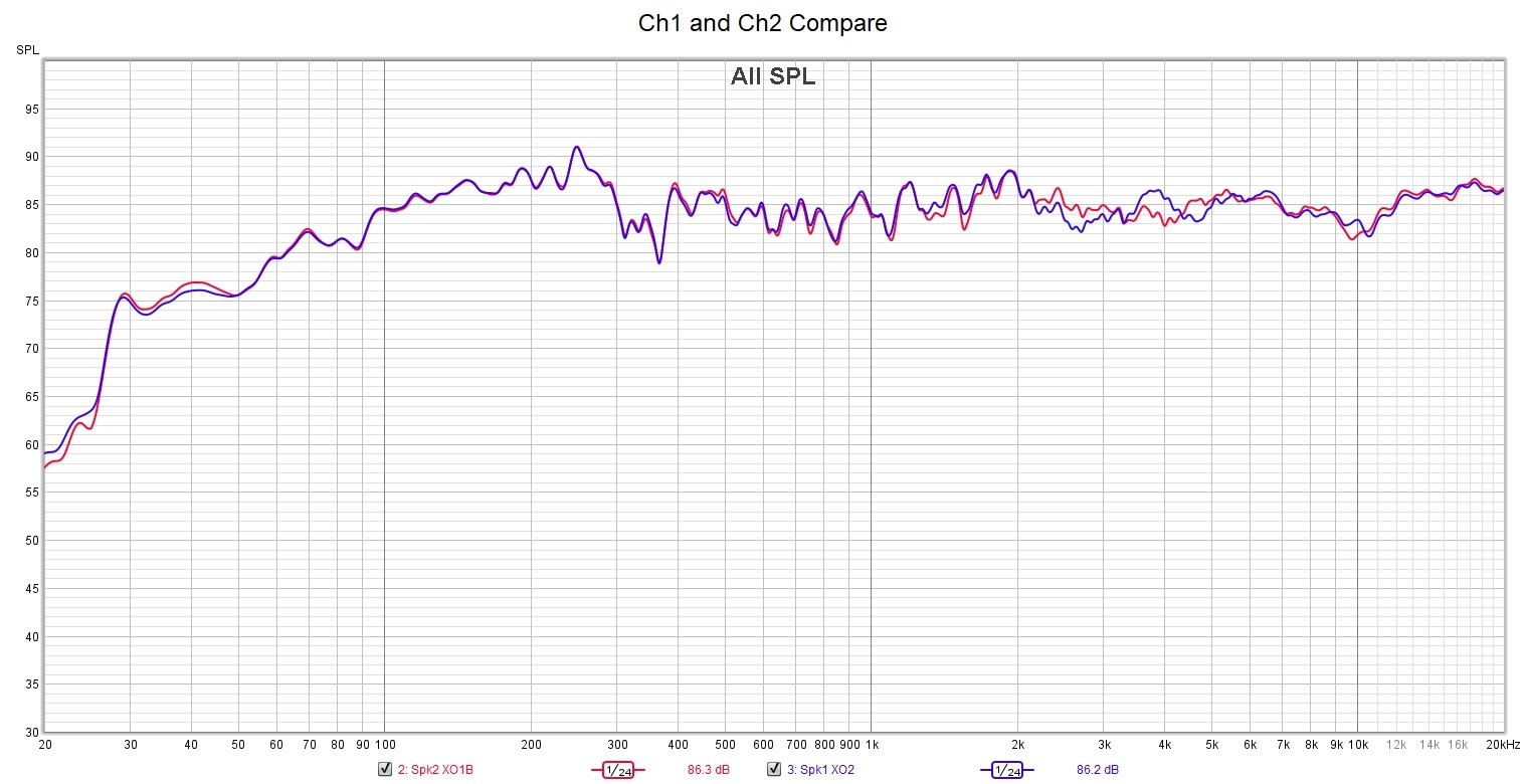

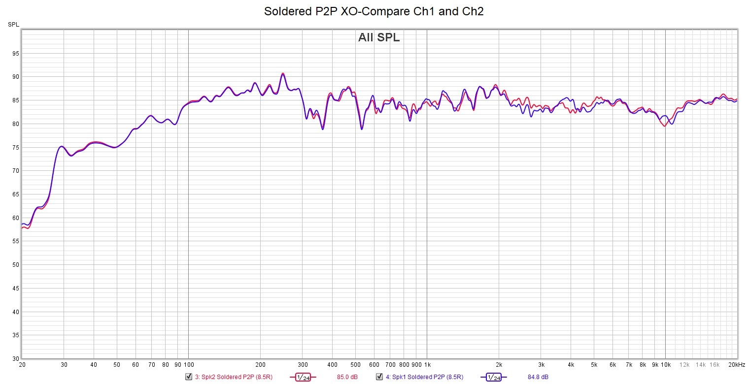

Here is just comparing final soldered XO Ch1 and Ch2 for clarity - look at the matching:

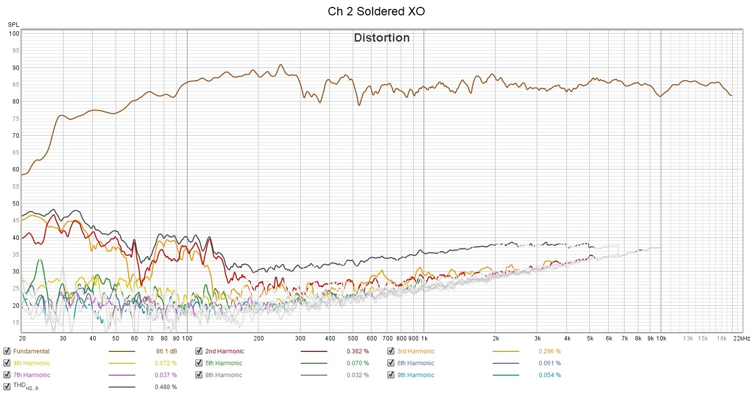

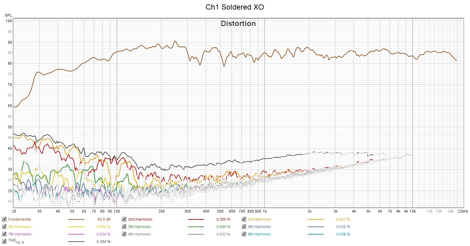

Here are the measured harmonic distortion plot sweeps for soldered XO Ch1 and Ch2, note that Ch2 the driver appears to have more inherent distortion near 100Hz, here is Ch2:
And here is Ch1:
And here is Ch1:
