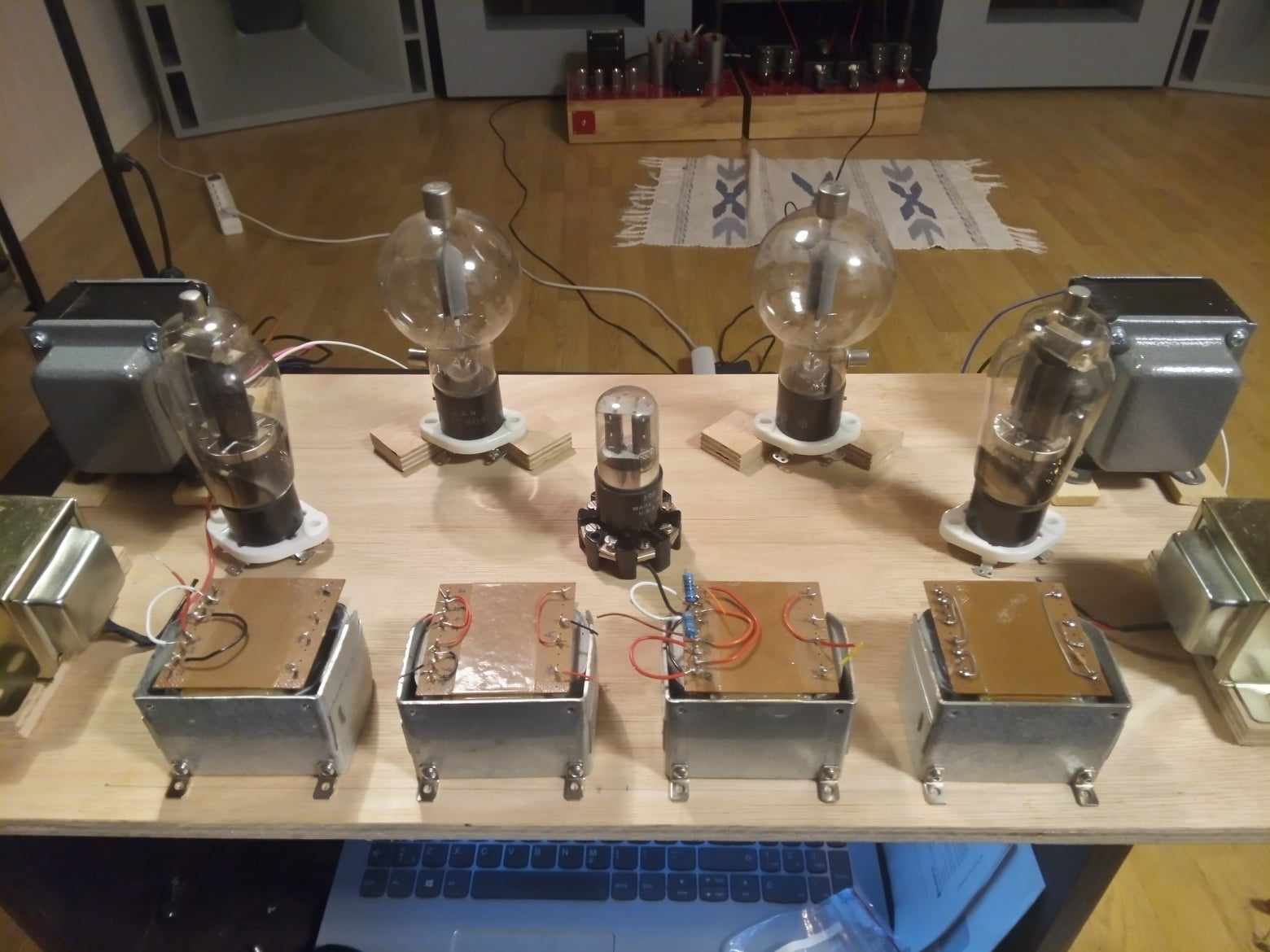

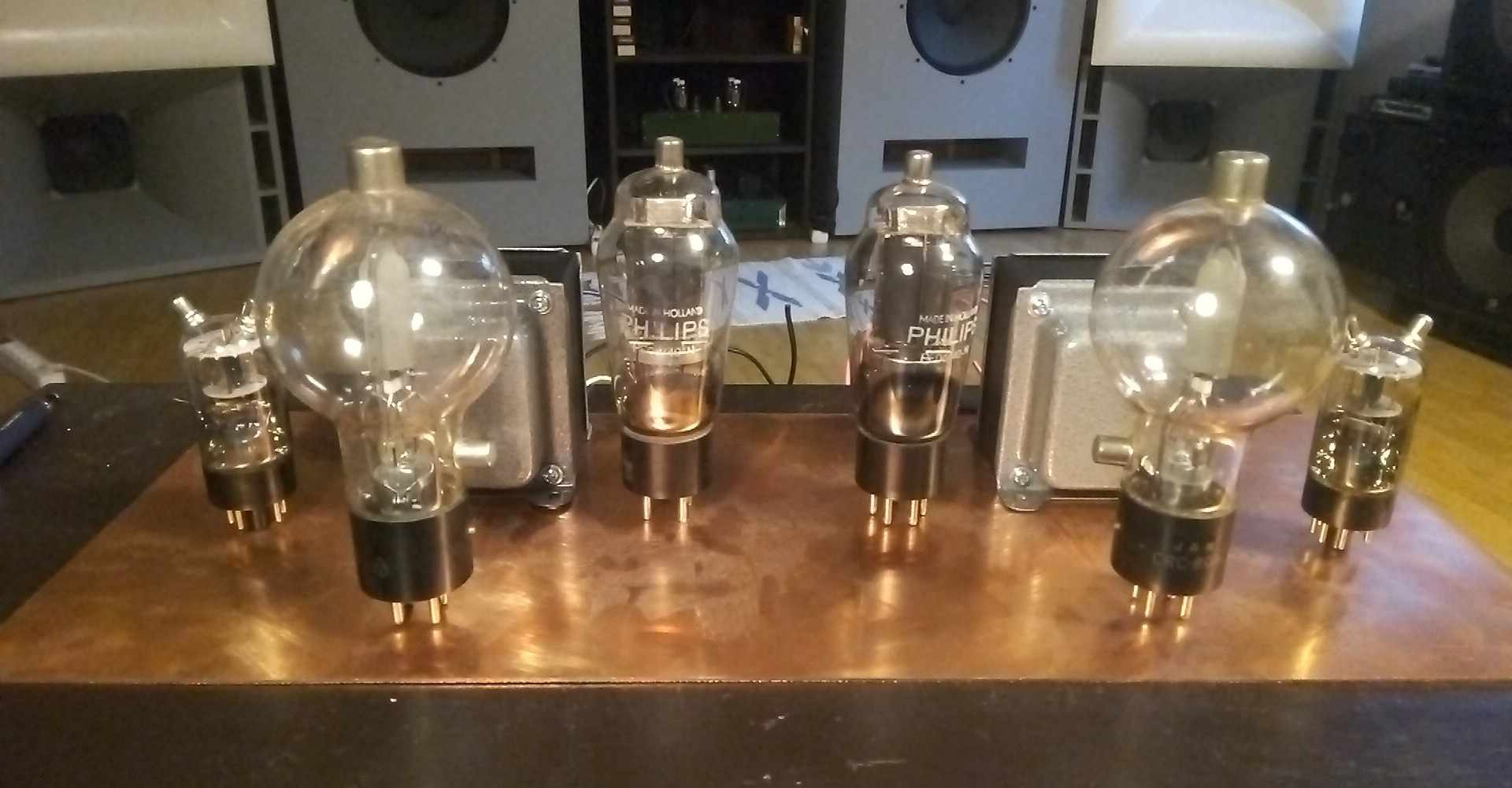

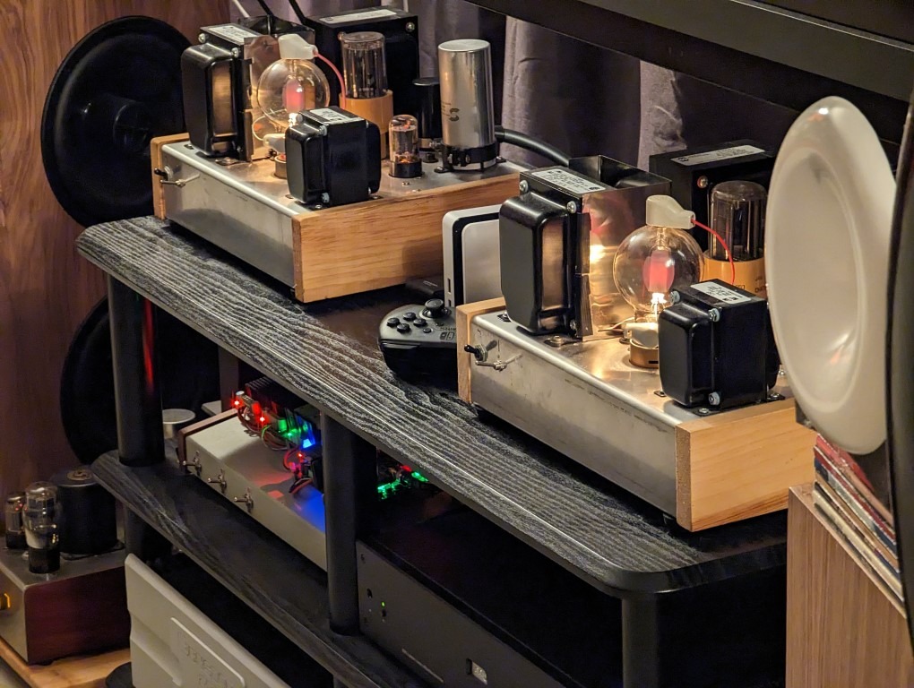

Here's a picture of the output tubes and transformers paired up with CV1135 input tubes and PE06/40N (~807) drivers on a copper sheet.
With a little imagination, I can picture this playing background music in some steampunk opium den...or brothel

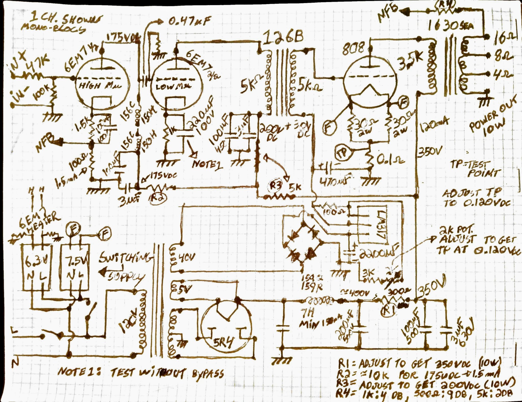

Here is the schematic but i have changed the loading of the first stage to CCS now.

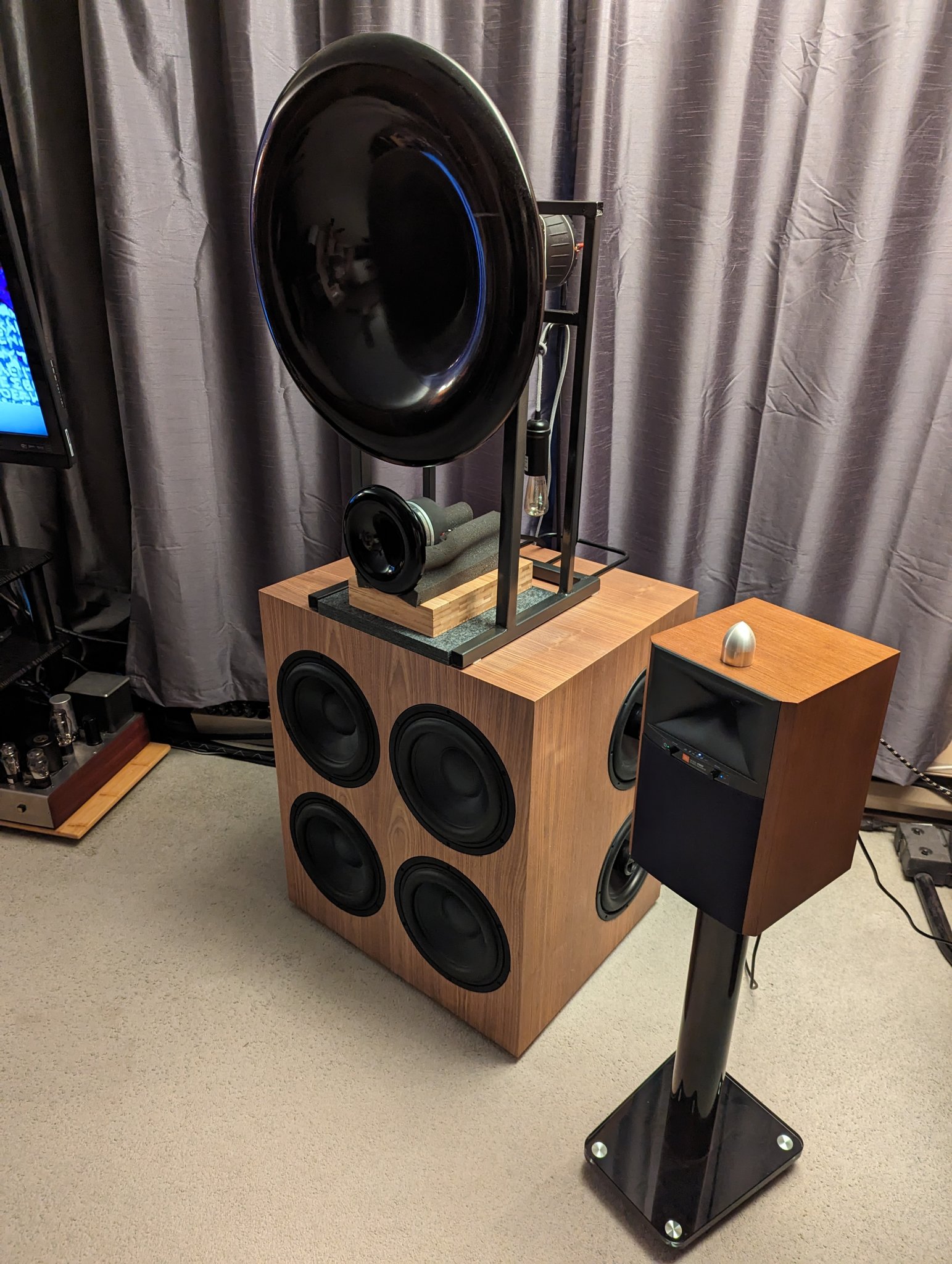

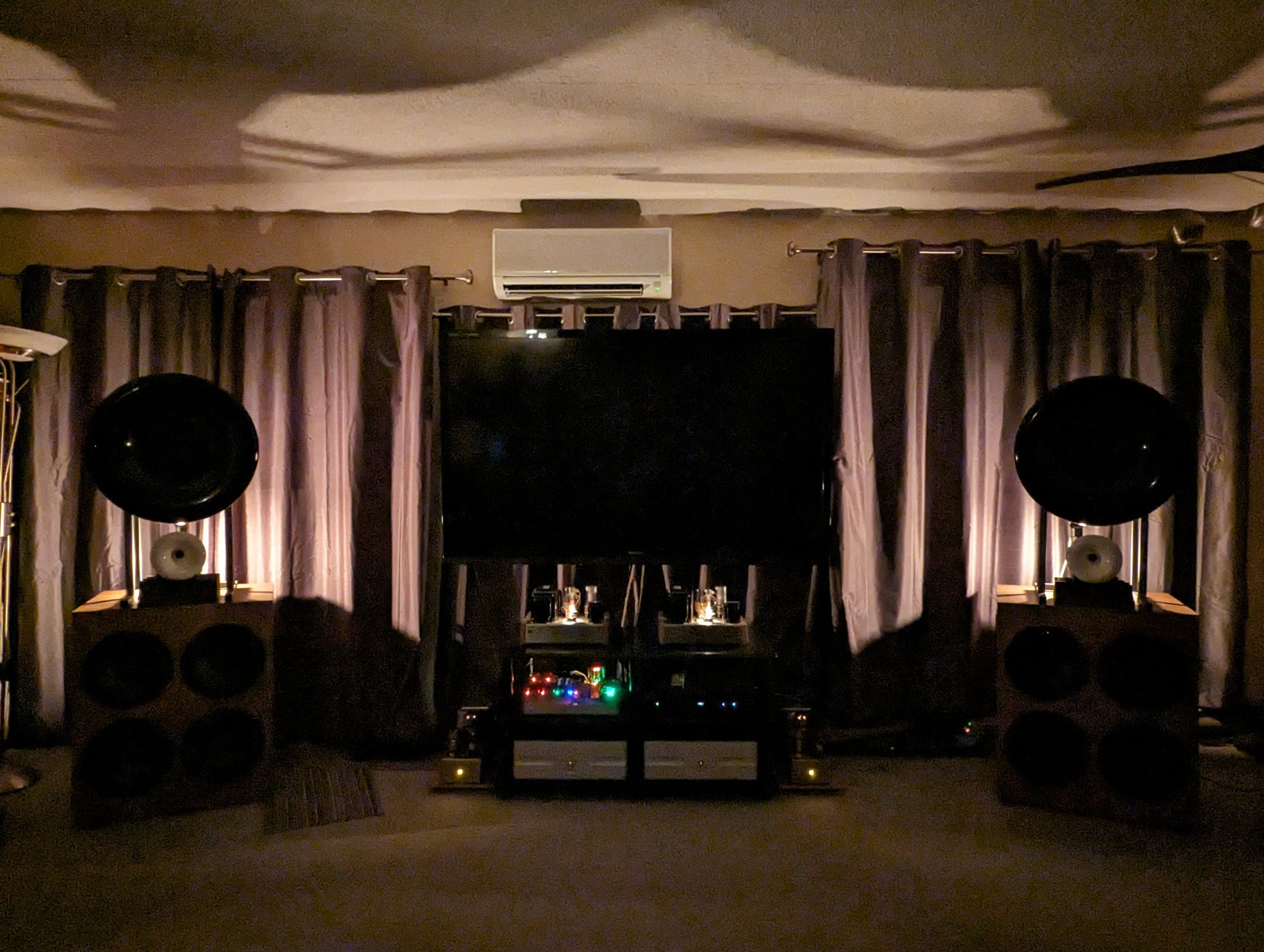

The horns are azura JMLC 1100 hz full roll back on hf10ak, mids 340hz concrete JMLC horns on BMS 4596nd. It's an active system also using 45 tube amps. I have painted the small horns black since that picture and it look better.

Looks like a an absolutely lovely system!
Interesting choice of interstage transformer, I assume you don't run it in inverting mode to cancel DC in the core?
A closer pic of the "christmas tree" amp below the left mono block would also be most welcome, there must be some interesting tubes involved there! 🙂
126b are bifilar and only work well in one orientation. My first experiment they were backward and had very limited bandwidth then I found info in this forum about reversing all my connections.
The Christmas tree is a music transport and raspberry pi player using moode audio and all Ian Canada modules. It use super capacitor and lithium battery for the spdif output. Really nice unit and fun thing to build. It feed the DEQX on the right.
That's what I though, bifilar transformers have horrible bandwidth when wired out of phase. I have a pair of LL1671 / 50mA ITs that I intend to try once I have a prototype up an running. These transformers can be wired as 1:1, 2:1 or 4:1 and the generous airgap leaves some interesting options to try. Not sure it will work very well though, I seem to recall that the 808 needs an input signal that swings from around +25-30V at idle up to 60-70V and down to -15V or so for full output and I know from recent experiments with other tubes that the Lundahls don't behave very well at the point where the grid current suddenly stops flowing.
Aaaah I see. In the picture, it looked like a tube amp with some very exotic tubes 😀

Those speakers behind does not need a lot of power ? 😉
Those speakers are a blessing and a curse: I don't really need gain in my power amps anymore, a simple mosfet buffer between the (TVC) preamp and the speakers would be perfectly sufficient for any civilized listening. As a consequence, they are very unforgiving for hum and noise issues and only a few of my old DIY amps are quiet enough to actually use.

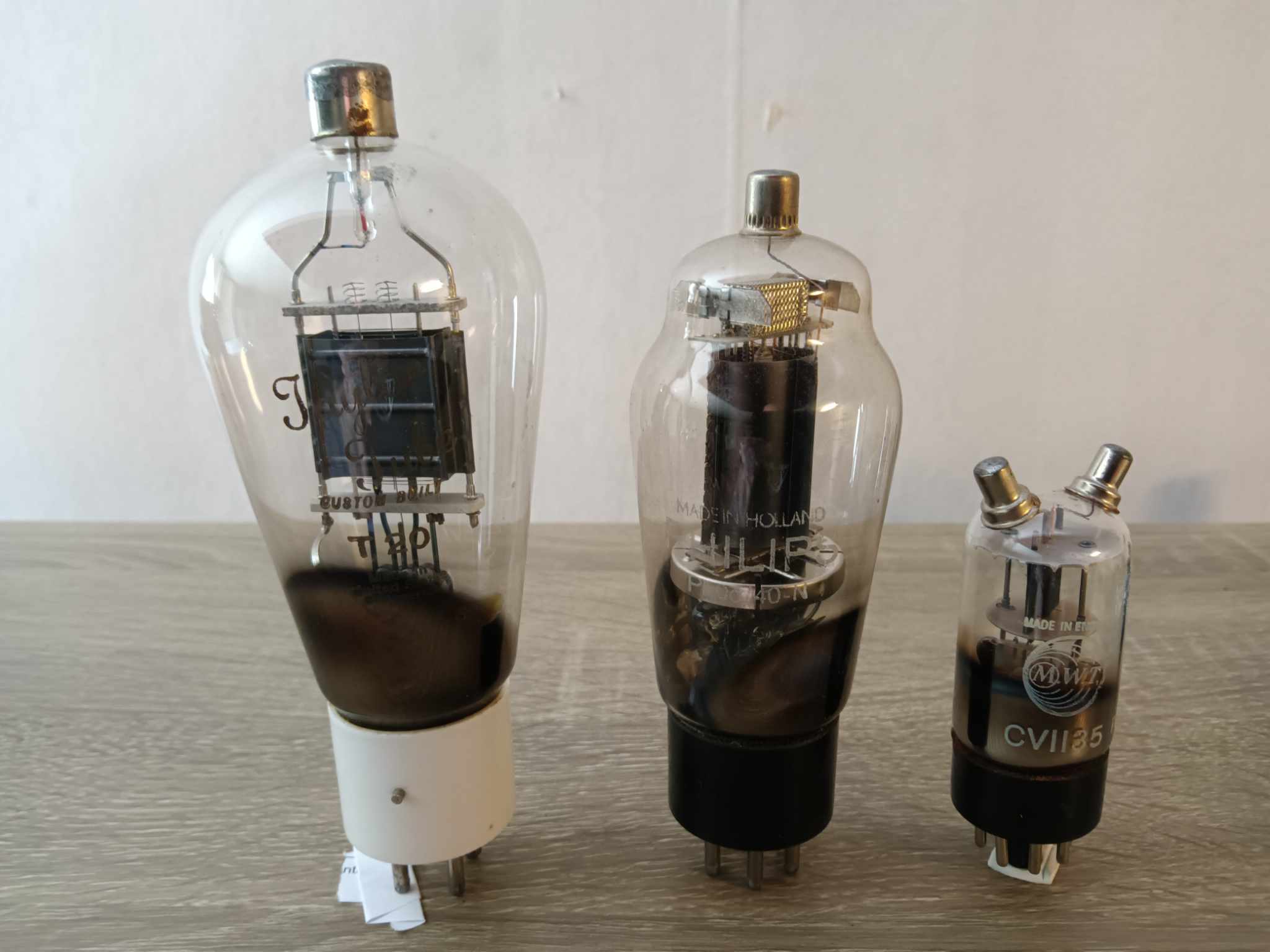

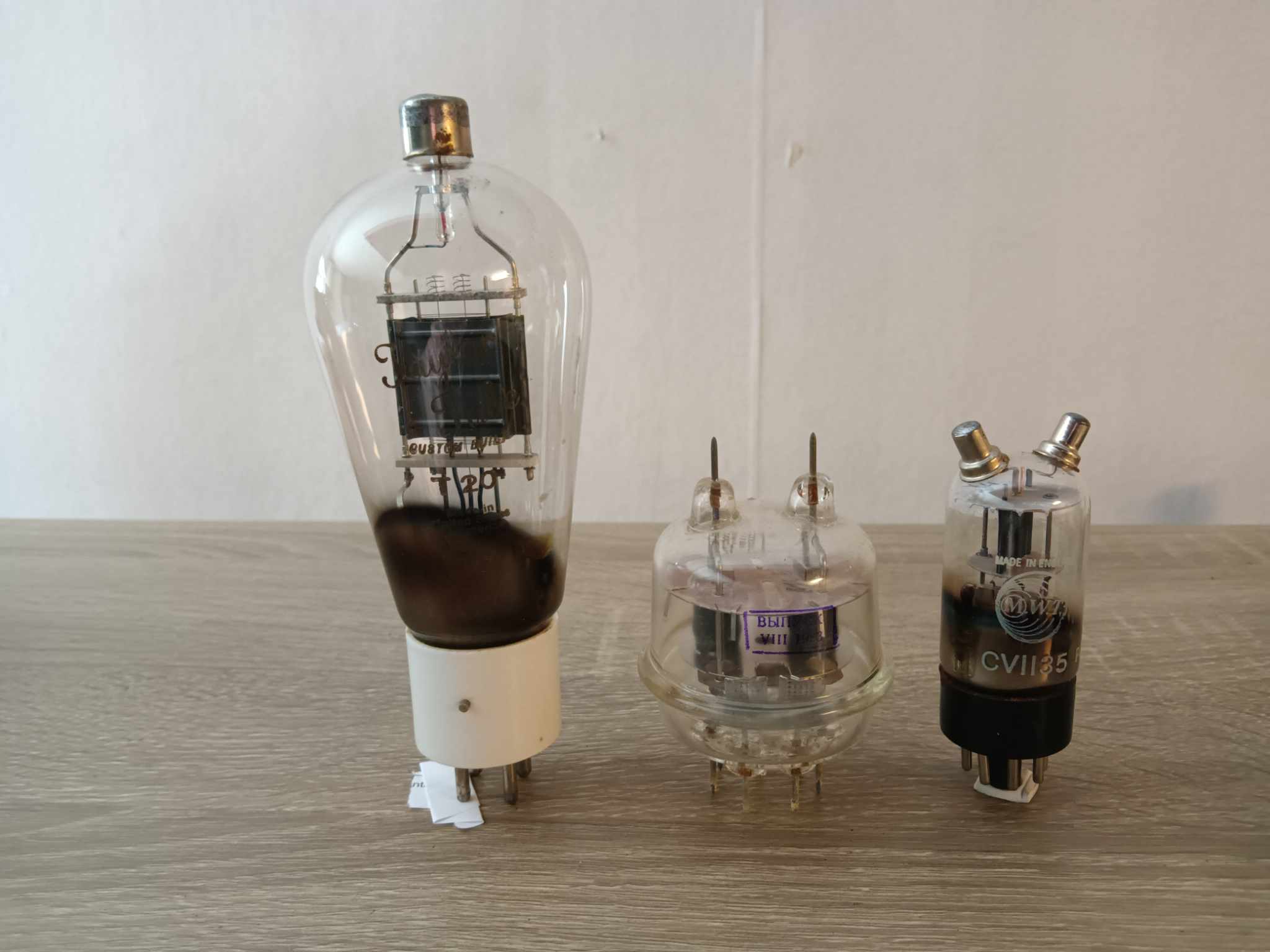

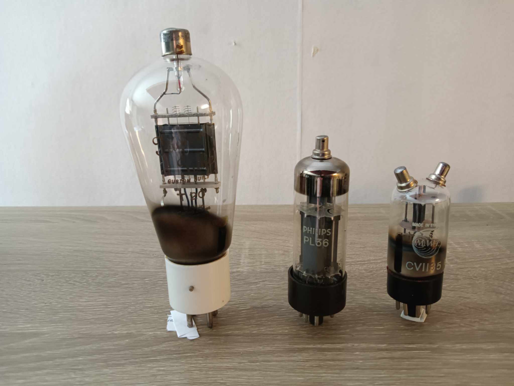

Here pictured next to some potential candidates, first out PL36 as driver and CV1135 as input tube. A decent looking combo and the PL36 has higher gm than most other octals :

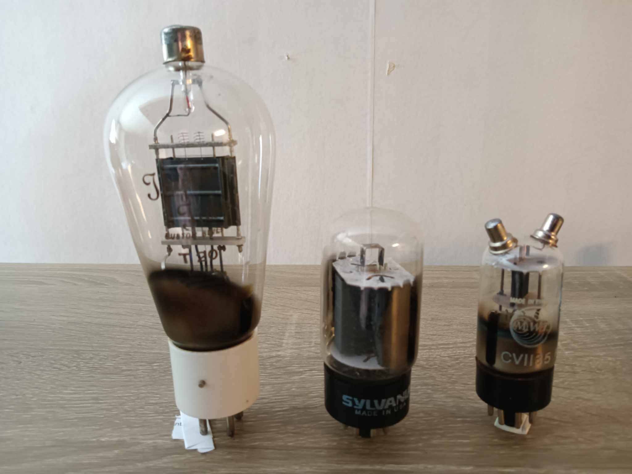

6AV5GA and CV1135, also quite nice looking but a bit low gm for cathode follower duty:
807, low gm and already done once:

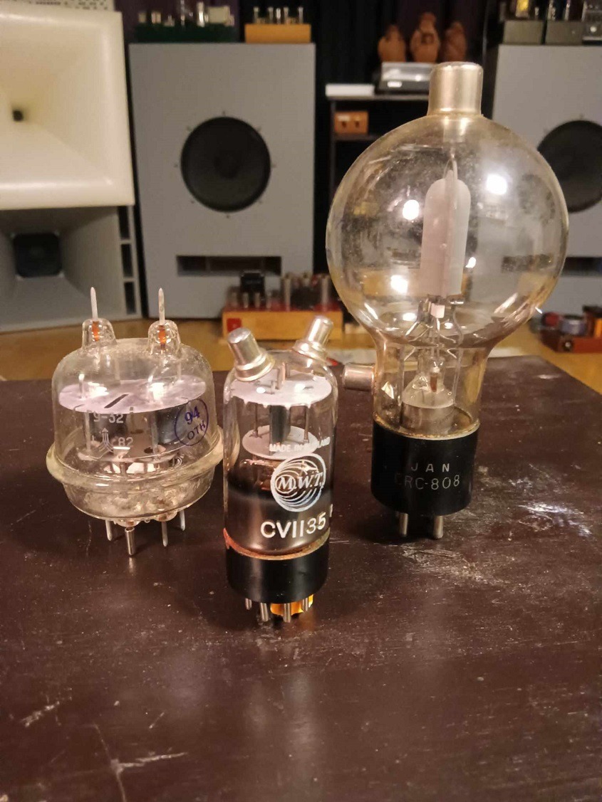

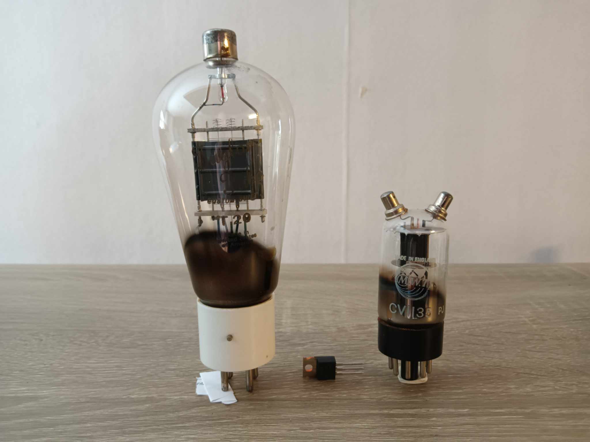

An odd one: the russian GU32. Half-decent gm with both sections in parallel but not very good looking:

Compromising the vintage look by using more modern tubes with (much) higher gm probably be very benificial. I just took something from the shelf for the picture but let's pretend that the noval tube is a 6E5P, PL802 or something like that:

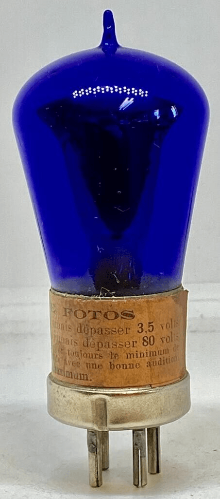

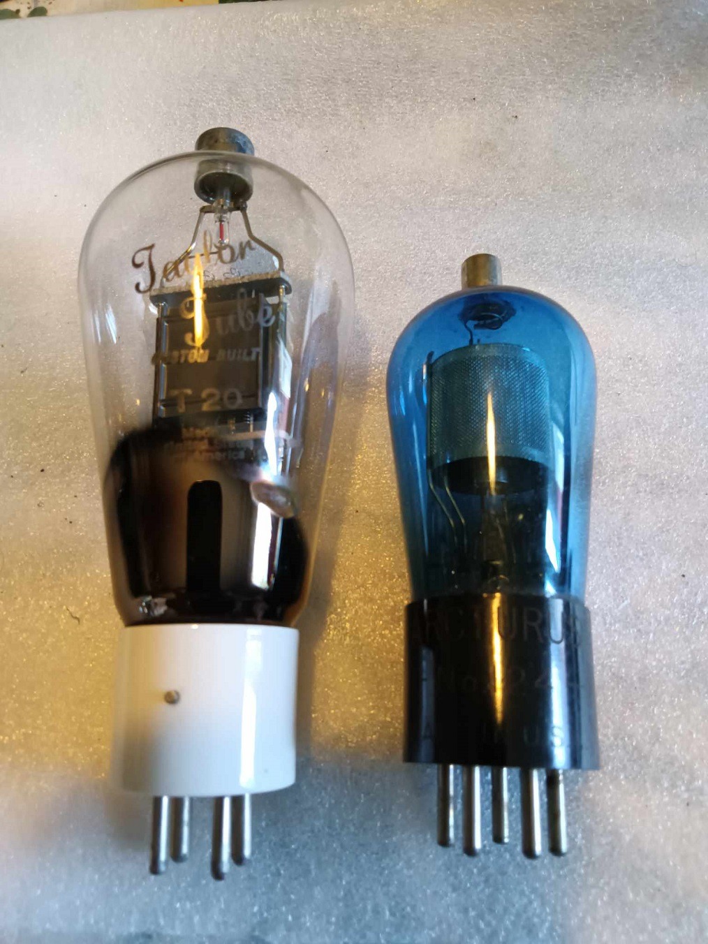

Long ago in France we had a company called RADIOFOTOS GRAMMONT which produced "blue" glass tubes...
Beautiful tubes! Never heard if that brand before.
I was akeen to think that the PL36 was the nicest mate aesthetically speaking to your 808... But OK : the 807 is fine too
PL36 would also make better cathode followers but the limited number of pins on the PSU/amp connector more or less forced me to pick a tube with the same heater voltage as the input tube.
