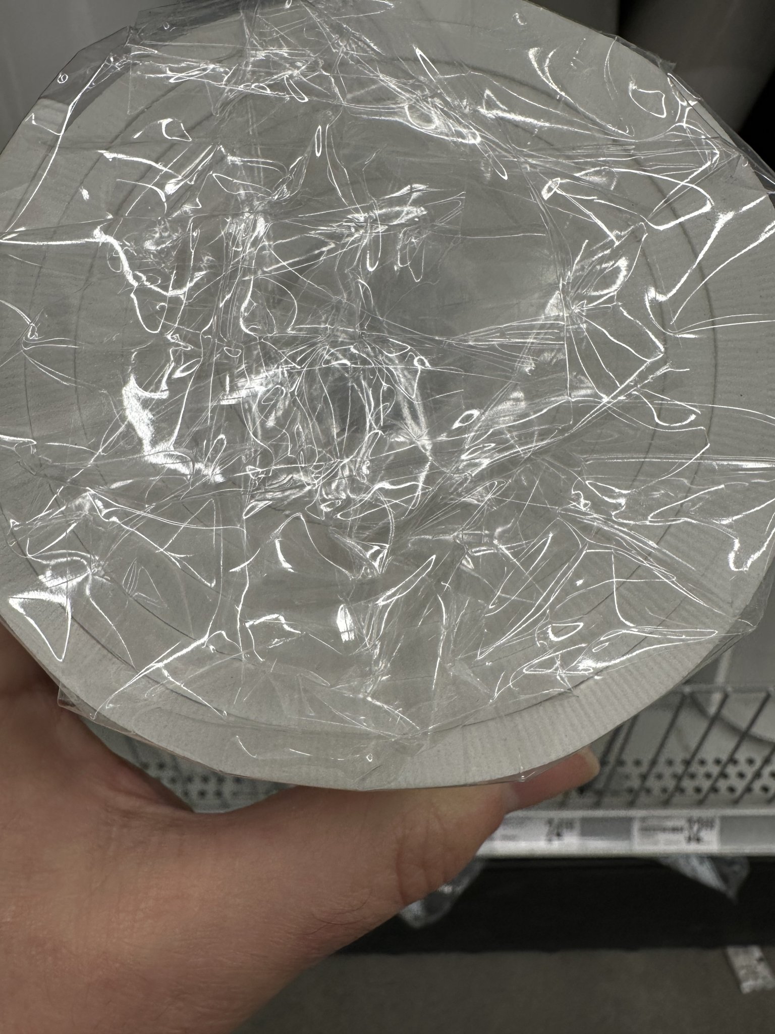

So... I found some foam that might work @ Michaels... Only in Canada...24 in X 60 in X 4mm !!? They have 6mm as well...Dollarama or equivalent. Go to an arts and craft store and pay WAY more.

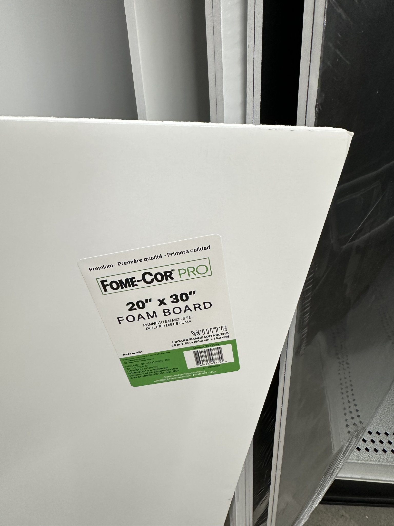

Also foam board for the enclosure. Does this look like the right stuff?
I have yet to go to Dollarama, at least if this is ok I will know what to look for 🤓

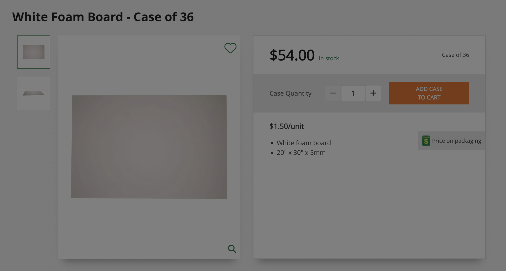

Were you thinking of EVA foam for the curved inner wall? Best to use paper face foam core because it has structural stiffness. Score lines to make it bend.
The premium foam core uses thick smooth paper stock almost like cardboard. Elmer’s brand is $5/sheet but worth it. The speakers are more durable and look nicer. Also comes in multiple colors.
The dollar store stuff is very thin by contrast and may delaminate from humidity in a few years.

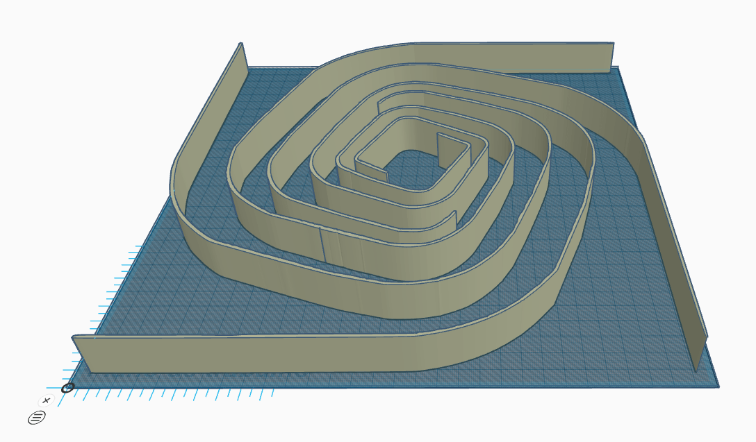

The Cornu spiral is one of my on hold projects, I will start one as soon as possible. I have searched the thread and also the forum, but did not find an STL file for 3Dprinting, so I have started working on a 3D sketch to make the Cornu printable:
It's not tested yet. I will try to test it and make 2 parts design that can be divided in many parts so it can be printed on a regular 22 x 22cm FDM bed printer.
I like your ambition but I have to ask what you feel the advantage in 3D printing is?
Also, you seem to show a gap between the edge of the baffle and the spiral. Again, can you help explain what that is for?
That extra bit on the template was there to make layout easy, there is no real gap there, Just a foam core thickness inset to make gluing less cumbersome.
What I like about 3D printing is the possibility of reproduction for many DIYers around the globe that may not have the skills (or space) needed to do woodwork, or even foam work. I know that foamboard make this project very accessible to everyone, but even though it does require some manual skills to put it together.
The gap is not there effectively, I have just put a square under the guts of the cornu to make it visible. I have some 1.5" drivers that can be a good test for a "nano cornu", really desktop sized.
But my plans are also expandable for the W5-2143 drivers that I have laying around here in the future.
Basically, my target is fun, and once finalized, share the STL with the community so anyone can use it in any possible way.
