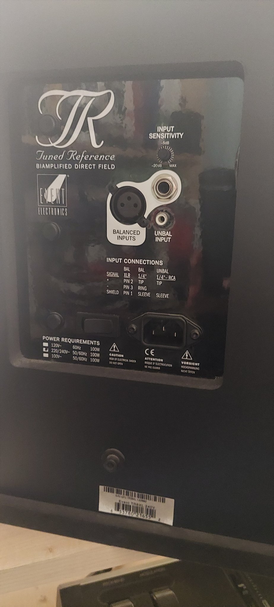

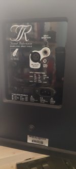

Event Tr8 XL monitor loud electric click/high freq pop, when switched on, Occasional feedback. Any Advice would be great please. Thankyou
I have a audio interface that is nearly obselete with drivers on their last legs. I wondered if occasional driver digital overload, could have damaged the monitor?
As a novice. Was going to have a quick look, to see if anything obvious fuse or wire, wondered best/easiest way to also get in them. Front woofer removal or total wood front panel prise open? As back is sealed.

You'll have to get into the front panel by prying with some heat. Do yours have the front trim rings around the woofers? Should be easy to just remove the woofer, but be careful with the ring around it. They crack and break very easily and are hard to get replacements for.
The amps are usually chip based ie LM3886 or LM1875. Not very hard to work on, but the way they're put together can make things tricky.
Hi . Thankyou for your reply. The monitor is now unplugged from any xlr connection and stood alone with just the power lead in, makes that same massive deafening high pitch noise, for a second, when switching on. There is noise going on if i put my ear to the woofer cone, but it has fed back on its own, recently, without any connection to anything, so assume something possibly wrong with active amp ? Or dodgy earth wire or something? (I say, without having a clue lol)
There are no switches on front, all on back.
And yes, because you need to get at the amplifier asy, you'll have to pull the woofer and tweeter to get at the screws inside holding the mounting plate onto the back. You'll need a set of short screw drivers and a ratchet/philips bit. Do not touch any of the level adjustment trimpots on the pcb. They're for the crossover and set for your specific driver levels.

It does sound alot like bad electrolytic capacitors in the power supply filter stages charging at uneven rates, causing temporary instability when the power is turned on. It may just be bad connections on the main filter caps on the amplifier supply rails. I vaguely remember many years ago working on some Event monitors with bad solder connections on the 2 large main filter capacitors. Without looking through my old notes, I'm almost certain that's what your problem is. That of course entails removing the amp plate to repair, but its probably just a matter of resoldering a bunch of connections.
Good luck. Hope you get it worked out ok.
