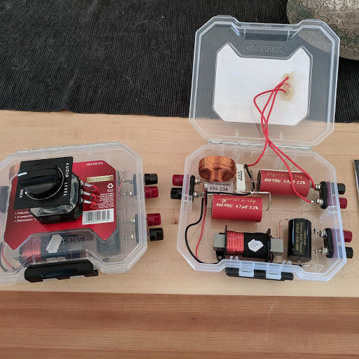

Geezus - sorry to hear about your medical issues - hope all is “better” now?
Love the crossover enclosures.
Thanks Chris. Yeah, after three rounds of antibiotics the leg finally healed. MRSA is nasty stuff. Wasn't able to do a veggie garden this year, etc. I'm really glad I'm able to get back to doing fun things again.

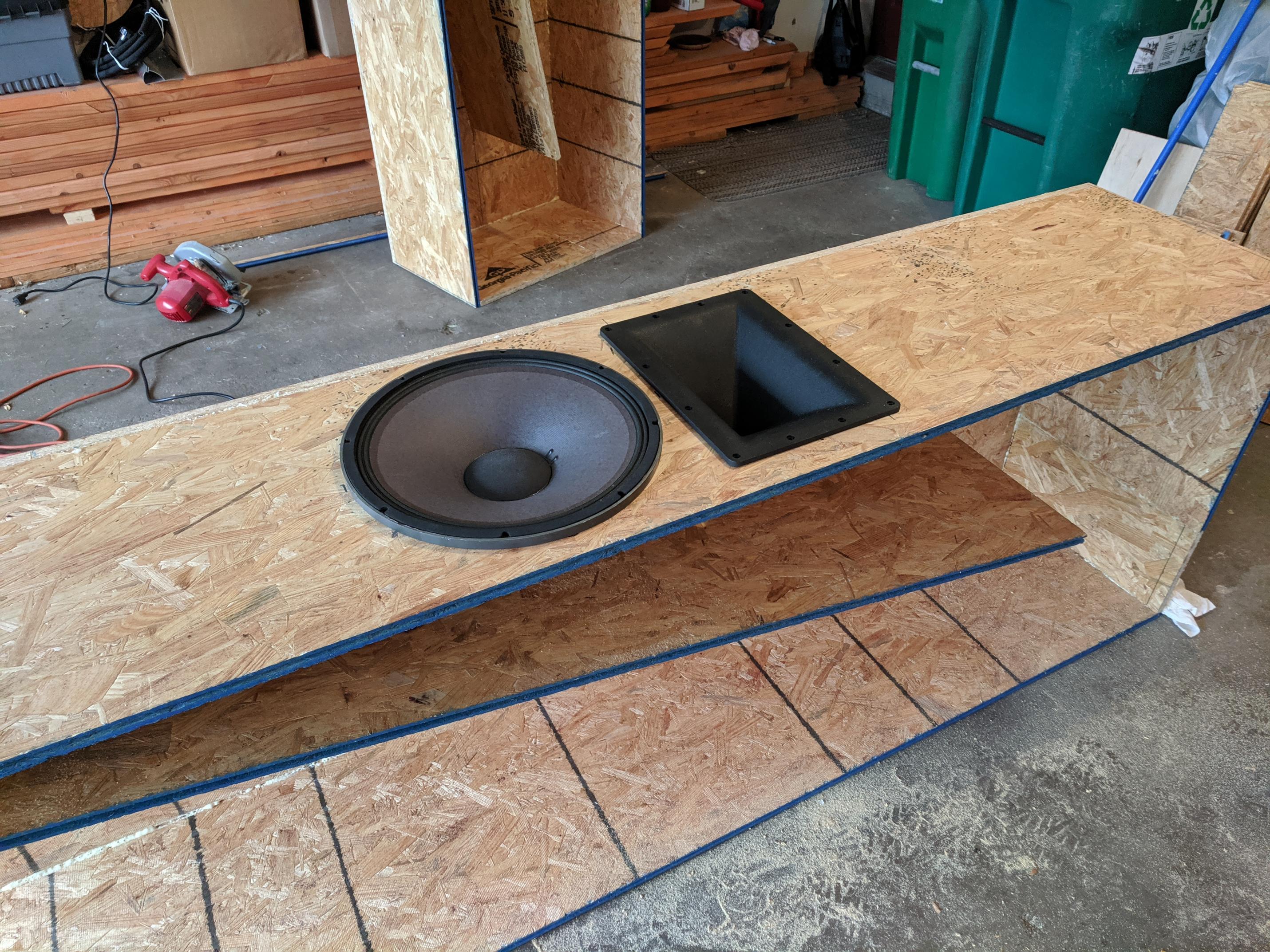

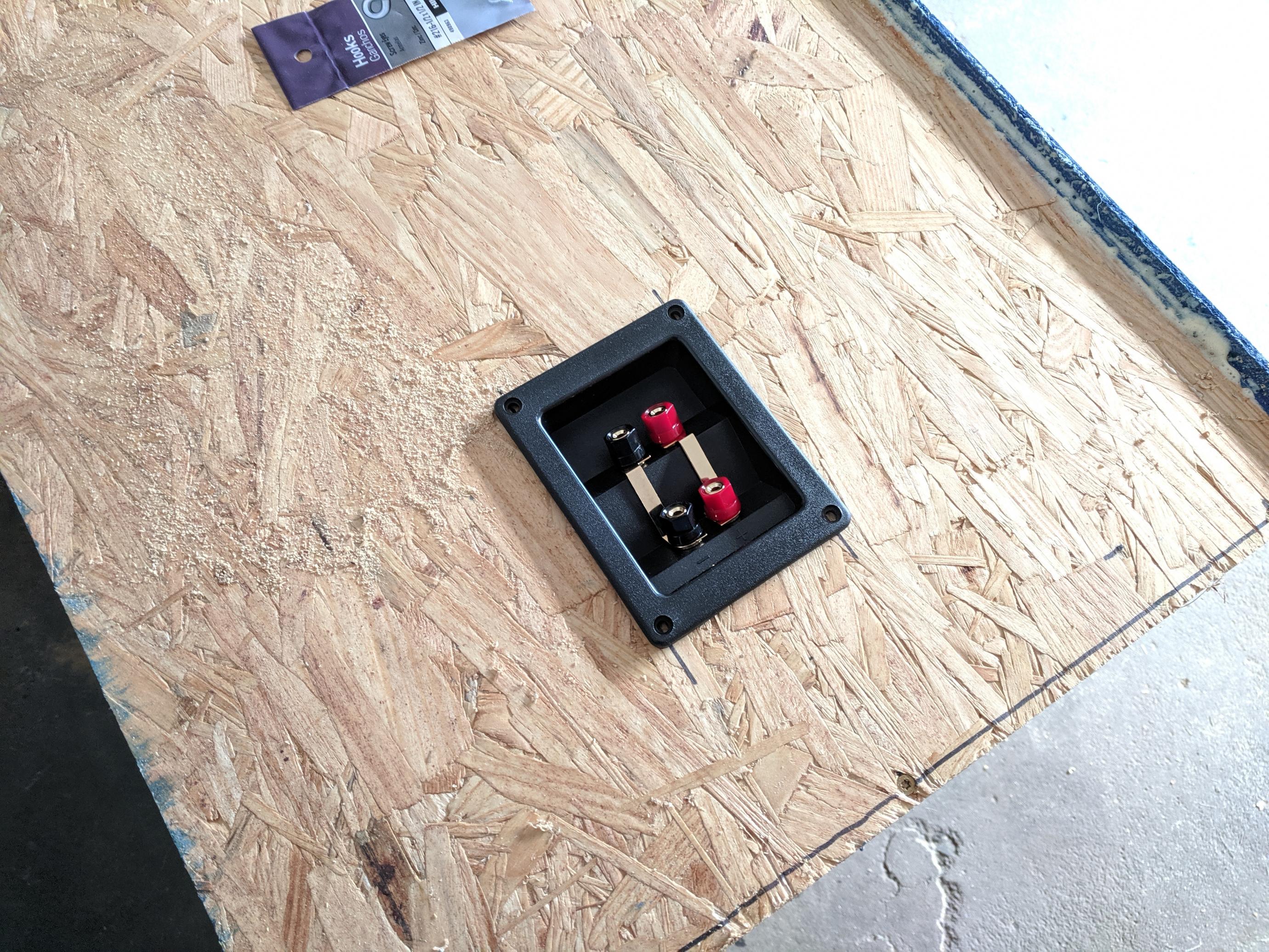

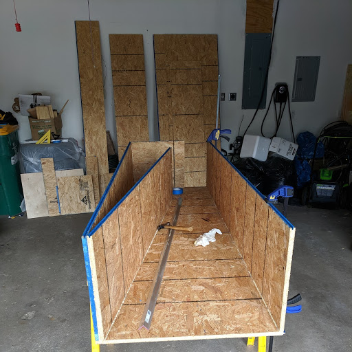

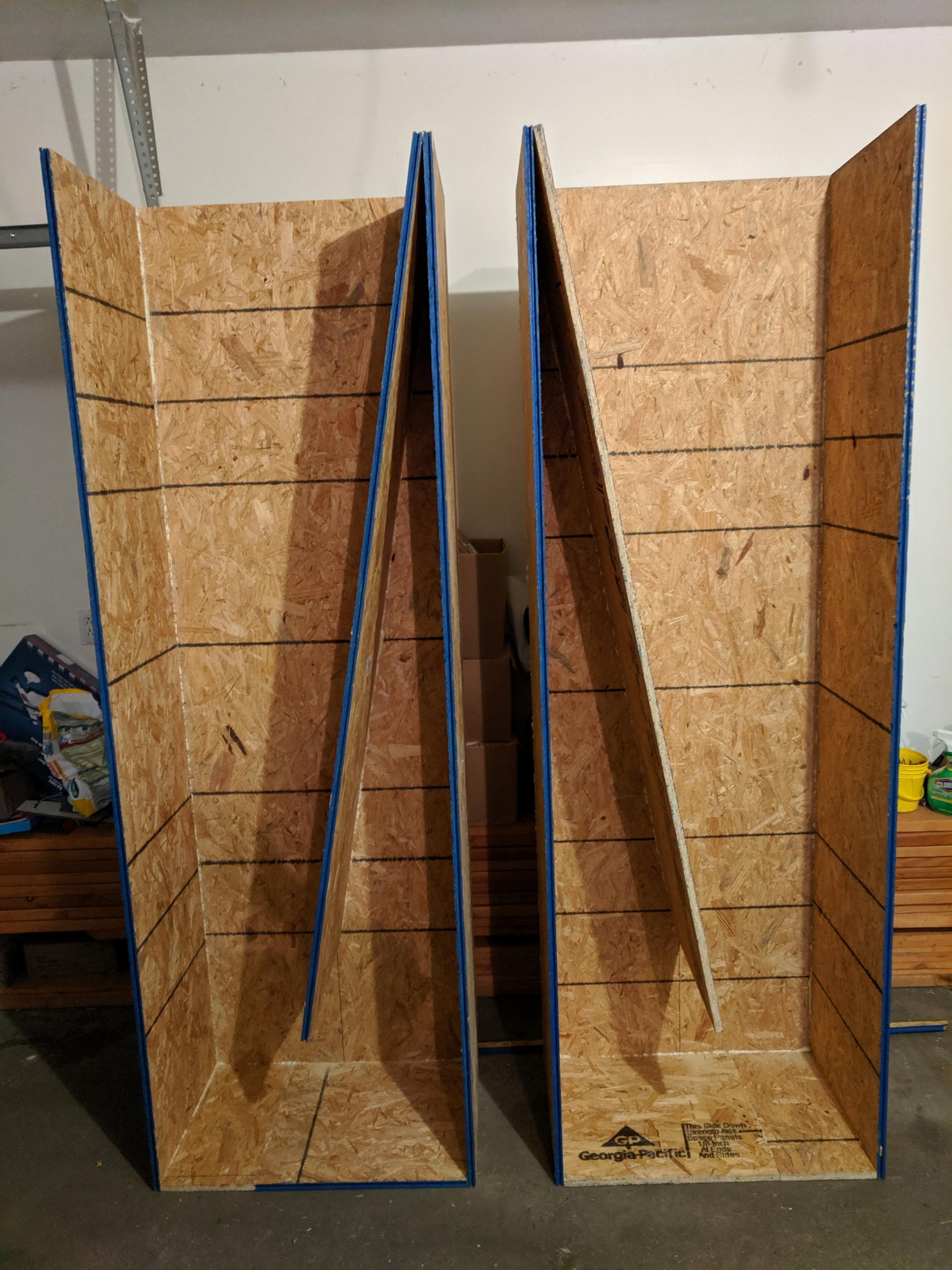

I'm building the BIB's out of OSB as test cabinets since 100 bucks of chipboard to test out a loudspeaker idea is a lot less expensive than five or six sheets of high quality plywood. This week I'm going to line parts of the enclosures with wool felt, stuff the peaks with acousta stuf, put a layer of it on the bottom as well and hopefully I'll be able to put the final sides on the cabinets next weekend. With the JBL 2220 midwoofers they should be right around 101db 1W/1M! Think they'll make bass?
Assuming the OSB doesn't buckle! 😉

Yeah, my buddy that helped me build the enclosures this weekend insists that he's sure the cabinets don't need any additional bracing. I told him I'd like to put in some just in case.
Well, if you're building the sim I did, 18 W in stereo up against a decently massive wall sims > 125 dB from ~27 Hz, so if just an inside wall they may not load well down low, but mid-bass will be loud live concert level. Just the thing for hard rock, heavy metal, etc..
This is pretty decent pressure, so definitely need divider board cross bracing over ~70% of its axial length beginning at the throat and mouth ideally and with driver bracing.

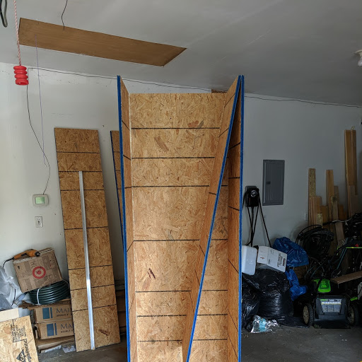

Glorious size!
Thanks! When they were laid down on the saw horses I didn't really get a sense of how big they were until I stood them up on end. I have a picture of a couple of friends of mine standing inside them with room to spare!
