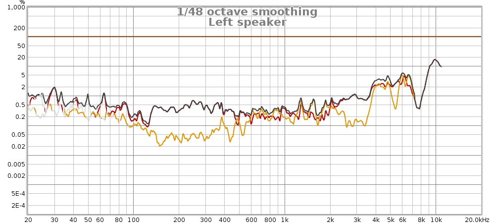

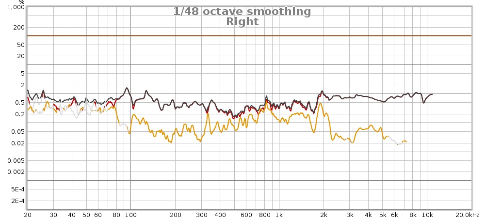

I feel a bit stupid - I heard some problem on the left side and measured the right speaker...and it was a bit strange to me that I could hear the small difference in distortion shown in the measurements. So I turned on some music and there was clearly a problem in the left side, the right seemed OK. I could hear it even from the amp hiss that there is a difference. Then I measured the left speaker a while ago...and the results are below.
I still do not know what the cause is, I will take it apart when the kids go to bed, but I would guess a broken diaphragm. These were most probably the original ones and therefore very old and one just gave up.

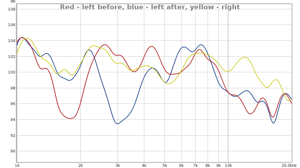

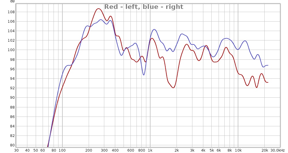

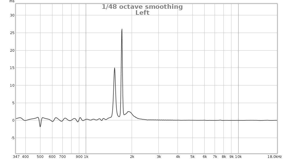

So the HF driver was reversed compared to the right box - but it was connected correctly per the service manual info. So the HF driver wired IN phase shows no dip compared to the text book out of phase connection. The IRs now look similar on both sides. The PTC and resistor were taken off in both boxes and were replaced by a glass fuse.

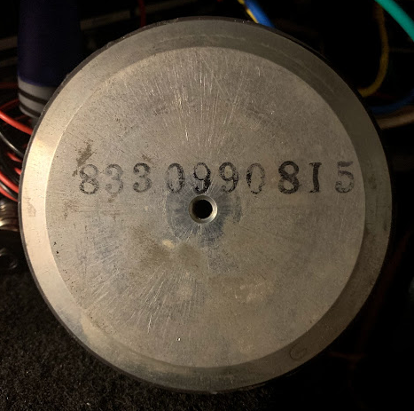

I took the suspected driver apart and tried to clean the air gap a bit and then return the diaphragm back. When I did that, I noticed that the plastic front of the driver is slightly cracked - I will try to glue that tomorrow - dould that be the cause?
There is a hole in the back of the driver, in the right speaker, there was a sticker over it so I put it on the left driver as well. This most probably had zero influence, the hole is not through if I can tell. The left diaphragm looked OK with a small dent in the center. Maybe another cause? It did not look like a hole though. The reassembly seemed to improve the distortion a bit, but it is still worse than the other one.
Still the HF is falling on the left driver and there is another dip at 3 kHz (maybe due to room placement). I am not sure if cheap replacement diaphragms would improve the situation
Once I fix that crack and maybe get the replacement diaphragms and if it does not improve the situation, what would be a recommended modern screw on driver replacement?

That's weird! The rest of the wiring the same?
The hole is mostly likely for manufacturing and/or assembly purposes.
Dents in compression driver diaphragms can affect the dome's pistonic response up high and if it has a loading cap the dent can 'tap'/'bounce' off it as the gap is 'feeler gauge' thin.
Neither speaker appears to be performing up to par, so measure the woofers, double check/clean everything and hope new diaphragms brings it all together. Do the horns seal well? No stress cracks?
Other than piezo horn screw ons, have zero performance knowledge of what's available other than what's published.

All looks identical, today I will try to swap the backplates. I replaced both drivers with D.A.S. M-50s - they will need some equalization on the high end to match the performance of the EV DH3 in the high end (above 10 kHz). The funny thing is that the left box still sounds a bit more "dull" even with different drivers - although much more balanced and without distortion. I measured the caps and they seem to be within tolerance. I think it also will not hurt to replace all the wires inside. The capacitors are foil type both and it looks that maybe one of them was already replaced (the 2 uF for a square boxed 2u2). Would it make any sense to replace the caps as well?
There are some cracks on the back side of the right horn - but these should not matter as there is also a hole that served for filling the plastic with foam. But as I wrote, there is a crack in the plastic part of the driver - and it looks like there could be some air leak, I will try to glue and seal it. The FR can be compared only to other speakers measured in the same position - I am almost sure that some parts are room/placement related.
