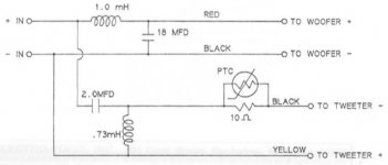

Attached is the crossover diagram. The 18 uF cap is an elyt, that one will need replacement. And the PTC will be replaced by a fixed resistor or maybe an adjustable L-pad if I can get some locally.

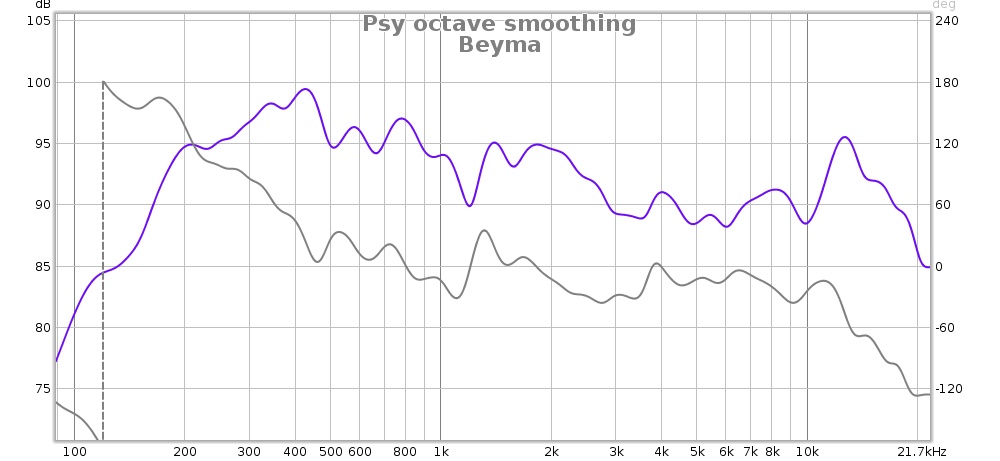

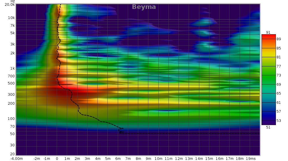

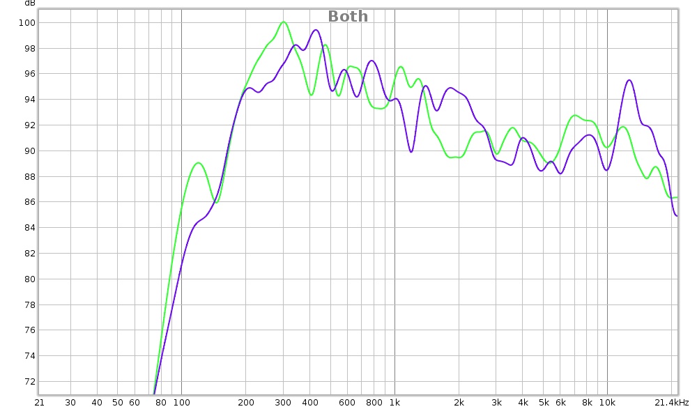

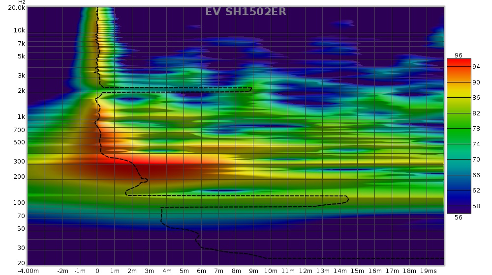

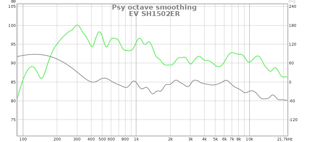

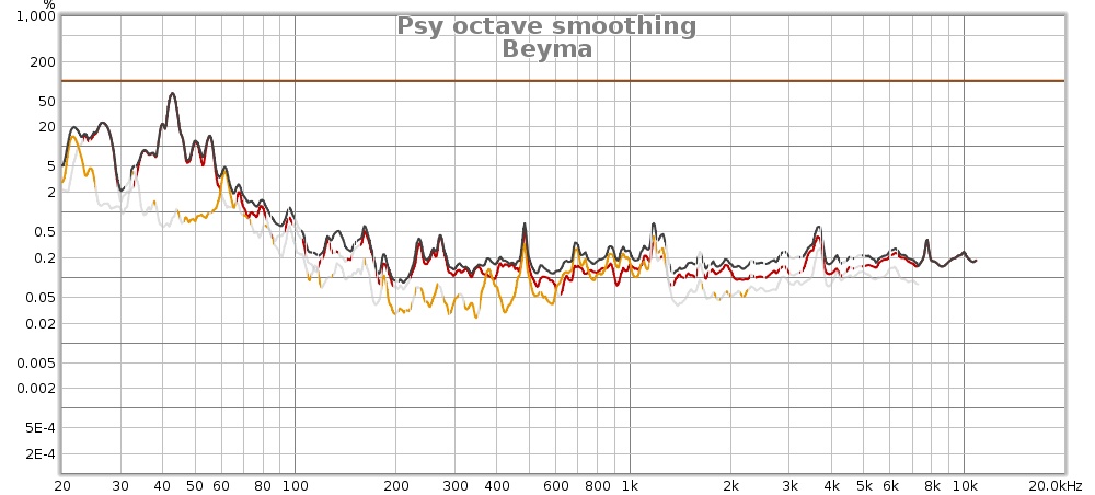

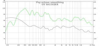

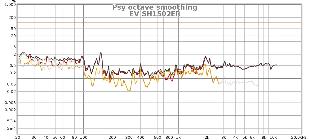

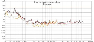

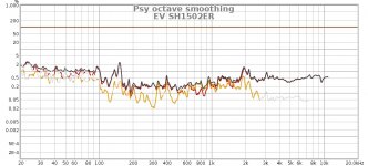

I did some measurements and provide a comparison with a Beyma 12XA30 measured at the same spot of the room. I used psychoacoustic smoothing to show the trends.
The funny thing is, the FR is kind of similar and that was also the impression. But with the EVs, I had a feeling I could hear distortion and the sound was not as crystal clear as with the Beymas. The measurements are at similar SPL. I would be grateful for any comments, but it seems either the Beyma HF driver is exceptionally clean, or there is some problem with the EVs. The Beyma is almost only 2nd harmonic, but the EV shows relatively high 3rd harmonic. So maybe that is what I hear? It is a shame, because the big boxes sound big, but I cannot tolerate the distortion. I hope this could be fixed with new membranes, crossover or whatever...or maybe a new driver would work? Would there be one recommended?
It’s hard to tell without taking each driver out and testing them individually. Distortion could come from many things... first make sure the drivers themselves don’t have issues. If they don’t then it can be the crossovers (capacitors, tweeter protection circuit, leak in the driver-to-horn seal, etc... regarding Beyma, I have the highest respect for that brand, one shouldn’t dismiss that modern Beyma products might just be lower distortion...
Hi Rolox
I don't quite get what you want to tell us with that. Do you want to say that they should be better in terms of distortion or that newer Beyma drivers would be better than the 12XA30 ? Or that newer Beyma drivers would be better than old EV ?
Regards
Charles
These will never be pushed hard. It will just be removed.
phase_accurate: I think he meant that the 12XA30 is just plain better than the drivers in the EV box. While that might be true, I simply do not trust that the distortion I hear would be there if the drivers and boxes as whole would be in 100% shape. More investigation will follow.
