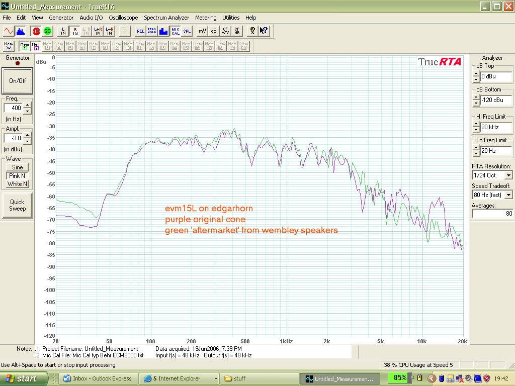

You have created a 15b.One has been re-coned with a non ribbed cone. They measure very similar in the horns.
Rob.
Doesnt seem like it matters in horns though.

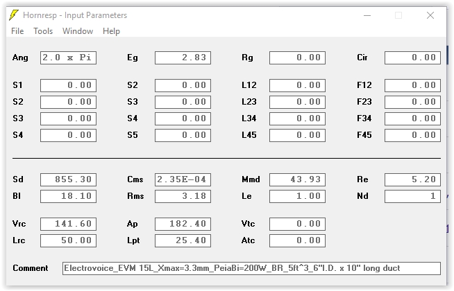

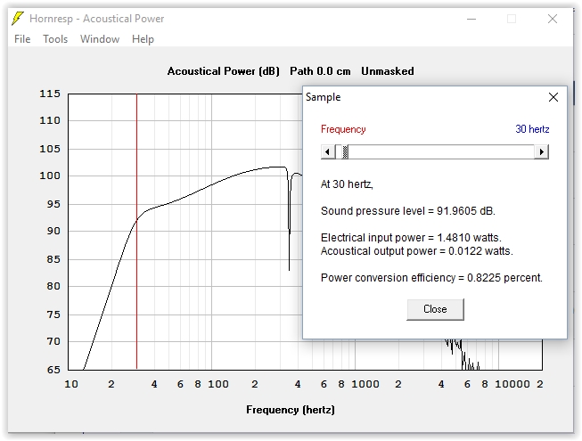

In the low end the EVM15L-II worked better in ported models than in real life and I wouldn’t be surprised to see similar behaviour in other types of enclosures.So you say that even if I build bjornos enclosure it will drop like a rock below 70 hz?
With a relative high BL, low Mass, low Qts and a very high EBP, it has a steep roll-off. You can mimic a higher Qts by adding a power resistor in series with the woofer. It will lower the sensitivity while frequency increases, resulting in a more gentle roll-off (more 'flat' response).

Rob, thanks for posting. I simmed both the L and B and they appear identical too. That said, I am willing to bet Art's comments are related to performance at war volumes and under driver Fs. I am quite happy with my 15B's in my horns (70hz) but they are parked in the house. Almost all well known 15s easily sim 6db+ over the 15B in my studies. That said, very few drivers have extended HF response like the 15B does if you have a 2way setup. They are great at what they do but they are not a sub driver.
